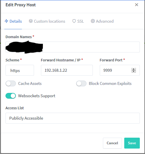

2 hours ago, InfInIty said:
Here are screen shots of my config
Here is the error when trying to access the page.
The 502 error usually indicate that NPM cannot reach your app.  Can you manually access https://192.168.1.22:9999 ?
