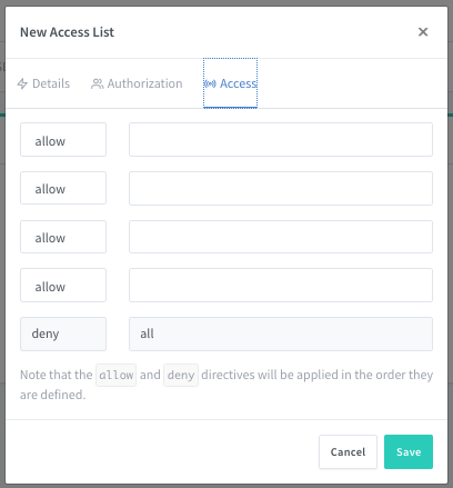

22 hours ago, shwa87 said:
After running this for a good long while now, I started out having the same issue that many folks are posting about - Internal Server Error when trying to add a new proxy host and request a new SSL Cert.  However, I deleted and recreated the docker and it's appdata and now that part works.
However - the Access List functionality doesn't seem to be working - instead of prompting to enter a username / password, instead it just goes 403 forbidden.  If I disable the access list on a host and change to publicly accessible it works.
I don't show anything in the logs of the container - is there another place I can look to see why its just tossing me right to a 403 instead of prompting for credentials like it always had?  Note that I am using Brave primarily for my browser, but the same thing occurs in Firefox, Chrome, Edge, and Safari.
Thank You!

Try to upgrade to the latest image and do the following:
  • In your access list, make sure Satisfy Any is selected if you have set nothing under the Access tab.
  • In your proxy, remove usage of the access list and save.
  • Finally, re-enable usage of your access list in the proxy host and save.

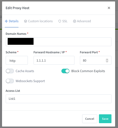

I have a static site that I can access through NPM perfectly, however I believe NPM has Access/Authentication capabilities built in correct?
My understanding was I create an Access List, under Authorization I add the User/Pass that I want users to use, then block everything else.
Assign that Access List to the Proxy and NPM would prompt for a login before displaying the page.
However this doesn't seem to work? Is anyone able to explain how the Access List works? I can't seem to find a guide on it anywhere.
1574086125_ScreenShot2020-08-05at11_16_11am.png.386aa4dafddff1435ecd205d74677efc.png 514535869_ScreenShot2020-08-05at11_16_21am.png.e022724c2f3a8a1225a24d7818056eaa.png 147499903_ScreenShot2020-08-05at11_16_28am.png.fc5c87399dbb0dd67c87d03f644cbcb1.png
Try to enable "Satisfy Any" under the access list.  When not enabled, it means that content of both the "Authorization" and "Access" tabs must be satisfied to allow access.
Hmm still no luck, it never prompts for a login and just loads the page.
Should I be updating the Access section in the Access List with anything?
You may have encountered a glitch: Try to remove usage of any access list in your proxy host, then save.  After that, re-assign your access list and save.
The Access section is not required if you don't need it.
Thanks for the guidance Djoss, unfortunately still not luck. Tried removing and re-assigning, also tried just starting from scratch.
I took a recording of what I am doing, it's all relatively simple so not sure what is going on.
  • Create New Access List
  • Create New Proxy, assign Access List
  • Go to Proxy and it loads without any prompt
