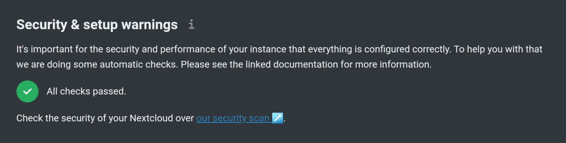

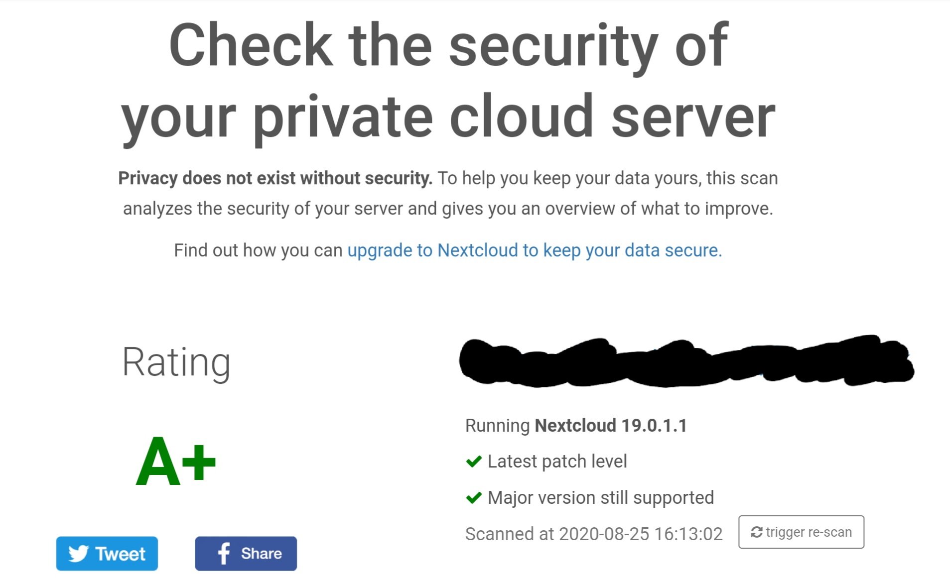

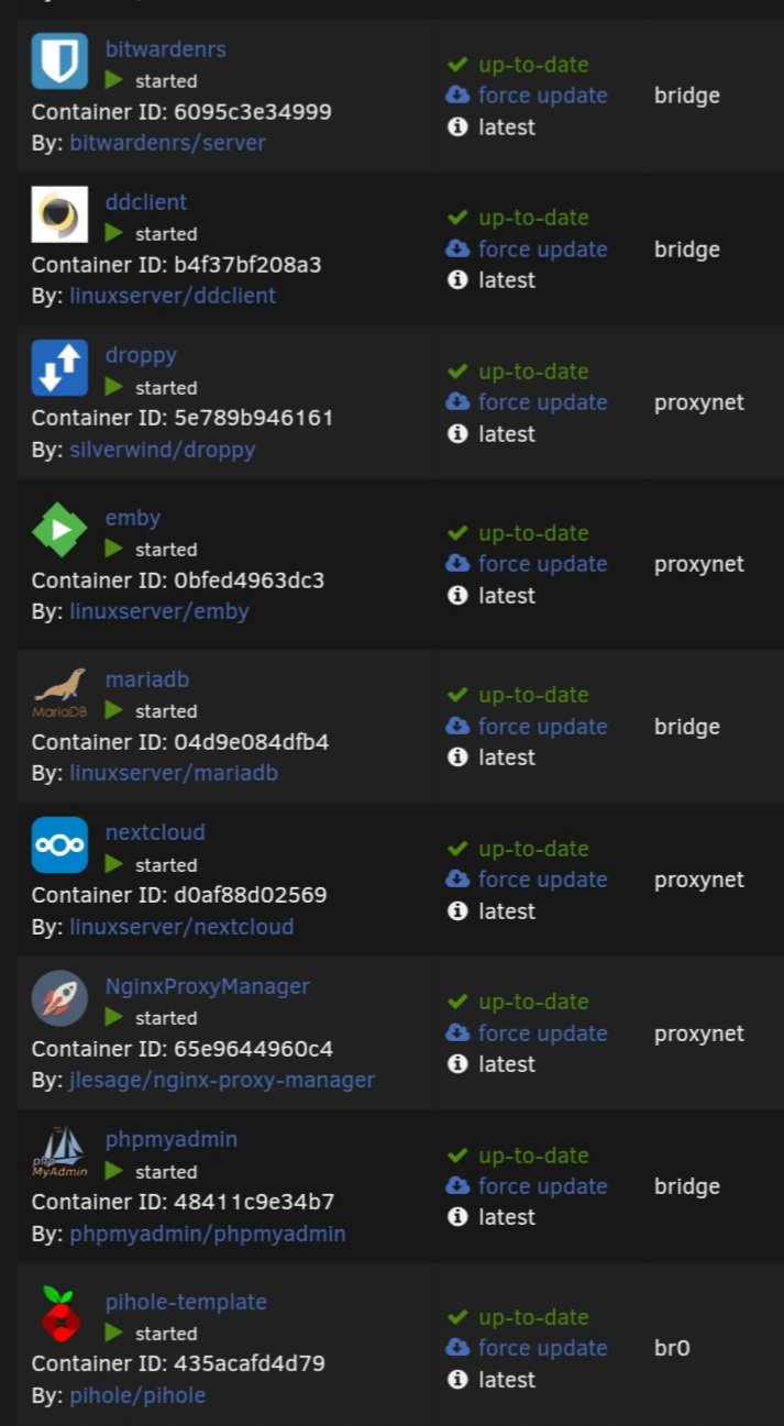

Just wanted to stop by and say thanks to @Djoss for this container, I've found it much easier to use as my knowledgebase regarding Nginx is limited. I've managed to setup Bitwarden, Droppy, Radarr, Sonarr and NextCloud, and everything has worked great. I'm even getting a complete clean security bill of health in NextCloud which I never managed with Letsencrypt (however no disrespect to the Linuxserver guys, it will have been down to my lack of understanding).
For reference, the only things I had to do in order to transition from Letsencrypt/Swag to Nginx Proxy Manager were;
*Delete all prior certificates generated by Letsencrypt,
*I haven't had any issues having NPM on its own network rather than Bridge,
*Disable Cloudflare proxy protection for each of my subdomains, and
*Add my NextCloud domain to the nextcloud config file, under "trusted domains".
Keep up the great work!

Hello,
I'm getting a few unexpected results. I left all settings default when installing the Docker, other than changing the network from a bridge on the host to br02 so it can have its own address.
Why does Docker show that the mapped resources, specifically the ports it is using, do not match what are in the docker settings?
Also, I think I have an outdated version of the application, though that could be an issue with the Docker image.
Do I have an issue, or am I just missing something that should be obvious?
Screenshots attached.
the custom br2 network here is like a host network, it wont map ports, it ll use the native ports from the app(s), so its all correct.
