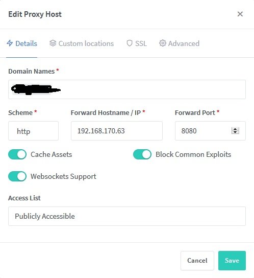

ok the first problem.. i easaly cann access http://192.168.170.63:8080/ut3/1.jpg   but i cannot access it throug NPM via xx.xxx.de/ut3/1.jpg
nee SSL needed
Which error are you getting exactly ?  Are you accessing your site locally or remotely ?
Which error are you getting exactly ? -> 502 Bad Gateway
Are you accessing your site locally or remotely ? localy it works, and remote over proxy it dosnt. (192.168.170.63 is a normal nginx webserver)
For some reason NPM is not able to access 170.63.  Is NPM using the default bridge network ?   What about 170.63 ?
NPM is 170.55    its on the same bridge / network  btw... NPM is Host (170.55) and 170.63 wehre the webserver is, is br0

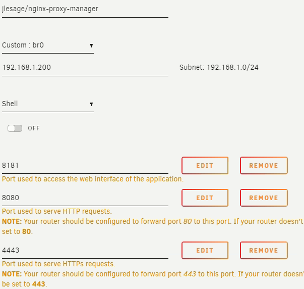

and i have another problem: no matter what i try i cant change nginx port 8080 in unraid
Edited by Gee1
So if I understand correctly, the “Network Type” is not set to “Bridge”, but to “Custom : br0”? If this is the case, you are correct in saying that port 8080 can’t be changed. Container’s ports can be mapped to something else only with a “Bridge” network type.
You can try to login to the container (docker exec -ti NginxProxyManager sh) and see if you can ping your other container from there.
ok i will test it - cool it works :D But i dont understand it.. the only reason i use custom br is that i can assign my own ip

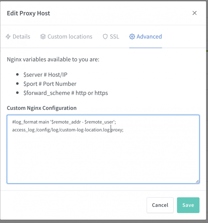

has anyone been successful to edit the log_format?
I wanted to customize my logs for better readability.
I’ve read the nginx documentation and added some lines to the Advanced tab in the edit proxy host window.
1129064318_Bildschirmfoto2020-11-14um16_45_11.thumb.png.7ee6e0833e24187cb3447e9fb6cc9ed7.png
while i’ve been able to write a log file to a custom location with the template called „proxy“, i haven’t been able to create a template called „main“.
The status indicator in the proxy hosts section in npm toggles from online to offline when i uncomment the log_format line.
Has anyone been able to create a logfile-template in the GUI or the CLI?

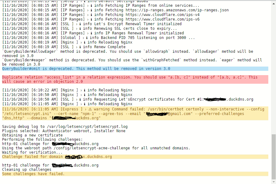

Fresh install of NPM and I tried to set up ssl on proxy and get the following errors.
Set up is as follows:
 I got SWAg setup and its says server ready at the bottom of log.
 Thanks for any help you folks can offer.
The custom config you put there is inserted under the "server" context.  The "log_format" statement is not allowed to be defined there.
You could try to add "log_format" to /mnt/user/appdata/NginxProxyManager/nginx/http.conf.  However, I'm not sure if it will work well since the log format is already defined somewhere else.
Look at /mnt/user/appdata/NginxProxyManager/log/letsencrypt/letsencrypt.log for more details about the challenge failure.  Probably that NginxProxyManager is not reachable from the Internet ?

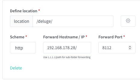

Has anyone been succesfull in adding Deluge (binhex-delugevpn) to NPM?
I have all dockers working except this one. It's setup the same as the others.
I get the following:
No Such Resource
No such child resource.
Adding the slashes / behind location and port gives me a blank page. But I can see on the tabname Deluge WebUI.
Edited by Ericsson
Screenshot

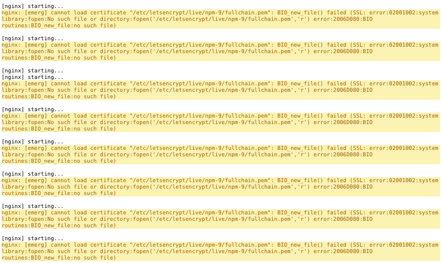

can somebody help me with error, I can't open NginxProxyManager.
How can solve this?
Best regards
Mladen
How can solve this?
Best regards
Mladen
Can you confirm your SSL settings? It seems it is trying to load a certificate that either does not exist on the filesystem or there is no permission. You can also check the filesystem yourself to make sure this file exists.

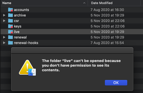

I was check, file is exists, but I can't access.
How solve this ?1374204736_Screenshot2020-11-18at13_04_05.png.6c76704a6b2cdd9b898641ef9e53fd59.png
Edited by Rejserr
You could try logging in with ssh as root and then access the file.
Or from the webinterface go to SSL Certificates and then renew it to see if that fixes the problem.
I log with ssh as root. find folder and access, now I see what is the problem.
It's missing one cert, npm-9/fullchain.pem like in error report.
How can I create new certificates ? Pls give me some directions for nobie
If you go to yourip:8181/nginx/certificates you can 'renew' the certificate. This should generate a new one and store it to your disk. I'm not really sure if you can see what site "9" is so I guess the first one on that page? Or perhaps an error is already displayed there?

I can't open yourip:8181/nginx/certificates to renew 'certificate' .
I found what is missing certificate, it for my unraid server.
So, is it some another way to create new?
