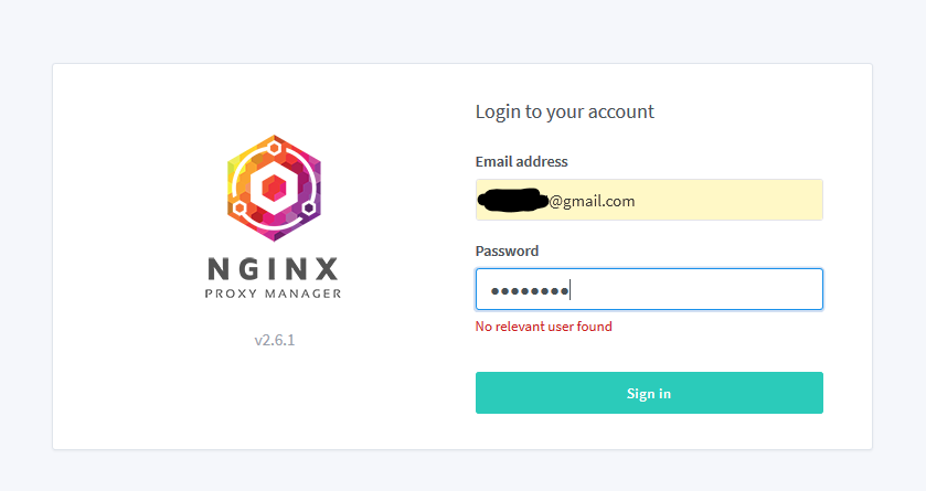

I was able to do the docker exec -it NginxProxyManager sh  command
When i type mysql I get sh: mysql: not found
When i run docker exec NginxProxyManager sqlite3 -cmd 'SELECT * from user;' /config/database.sqlite   i do see my login user email

Tried it without a password and with a password. Still says no relevant user found :(  I'm getting close to just blowing it away, but I would like to see if i can fix this so if it happens again in the future i don't have to redo it all.  The reverse proxies are still working at least.
The error you get is really because the email entered in the login page is not found in the database.  Do you see any spaces around the email address in the db ?  Did you try to manually type the email address in the login page (no copy/paste, no automatic filling)?

Yup.  So I use firefox and up until a week ago it was working. I'd double click and have it auto fill and it worked. I just put in a reverse proxy for AutoMute.
And now I've tried typing it in manually. Still no joy..   I did the same steps my QA would have me do at my dev job :)

I think I found the issue. It's the email I use..  I tried like [email protected] and many variants and I was able to login fine.. but once I use my email .. it says no relevant user.. I'll DM you the email I use as it's a personal one
I figured it out
My email has capital letters. Up until the last two releases, I was able to login as [email protected] for example.
But now I see that it turns it into [email protected]   so all lower case.
I reinstalled my appdata and used all lower case for the email and I was able to login..
Sorry about that!

Good catch.  I will try to find what changed and how this can be fixed.
Edited by Djoss
Nice one, I can understand that that is really confusing :)
(imo when checking an email adres casing should not matter, so strlower in the DB and strlower the user input and then check :) )
