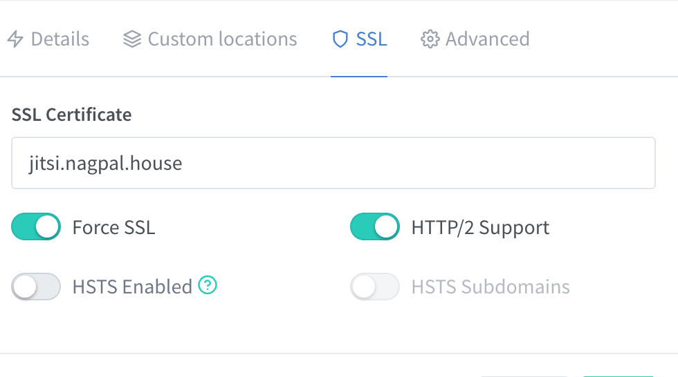

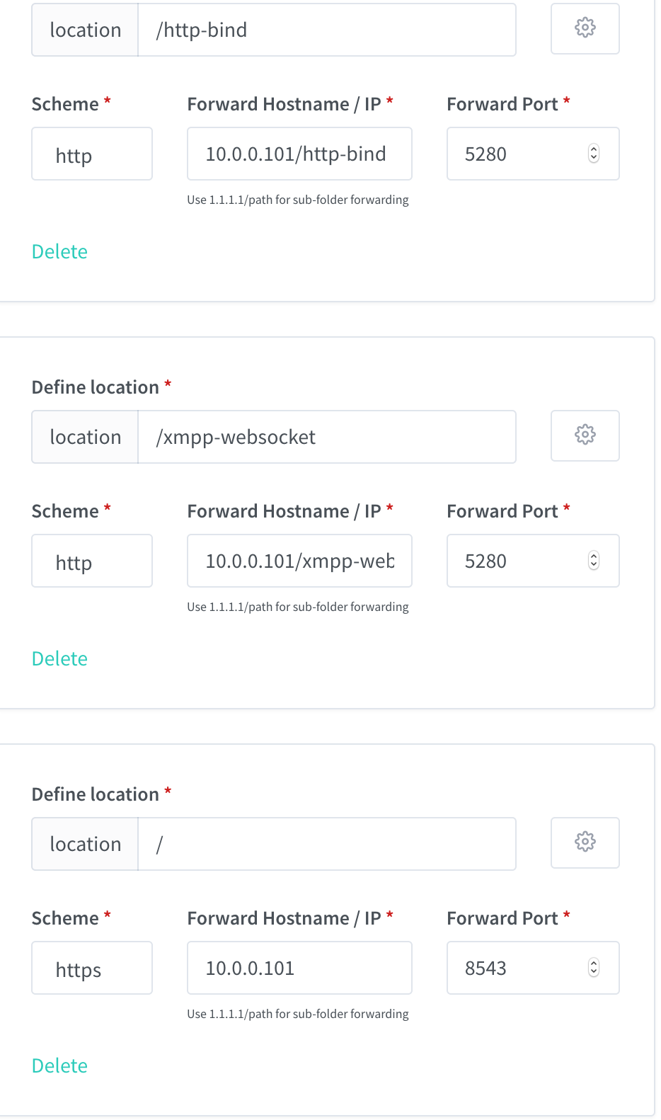

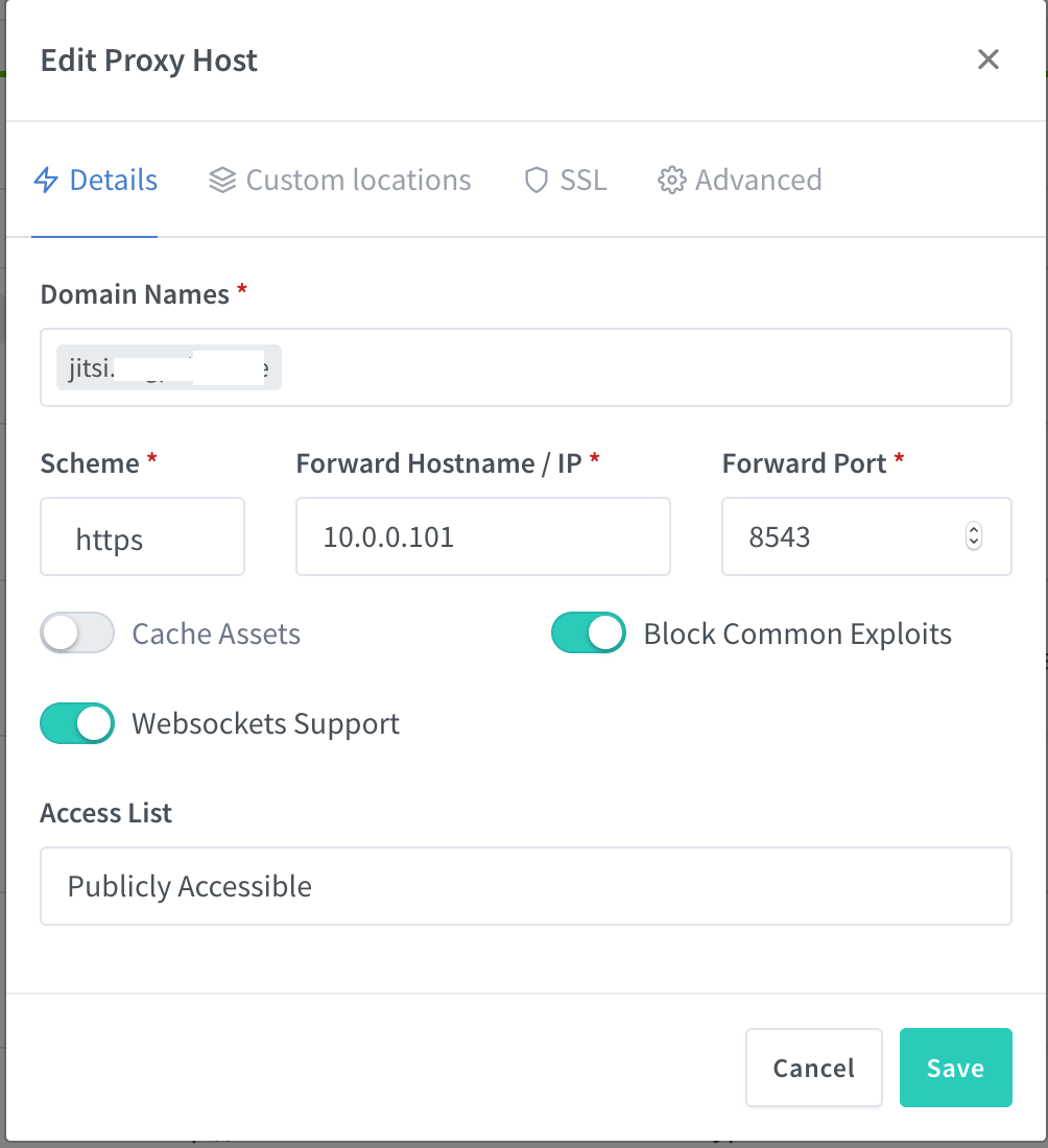

On 4/22/2020 at 8:46 PM, tknx said:
Anyone able to point to how to use this with Spaceinvaderone's recent jitsi guide? He uses nginx/LE with conf files and his sample nginx conf file is posted at the bottom here.
I am not sure how to point at containers the same way...
In proxy_pass settings, you can use IP address (of containers) instead of dns names.

15 hours ago, tknx said:
So this?
1331964604_ScreenShot2020-04-25at08_39_00.png.d44e2d5bb75954bdee4413603242715b.png1331964604_ScreenShot2020-04-25at08_39_00.png.d44e2d5bb75954bdee4413603242715b.png583268941_ScreenShot2020-04-25at08_38_53.thumb.png.4479b3bfc1a0cf56f8a2a46327e4dee3.png1331964604_ScreenShot2020-04-25at08_39_00.png.d44e2d5bb75954bdee4413603242715b.png
You can look at the generated config file in the appdata folder to see if it looks like the example you provided earlier.
