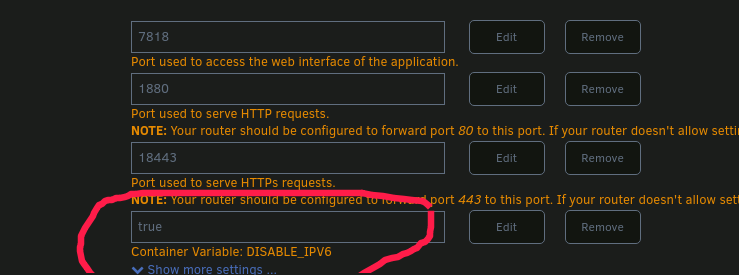

nginx: [emerg] bind() to [::]:80 failed (13: Permission denied)
To work around this add a variable like below. Just use the latest image.
edit: https://nginxproxymanager.com/advanced-config/
Edited by ezra
Works perfectly!  Thank you.

i had the same error it seems when i was on version 1.7.1 or somthing i made a change to one of my proxys and that seems to have added extra data into my config file
listen 8080;
listen [::]:80;
this was causing the container not to work
i just did a notepad++ search in "NginxProxyManager\nginx\proxy_host" for "[::]:80" and it found it in 4.conf
after commenting the line out "#listen [::]:80;" the container then loaded with that host being unknown status then i just resaved and it corrected the file and add https
  listen 8080;
#listen [::]:80;
listen 4443 ssl http2;
#listen [::]:443;
with this change and adding "DISABLE_IPV6 true" i was able to get things working again
 listen 8080;
#listen [::]:80;
#listen [::]:443;
This was it. you fix fixed it for me. I found one of the config files as you did was missing info.  I am up and running now. thanks for the help. Everyone who contributed, thank you

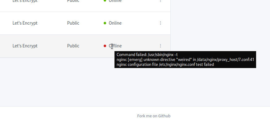

I can't seem to generate any new SSL certs. All my old ones are still working fine... but when I tried to proxy a new service today (and after doing several tests) I'm getting this error every time:
Command failed: /usr/sbin/nginx -t
nginx: [emerg] BIO_new_file(\"/etc/letsencrypt/live/npm-14/fullchain.pem\") failed (SSL: error:02001002:system library:fopen:No such file or
directory:fopen('/etc/letsencrypt/live/npm-14/fullchain.pem','r') error:2006D080:BIO routines:BIO_new_file:no such file)
nginx: configuration file /etc/nginx/nginx.conf test failed
It appears to be an access issue, like somehow the app lost the ability to save the cert files... I did recently run Docker Safe New Perms but that shouldn't have affected this container (right?).
Any ideas?
