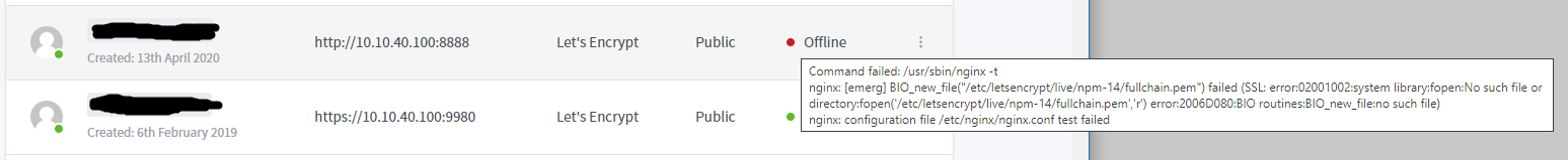

I can't seem to generate any new SSL certs. All my old ones are still working fine... but when I tried to proxy a new service today (and after doing several tests) I'm getting this error every time:
Command failed: /usr/sbin/nginx -t
nginx: [emerg] BIO_new_file(\"/etc/letsencrypt/live/npm-14/fullchain.pem\") failed (SSL: error:02001002:system library:fopen:No such file or
directory:fopen('/etc/letsencrypt/live/npm-14/fullchain.pem','r') error:2006D080:BIO routines:BIO_new_file:no such file)
nginx: configuration file /etc/nginx/nginx.conf test failed
It appears to be an access issue, like somehow the app lost the ability to save the cert files... I did recently run Docker Safe New Perms but that shouldn't have affected this container (right?).
Any ideas?

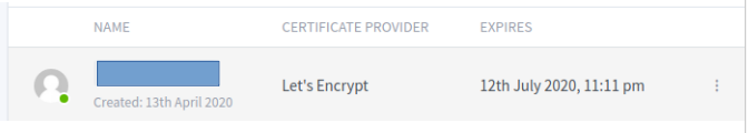

Not sure... I just made this one about an hour ago ago.  No issues.
Something you can try is either make sure you're up to date on the docker image or roll back to v1.7.0 and see if that fixes the issue.  I know, as I stated in my post above, there was an IPv6 situation that was causing some issues.

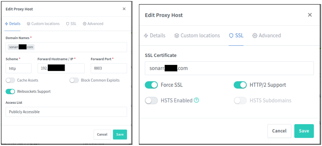

20 hours ago, tknx said:
I had this working before but had to redo some other networking and it all seems to have fallen apart.
1. I setup a proxy host, let's say bitwarden.mydomain.com
2. If I don't select a certificate, it works fine on http (except that bitwarden requires https).
3. If I request a certificate, I get an "Internal Error". I can close the window, edit it, and then select the certificate.
4. Then depending on settings I get either offline or invalid certificate.
Any thoughts on what is going on - I am using google domains dynamic DNS and have the ports forwarded appropriately.
This is the same behavior I'm getting in v2.2.2
Here's a screenshot of my error:
Edited by scud133b

36 minutes ago, scud133b said:
I tried downgrading to v1.7.0 and now I have another issue -- I can't actually load the Proxy Hosts page in the UI anymore. Click the link and nothing happens... the other pages work fine (Redirection Hosts, Streams, 404 Hosts). The browser address bar even updates to the correct address (http://server:port/nginx/proxy) but nothing on the page changes at all. So that's fun, doesn't seem related but maybe it is (?).
This is definitely browser related.  Had the same issue with using Brave verses Firefox.  Works perfectly fine in Firefox, but Brave does exactly what you stated.
When you said you had to change ports to address deconfliction issues, which ports did you have to change?
I'll try downgrading next, but here is my docker log with my domain and email taken out.
Can't open /etc/letsencrypt/live/npm-6/fullchain.pem for reading, No such file or directory
22563200637800:error:02001002:system library:fopen:No such file or directory:crypto/bio/bss_file.c:72:fopen('/etc/letsencrypt/live/npm-6/fullchain.pem','r')
22563200637800:error:2006D080:BIO routines:BIO_new_file:no such file:crypto/bio/bss_file.c:79:
unable to load certificate

Another data point: it appears the app never correctly saved the certificate for my new proxy host. The error refers to the folder /etc/letsencrypt/live/npm-14/.... and that isn't in the file system. I see the other folders for other proxy hosts (like npm-3, npm-5, etc.) but not npm-14.
So for some reason the new SSL cert and the associated files are not being saved in the appdata folder for any new hosts I try to create.

On 4/15/2020 at 8:47 AM, bwelsher said:
Hello all, I have NPM working well (in docker) with my own domain name and using duckdns as the dynamic DNS service. My subdomains (sonarr, radarr etc, also in docker) are set to use http but what settings do I need to change to use https? For example I change the radarr subdomain to https scheme and then request a new certificate which appears to work but if i then try to navigate to https://radarr.mydomain.co.uk I get 'ERR_CONNECTION_CLOSED' in Chrome. Do I need to change any other settings anywhere?
Here is how I have my sonarr (for example) setup.  BLUF, the scheme should be to point to your docker via http, then force the use of SSL cert using the "Force SSL" option.  The only docker I had to point to it via https was Plex.  Then I still used the force SSL option to my own subdomain name and SSL cert.  Hope the picture helps.
Thanks for the advice. I've changed the setting to http and 'force ssl' but i still get 'ERR_CONNECTION_CLOSED' unfortunately.
Check and see if you have SSL enabled in Sonarr... if so, disable it and try again.  Also, what browser are you using?
Hi, yes it was enabled but disabling it hasn't changed the result.
I am using chrome on android to try and access sonarr. My router doesn't support NAT loopback so I can't test the external address through the laptop.
