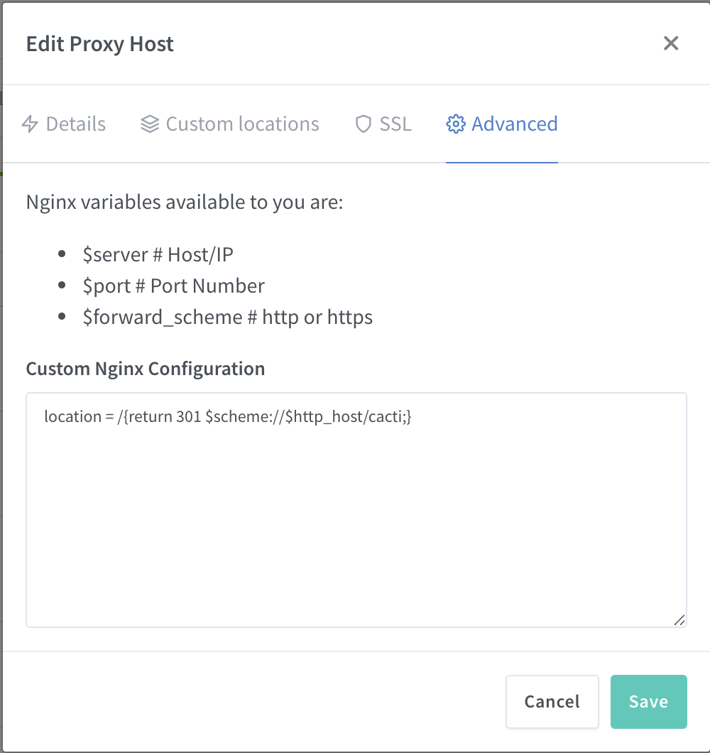

Im having trouble accessing my "cacti Docker" "through Nginx Proxy Manager"....
I have.  jc21/nginx-proxy-manager:2 Docker running the manager.....
I have. quantumobject/docker-cacti Docker running cacti......  The docker already have Apache2 running in it and since its not my docker i'm not tampering with it.
The question im asking is.....How can i get the Proxy manager to add the "/cacti"  to the end of the domain name?
Https://custom_domain.CO.UK/cacti..... if i manually add it i can access the web ui lovely.  All help would be appreciated.
Hi Again All, I figured it out ....
Under the Proxy settings for the site/server you want to forward.....
  • Click on edit of the desired proxy host,
  • Click on the Advance tab
  • In the box insert the following line  -      location = /{return 301 $scheme://$http_host/cacti;}      OR
                                                                    location = /{return 301 $scheme://$https_host/cacti;}
  • "Replace the part in red with your desired sub folder"
Example
if your server is "192.168.29.100:2020/cacti" if placed under the details tab as is you will end up with invalid and non loading URL, So for this to work place the following line above under the advance tab to get the following.
Http:// or Https://mydomain.co.uk/cacti
If Requested I can write a complete guide to this

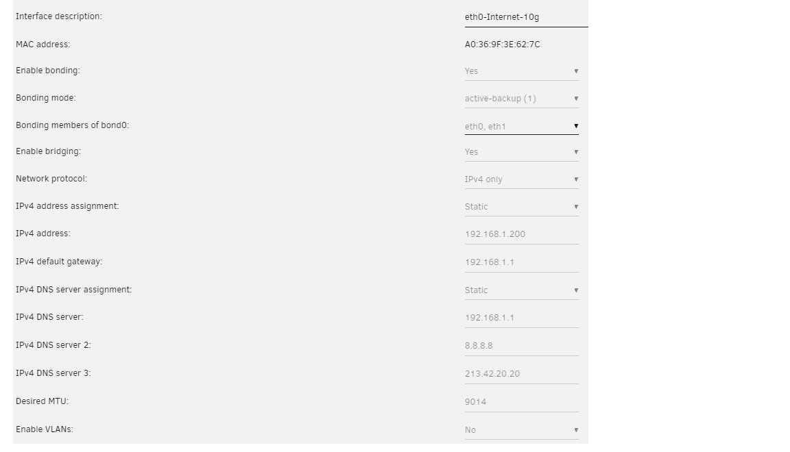

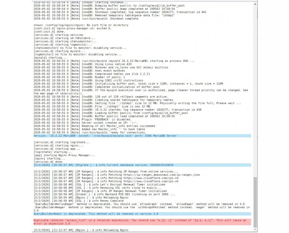

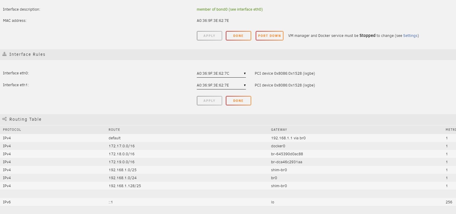

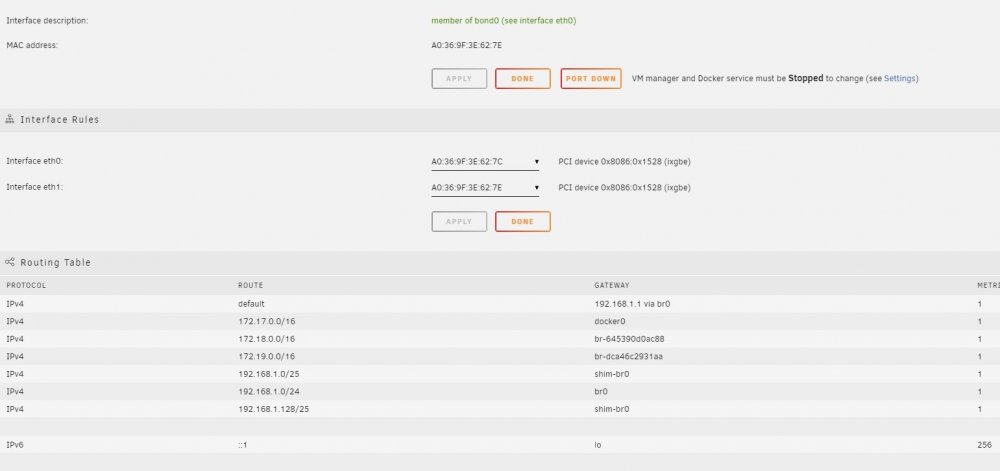

tower-diagnostics-20200502-2239.zipHi every one.
I am tired of trying to fix my problem. it is 3 days now trying everything and read all the related topics and proposals . nginx proxy manager was working fine. i dont know what i did that it effected this docker. anyway it starts when i found that one of my hosts are not reaching my spreedbox which is available inside my network and reachable by the unraid server by ping.
i failed on trying everything including removing it and re installing it. anyway i come to find that the site is accessible from  other machines and behind a vpn. but when try to access it from home specially from  my main machine it gives me time out.
i am attaching all my configuration with logs and server diagnosis folder. i will appreciate if one can tell me what i am doing wrong.
tower-diagnostics-20200502-2239.zipnginxmanager-log.thumb.jpg.440a98570f37f3705c9b38c63074ce61.jpg
Edited by m975261
crossover my domain name
Finally got jitsi to work. The setup guide from @SpaceInvaderOne didm not expose port 5280 on the xmpp docker. Once I mapped that, it seems to work better.
I am going to go hunt down the rest of the ports that probably need to be made available for full functionality.
You're saying that it works outside your network? I had a similar issue with a Linksys router, that had a feature that I of course can't remember what was, that specifically prevented something like nginx working from inside the network.
Outside it was fine. Maybe look at your router settings and try turning some stuff off?

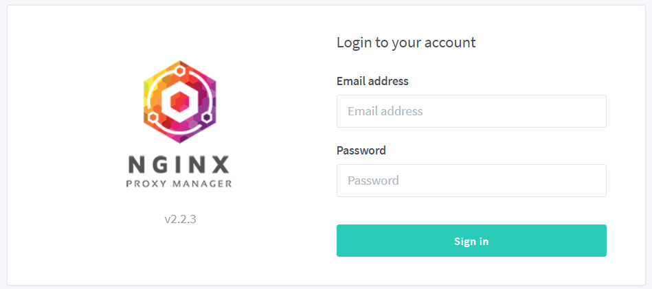

Everything has been smooth with this container forever.  Suddenly when I attempt to access the web UI, I am prompted for an email address and password.  I've never seen this before, and I can't seem to get past it.  Any help would be greatly appreciated.
EDIT:  I tried the default email address and password with no luck.  I ended up just trashing the container and files, and just starting over again.  Back up and running now.

Lol - i got same issue here; well not exactly
I installed thisdocker months ago so i could move my websites from bare-metal to unraid as vm's. Ready now to start using is. During setup email and passwords were asked tho during the setup (no clue why since no "lost password" functionality and everything runs locally). I was apparently stupid enough to not put them in my password manager...
Is there a way to reset this or to re-setup the docker ?
regards
Edited by sjoerd
Yes, well, the intent of the docker is to expose it to the internet to some degree, makes sense to me that it's password protected by default.
If you haven't actually made any setup, just remove it and re-install. If it persists with the data during this, you can always use Community Application Cleanup App Data to get a fresh start - or just specify a different app-data directory (config directory) during initial setup of the docker.
The config directory if you wanna poke around in console is @ /mnt/user/appdata/NginxProxyManager per default, I couldn't find anything to manually define a local user at a cursory glance.
Thank you -I managed to reset the password - I already found that page but I guess I need to go back to school since I lost the ability to read a page properly ;-)

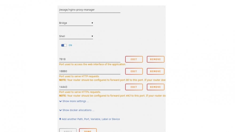

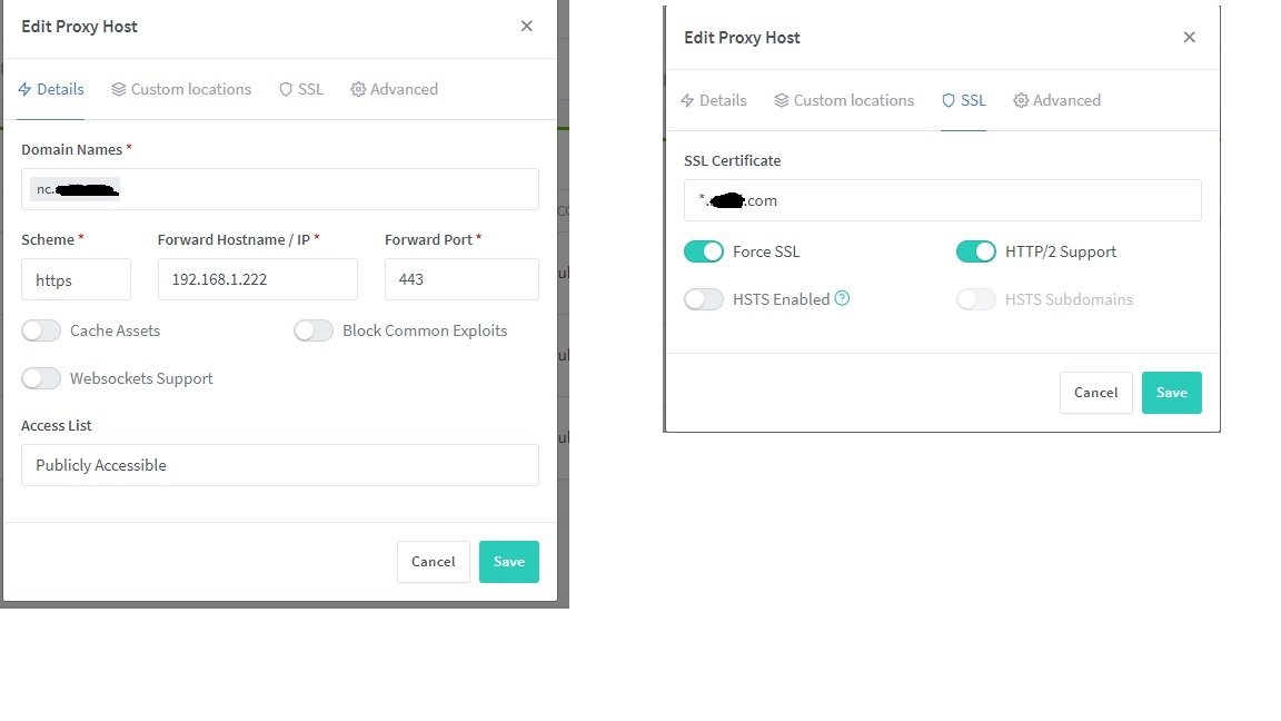

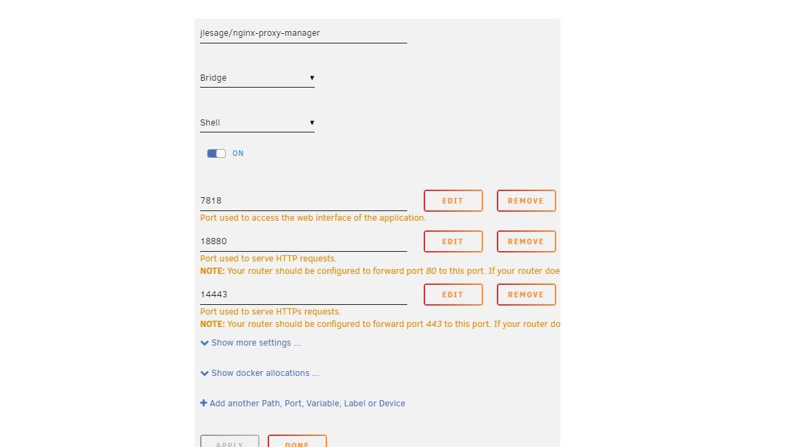

Ive read through this topic, and think i have everything set correctly.
When i have NPM set to Bridge, and forwarded ports 80>1880 & 443>18443 everthing works. I can access my docker via dns name.
But, when i set NPM to br0 and forward ports 4443>4443 & 8080>8080 to NPM IP, my dns name rerturns error - Site cant be reached
Is there something im missing in using br0?
Cheers
Adam
Edited by bdydrp
Cheers
Adam
It has been a while since I set it up, but I think it only functions correctly when used in bridge, otherwise it can't access what it needs. I went through the same issue, I'm pretty sure, actually.
Point being; I'm fairly sure it that it needs to be in bridge mode for it to be able to reach the addresses of other systems in bridge mode.
Not sure if creating an entirely separate network for nginx and web-facing services would work though.
Thanks - Have left it in bridge for now!
Tho, the other docker im accessing (jellyfin) has an IP assigned, and i can still access it
Cheers
Edited by bdydrp
