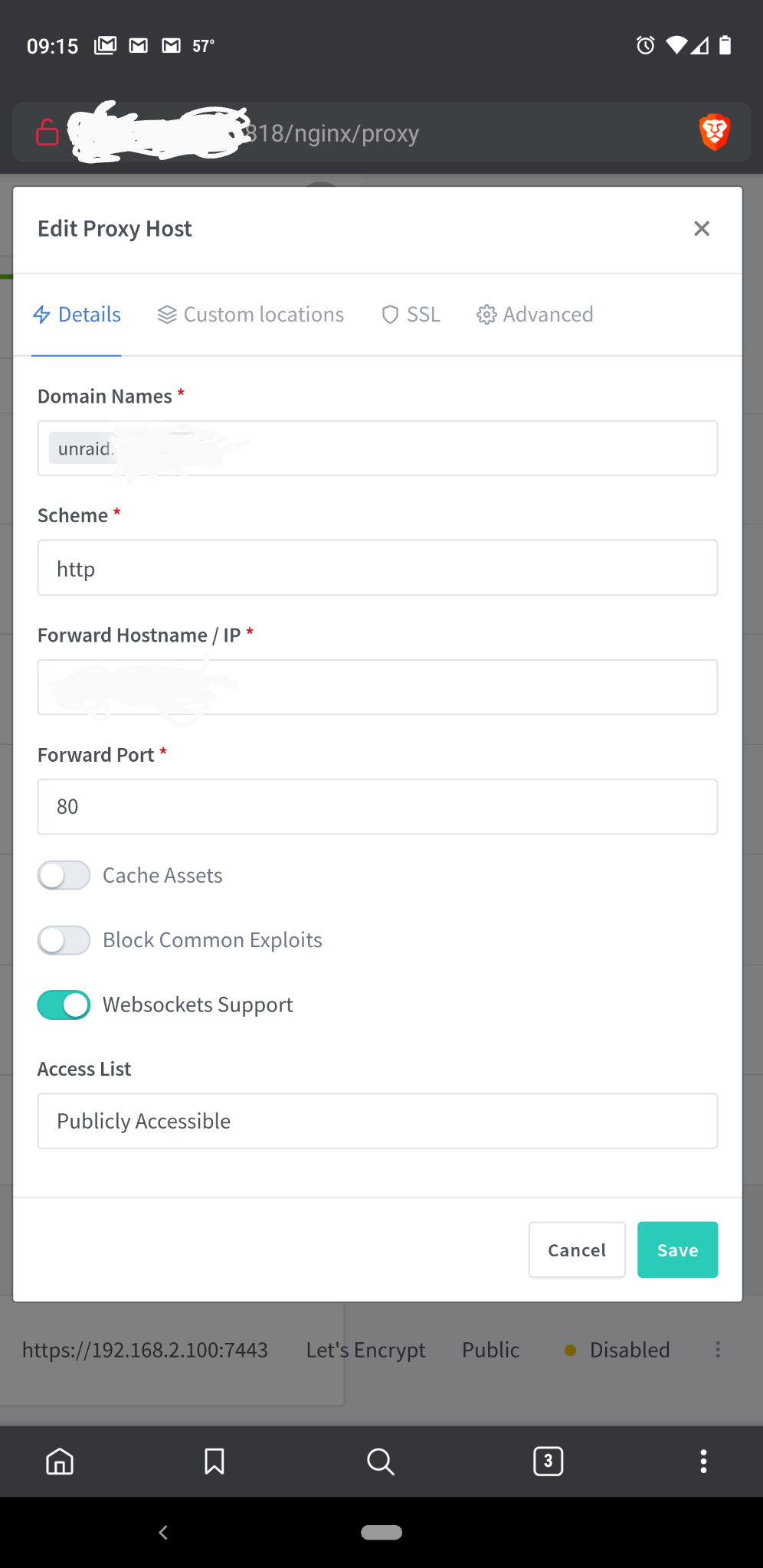

10 hours ago, lsymfr said:
I had the same problem and solved it by disabling cache assets and block common exploits.
Interesting as I don't have those options enabled. Screenshot_20200225-091526.thumb.png.d7b8b92ab09ea905f40f870bd5db140d.png

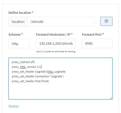

On 2/24/2020 at 2:18 AM, tknx said:
So I just started using this and it is so much easier to use. The only docker I can't get to work (and couldn't using the letsencrypt docker either) is shinobi. Always get a bad gateway no matter what I do. Any thoughts on how to diagnose what is going on?
The only difference is that shinobi is on my IOT vlan instead of main one.
Problem is probably shinobi doesn't have web paths set.
I host my shinobi on a seperate NAS, so should be the same:
This will make sure the websocket upgrade works, to get rid of your gateway issue that's a problem with shinobi itself.
In super:
http://192.168.1.200:9080/super
Under config:
   "webPaths": {
      "home": "/shinobi",
      "super": "/super",
      "admin": "/admin"
Add it to the end and make sure the previous line has a ",".  Save, then control and logs, and hit restart core.
