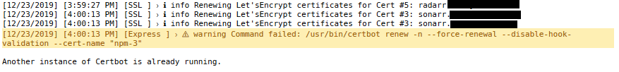

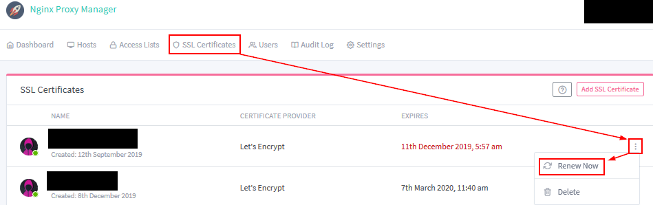

I am facing issues when attempting to manually renew certificates (SSL Certificates > Select 3 Dots on the Service > Renew Now).
It will then report a 'timeout' error and the Logs don't appear to show anything useful.
Any attempt to manually renew any certificate after this will immediately fail with an 'Internal Error' and logs state that Certbot is still running:
image.png.173ee216ca3f27bd752df306091205dc.png   image.png.2c6c0430b95d514e2c37eb1db70eaef7.png
Is this a known issue? Is there a way to update them manually outside of this function?

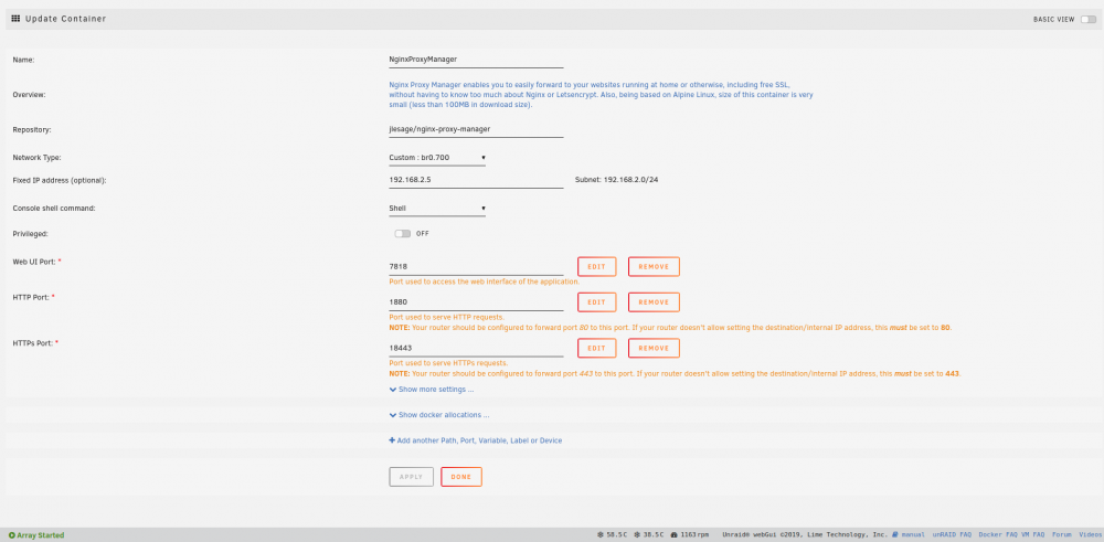

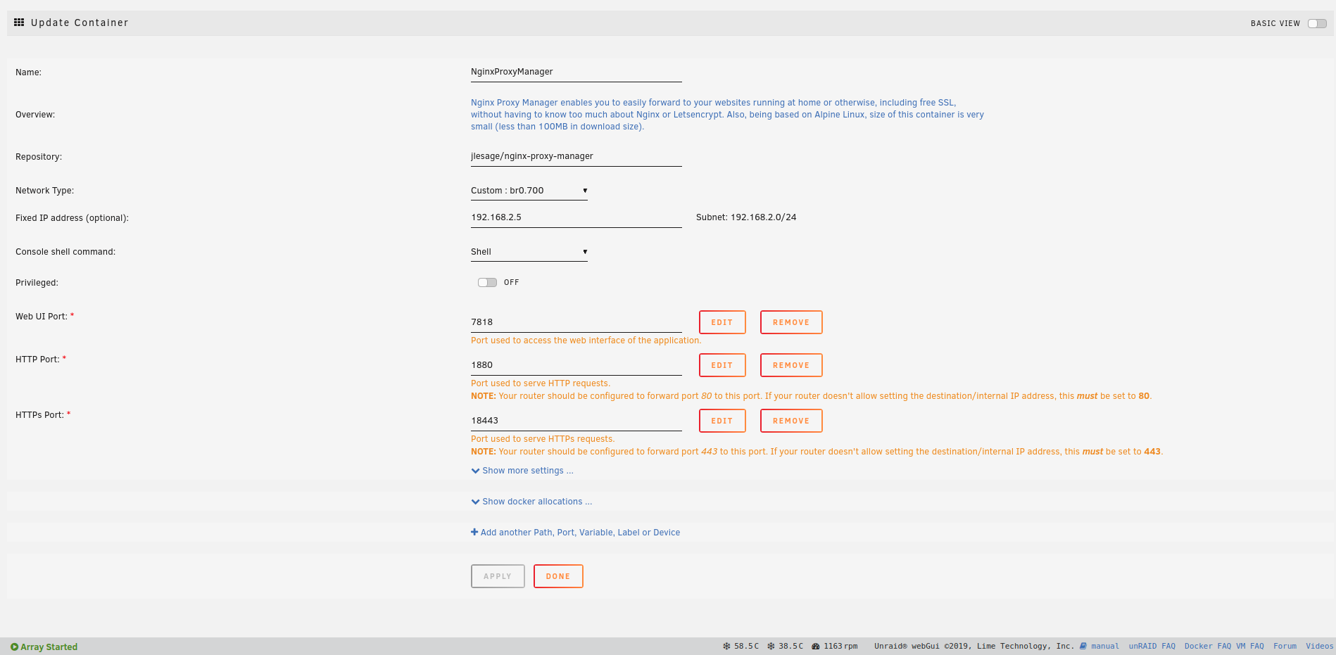

Hey, thanks for this app.
I cant reach the webui of this container. I've seen something rather odd.
Upon creation i see port 7818 for the webui and after i've started the container it said 8181 for the webui. Also the other ports don't add up.
Please advise.
Looks like the UI is not waiting enough long.  Did you check if the certificate has been eventually renewed after the timeout?

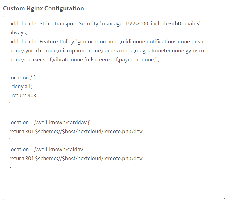

On 12/25/2019 at 7:37 AM, placix said:
Hey everybody,
I'm trying to do the configuration for my nextcloud. Everything works so far except on mobile devices...
I think some browser tests brought the cause:
https://xxx.yyy.zzz/nextcloud/ = everything works well
https://xxx.yyy.zzz/nextcloud (without tailing "/")  gets https://xxx.yyy.zzz:4443/nextcloud/
What can I do?
Best wishes,
placix
Since you are using a lot of custom config, I would double check the resulting, generated config...
Did you try to add a redirect from https://xxx.yyy.zzz/nextcloud to https://xxx.yyy.zzz/nextcloud/ ?
Please advise.
Since you are not using the "Bridge" network type, the UI should be reachable over port 8181.  In your case you probably need to use http://192.168.2.5:8181
Now it works with a redirect. Thank you 😊

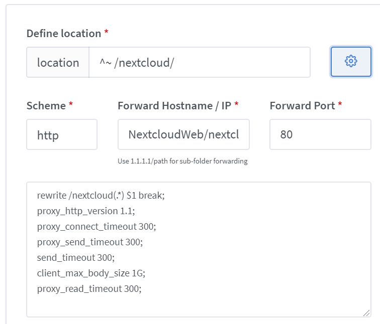

I was able to get this up and running for a few specific docker containers (Organizrv2, Shinobi, Ombi). I have 2 questions from here:
1. I am currently accessing them through organizrsubdomain.duckdns.org, ombisubdomain.duckdns.org, and shinobisubdomain.duckdns.org
Can i change that to be subdomain.duckdns.org/organizr, etc
I did not see a guide on that combing through the forum here
2. Is there a way to allow all my apps to run through Organizr, such that I can access organizr through the reverse proxy, then access all my individual pages through that? That way i only have the organizr page exposed to my firewall, and not other pages like sonarr, radarr, pihole, etc.
This is possible by adding a "Custom location" under your proxy host.
But note that this method is more complex and the application your are proxying may not support this scenario or may require additional configuration.

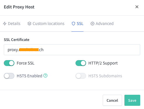

Hi. Thank you. Now everything is working with domains and subdomains over ssl.
But I can't access to the web UI over https. It just works over http. Is there a config where i can change this?
Greg
Greg
There is no config for this, but you can create a proxy host to access NginxProxyManager UI over HTTPs.

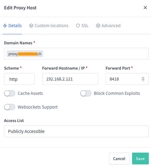

Made a proxyhost proxy.mydomain.com
It doesn´t work. Tried with Unraid IP 192.168.2.121:8418 and Docker IP 172.17.0.2:8181. No way.
All other subdomains on this unraid server runs perfect. But not the Nginx Proxy Manager
Made the following:
Get no connection to the app.
EDIT: made the same with nginx.mydomain.com and it works. Don´t no why but it works perfectly now. Thank you anyway ;-)
