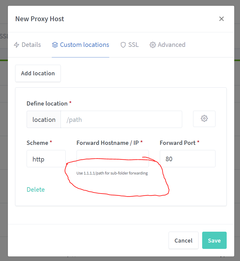

Hi all. I have an issue getting Zoneminder docker to work with Nginx. I have all
my other docker works flawlessly thank you for that.
the only difference I see with Zoneminder is that it requires /zm after the port in order to work. For example 10.01.1.32:8443/zm works
but 10.0.1.32:8443 won’t. When I set up the reverse proxy where can I tell it to add /zm to my subdomain.domain ?
This option?
