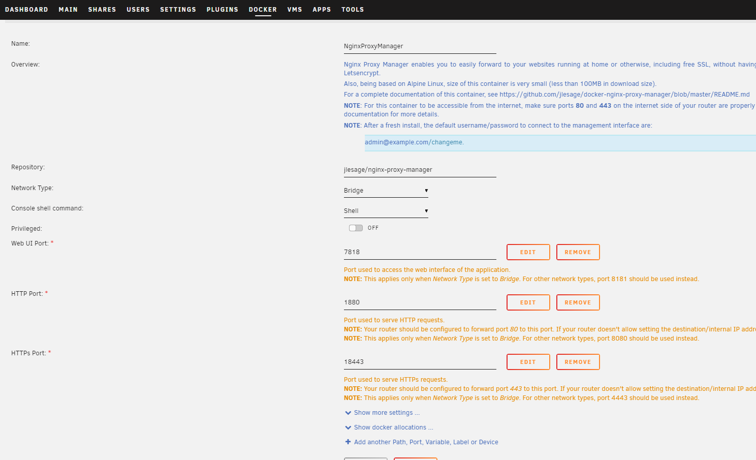

I ended up figuring it out last night.
NPM for some reason did not like ports 180 or 1443. After I switched those ports to 1880 and 18443 (and corrected the forwarded ports in my router) it started working correctly again.

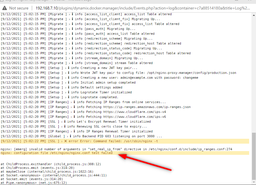

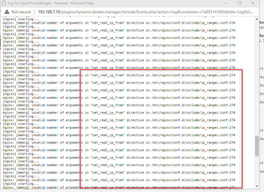

Hello After i install and check the log, i am having this error.  is this normal ? When i setup host, i have error saving them.
Edited by spacezmonkey
No that is not normal, it seems to be in a restart loop. Did you make any custom config? Perhaps a IP list with no entries or something not sure. You can check the config file listed to see what is wrong exactly.
Hello Mattie,
Thank you for your reply. I do not make changes to setting during install as shown in my attachment. and i wasn't able to find the ip_ranges.conf file in "  /etc/ngix/conf.d  " . i do not even have the "include" folder after conf.d.  Is there anything i have done wrong during the setup?
