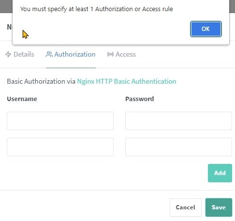

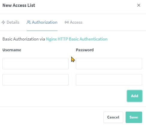

Hi, I have installed NGINX PM and it is working well except I want to create an access list but I am not able to add users to this new access list... As you can see in the prtscr the new user is blank after pressing the Add button. Any idea of the problem. Thanks.
Enter the new user then "Add"
Give this screen without any user...
And this if I try to save...
And what if you dont click on add? So enter the credentials then click save?
(or first click add n amount of times to get all the fields you need and then enter details)
I feel so dumb, it is too easy!
Thanks for your help.

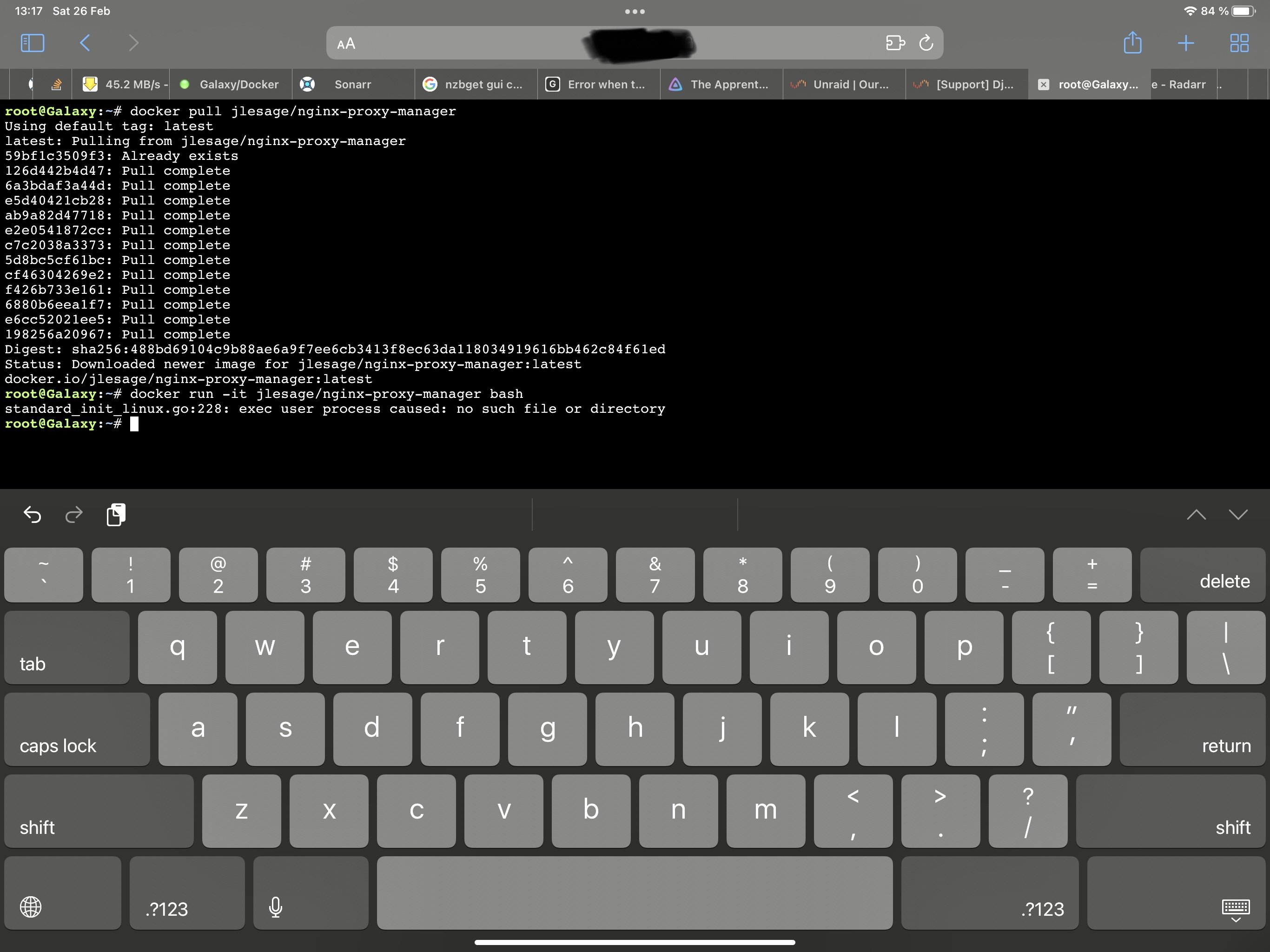

On 2/20/2022 at 8:40 AM, Profezor said:
Had to reinstall unraid and now NPM  it’s broken.
what do I need to do to get it working again? I really need this to work as you can image.
Thanks in advance.

Try something like:
docker pull jlesage/nginx-proxy-manager
docker run -it jlesage/nginx-proxy-manager bash
(and then in the container:)
cd /
./init
Than you have a 100% clean fresh image/copy with NO mounted directories (so anything you do in here is NOT saved). If this does not work there is something really wrong with your server (or you are using an 32-bit system while NPM is for 64-bit, or ARM or something).

1 hour ago, Profezor said:
What device do you use for your Unraid? It works fine here:
root@Tower:~# docker pull jlesage/nginx-proxy-manager
Using default tag: latest
latest: Pulling from jlesage/nginx-proxy-manager
Digest: sha256:488bd69104c9b88ae6a9f7ee6cb3413f8ec63da118034919616bb462c84f61ed
Status: Image is up to date for jlesage/nginx-proxy-manager:latest
docker.io/jlesage/nginx-proxy-manager:latest
root@Tower:~# docker run -it jlesage/nginx-proxy-manager bash
bash-5.1#
I know that trying to run a x64 image for example on ARM does not work. But yeah I don't know....

Running on a standard intel chip. The system worked perfectly for a year. Now as I have started from scratch I get  this.
Yeah I don't know. Any problems with other docker containers? Perhaps remove your entire docker.img?
The commands I posted should work (and do work on my Unraid, Windows desktop and Linux desktop). So there must be something with your setup.
You could also try some basic containers like alpine or something.

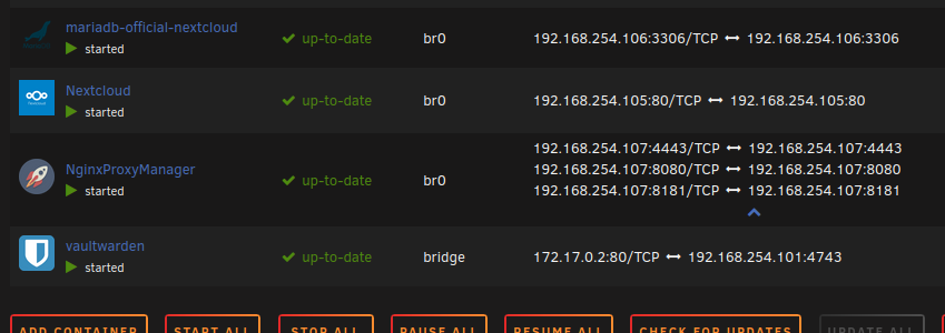

Hi, newbie here and I need help with the port setting.
I tried using custom br0 (used my local subnet), and assigned port 80/443, but when I fire up the container, it changes to another port numbers. See screenshot please
