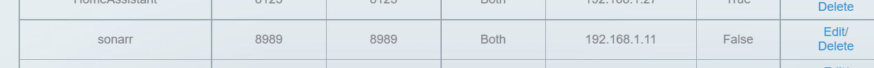

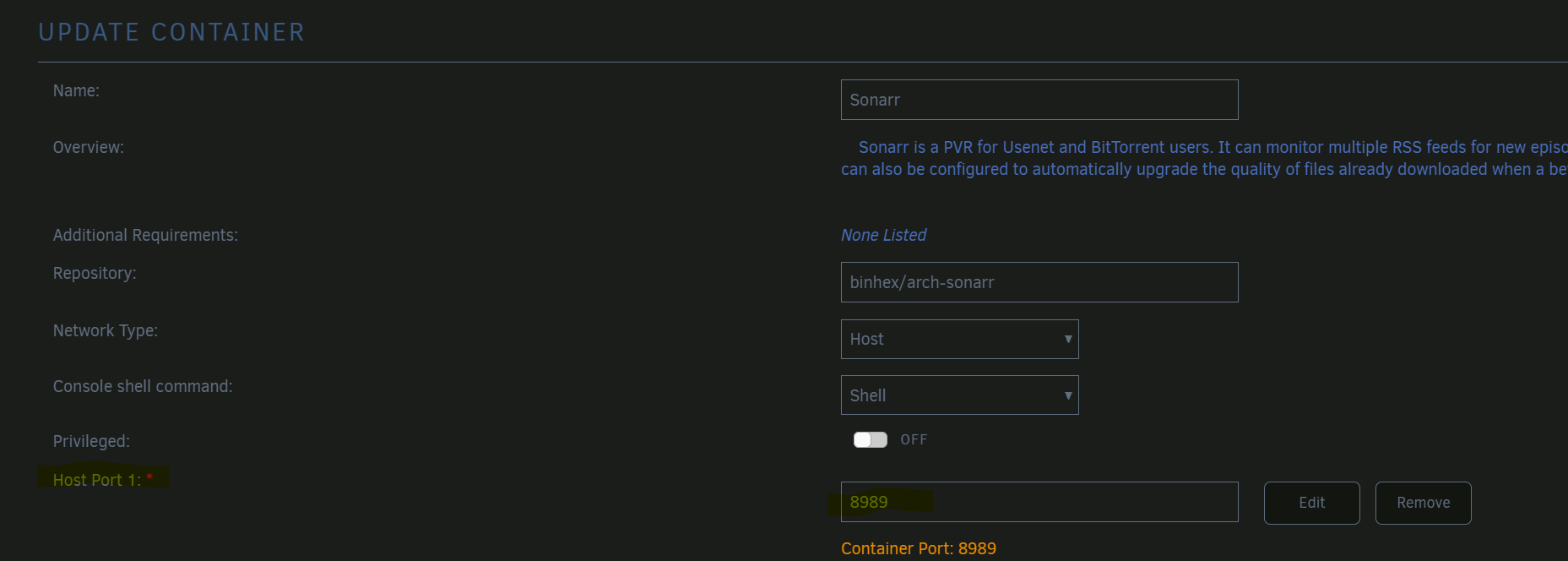

Yes.  All i want to do is reverseproxy containers on server 'B'.  However, I'm understanding you saying map Sonarr to host port like in screenshot below.  I am not following what you are saying here:  "Then just add a host sonarr.domain -> 2.2.2.2:12345".  I'm assuming add to my router and expose '12345'.  Or in my case below, the defaulr Sonarr port 8989??
Your server B is on the same internal network as server A right? Then you don't need to forward any ports.
In your example just add a host in NPM for sonarr.domain -> ip.of.server.B:8989

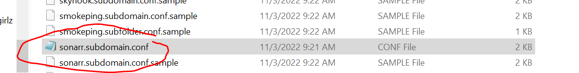

Thank you sir.  So I beleieve the equivelant in SWAG would be to add/ rename this conf file here and restart SWAG.  Problem now is...  when I do this, SWAG does not see the new .conf file after rename.  It olnly sees my custom .conf files created automatically with Dockersocket.  If I need to switch this conversation to the SWAG post please let me know.

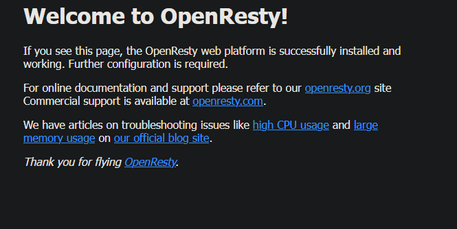

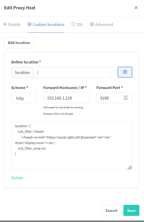

I'm trying to inject a link into every page served but having issues.
location / {
    sub_filter </head>
        '</head><a href="https://example.com" rel="me" style="display:none"></a>';
    sub_filter_once on;
When I try this as Advanced Configuration or as Custom Location I see a "Welcome to OpenResty!" page.
Anyone know how I can do this?

Open a shell into your NPM docker container and verify the result of your action (the nginx config file). I don't use this feature but perhaps it is already put into a location block?
thanks. I think i got it working.  If i enter "location /" it replaces the existing (working) location /{} in the config file. If I enter it without that, it just adds it to the file but not in the predefined "location /" section and seems to work. testing now. thanks

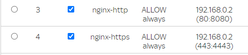

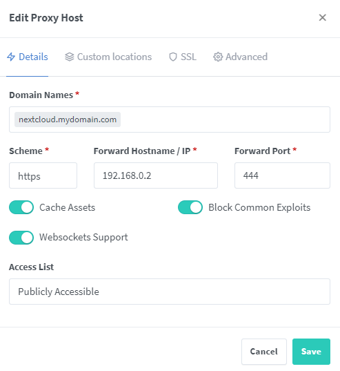

Hi, looking for some assistance setting this up with nextcloud. I've been messing around for longer than is healthy and hit a wall! I have a domain on cloudflare with nextcloud CNAME - nextcloud.mydomain.com. I configured NGINX to point to nextcloud but get a 404 error. I can access nextcloud locally when I remove the "overwrite" commands in the config.
-nextcloud, cloudflare ddns & nginx all on custom network (proxynet)
-server is 192.168.0.2
nextcloud is on port 444
-port forwarded as follows on a sky router
-cloudflare A record points to my public IP
-nextcloud config attached
-nginx settings
-cloudflare set to "full" on SSL/TLS, records are "proxied"
Result is a 404 not found error when accessing externally !
nextcloud.config.edit.txt
And what if you access your IP directly http(s)://your.external.ip ? What do you see? If you get a not found served by NPM at least that part is working. Or do you think the not found is send to you by nextcloud? Check the nextcloud container for example do you see your connection attempt there?
(also: it seems kinda strange that you forward it to https://192.168.0.2:444 usually you forward to a http endpoint because that is where you use NPM for; ssl termination).
Accessing external IP on https shows the same message - "404 not found ". I should have said the not found has a "nginx" footer so it's the same message. Changing to http I hit the log in page for the server.
The page does have the correct nextcloud address and is secure with uploaded certs but just doesn't seem to be finding nextcloud on the server.
