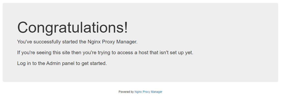

Gday matey :) May I please get some help with my topic, I reach a 404 error, but I have the
Congratulations!
You've successfully started the Nginx Proxy Manager.
If you're seeing this site then you're trying to access a host that isn't set up yet.
Log in to the Admin panel to get started.
Thank you :)

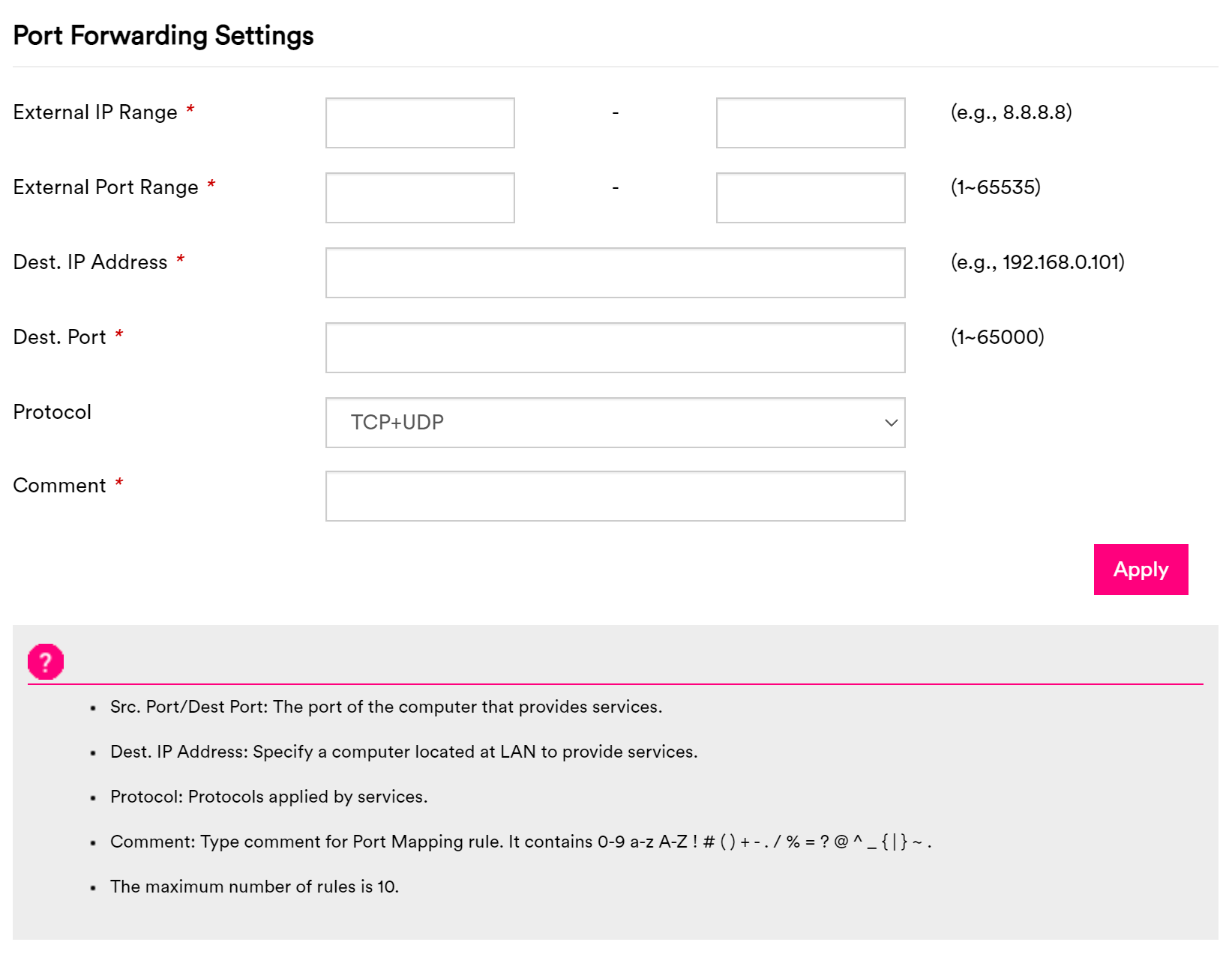

I just got a new router. Any idea how I am supposed to port forward NginxProxyManager? I'm confused what it means by providing an external IP range.
All of the asterisk* options are required.
nginx.thumb.png.4870c4ff797f2c6221fb072d4a696d2d.pngports.thumb.png.c69c7b5b489435e247380418c7fb3de7.png
I guess if you have multiple external IPs you could enable the forward only for one IP? But you will have to consult your router manual/docs for that. Or just use 0.0.0.0 - 255.255.255.255 to see if that works :)

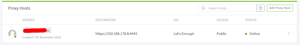

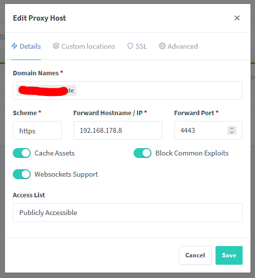

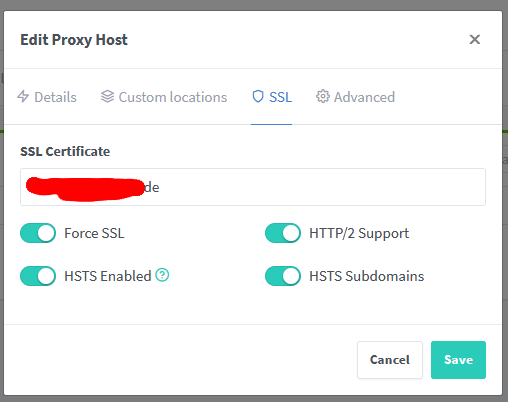

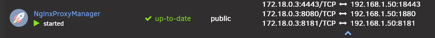

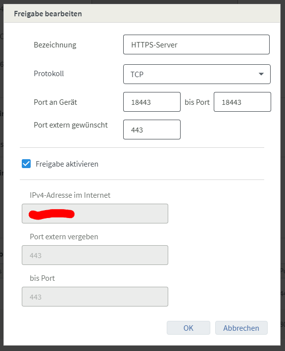

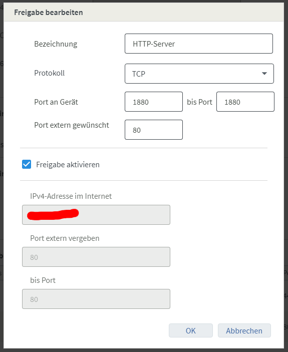

Hi there,
I have an issue with my NGINX forwarding, once again I must say, but I'm not able to fix it on my own :(
One or two days ago, not quite sure, the forwarding to my Nextcloud (also an unRAID Docker) failed. Anytime I try to reach it, I get a timeout ("ERR_CONNECTION_TIMED_OUT" in Chrome). I tried to raise the limit to 300 in the nginx.conf, but no dice; however, it's appereant that the timeout comes sooner than 300s.
I didn't change anything in the config, nor did I update any docker. MariaDB is the database for my Nextcloud.
I attached a few files.
Fritzbox is my router, I screenshot the setup for the forwarding (fritboxHTTP and -HTTPS); when I type the given, open IP into my browser (the one I cancelled out with red), I get the screen nginxResult; so appereantly it works in general, but seemingly it needs to be setup?
The setup of nginx is displayed in the nginxDockerConfig as well as nginxConfig0, nginxConfig1 and nginxConfig2.
I also added the logs to the dockers of nginx and Nextcloud, appereantly no errors in there.
So what to make of it?
Anytime I install nginx, I can't access Nextcloud through the WebUI as it directly re-directs through my DynDNS, resulting in the timeout. So I can't even tell if nginx is really the culprit here, I just assume it because in the past this was the case in a similar error
Best,
Rick
nextcloud_dockerLog.txt nginx_dockerLog.txt

On 12/18/2022 at 1:54 PM, CameraRick said:
Hi there,
Best,
Rick
nextcloud_dockerLog.txt 4.16 kB · 0 downloads nginx_dockerLog.txt 5.07 kB · 0 downloads
A fun small experiment would be the following:
edit C:\Windows\System32\drivers\etc\hosts (use notepad in administrator mode)
add the following
INTERNAL.ip.of.nginxdocker your.nextcloud.hostname
(so for example 192.168.1.123 nextcloud.foo.bar)
Then try to see what happens. You have now "excluded" the entire DNS part as your (and only your) computer now "forces" the specified domain to the specified IP.
If it works: you have an issue with your DNS provider. If it doesn't, it is something with NPM

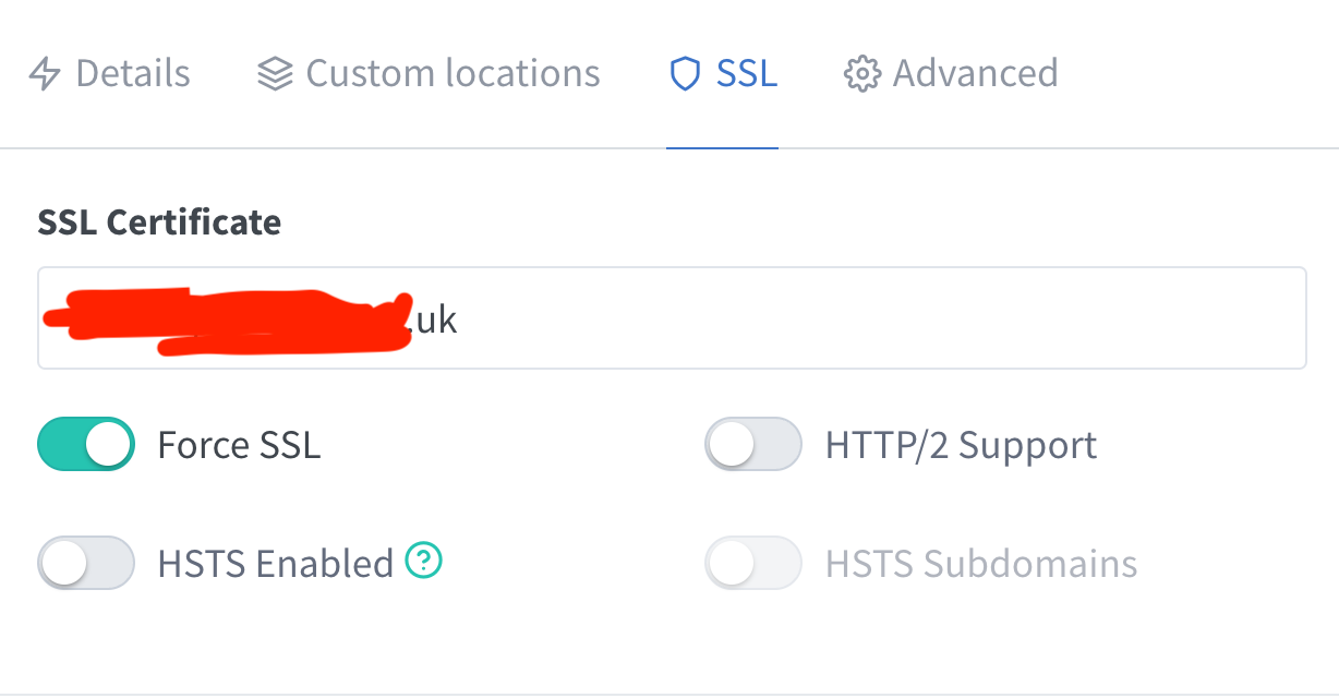

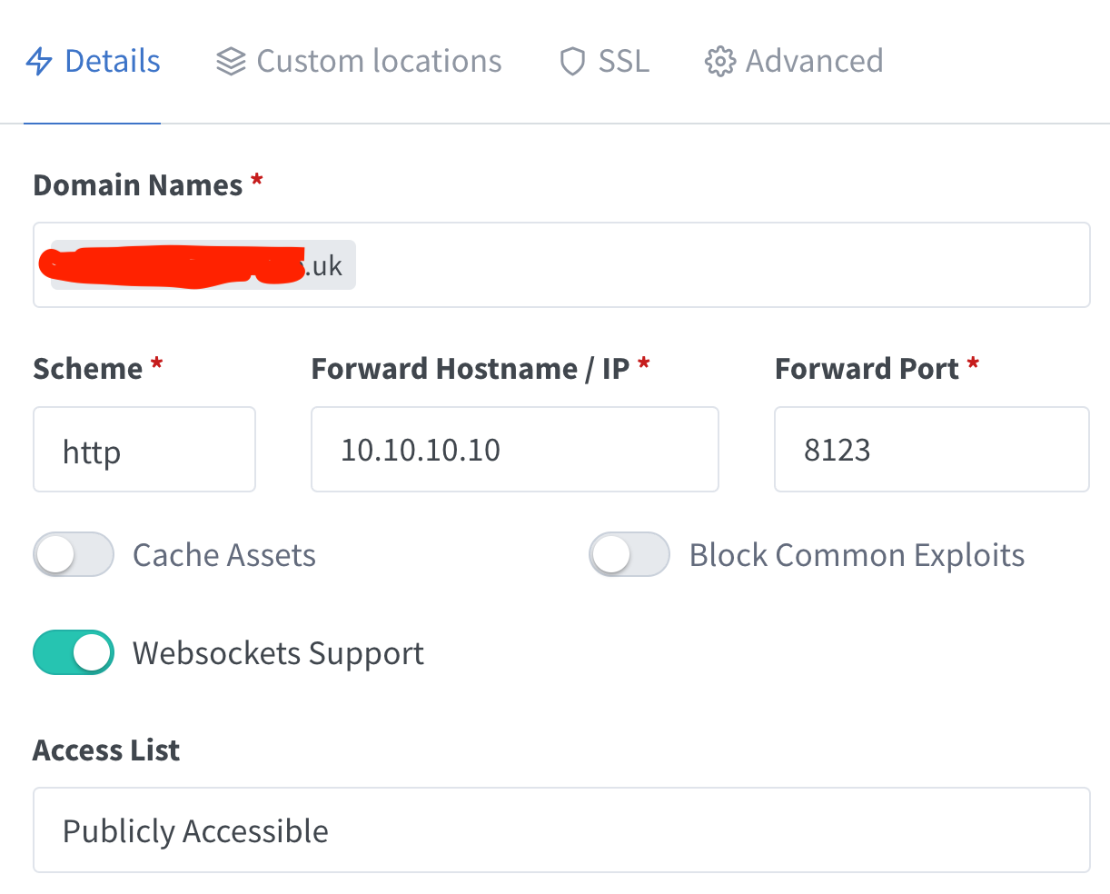

Ok so this worked! It let me create an insecure one, and it's now letting me create https ok and SSL is working too!
But... when I set it up for home assistant, I get '400: Bad Request'.
This is my setup:
1504665685_Screenshot2022-12-27at19_28_28.thumb.png.c85527a46da71667251a15951b9a732b.png
1012961560_Screenshot2022-12-27at19_28_47.thumb.png.cf26e2da5a7da7b6c5094f389b15b263.png
I want SSL to Nginx and http to home assistant on port 8123, so this is correct surely? I know it's getting through to Nginx ok, and the url http://10.10.10.10:8123 works fine locally.
This is my setup:
Yes that should work just fine. On what action do you get the 400 error? Adding the host or enabling SSL? You could try to remove all files in appdata and start fresh if you have nothing on it just to make sure nothing "strange" happend during initial setup. Or go to the console of NPM and try a couple of `certbot` commands to manually get a SSL certificate (I don't know the exact commands) and see if that works or if that possible gives an error that you can search for.
