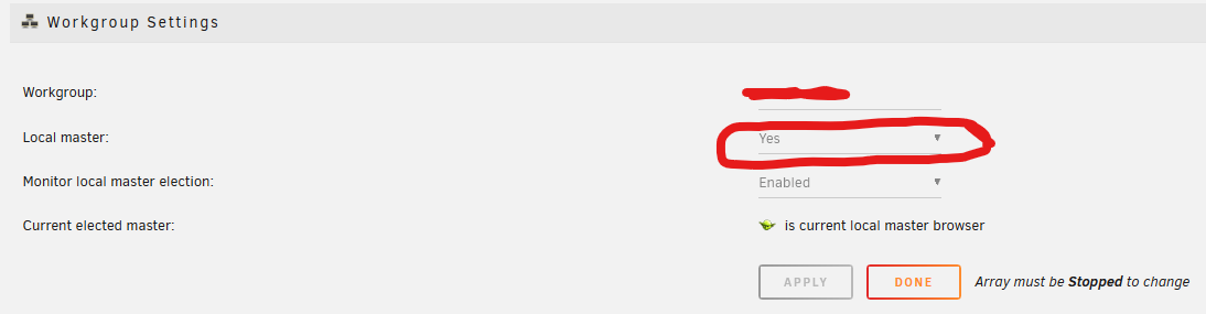

Have you gone to Settings   >>>  SMB    and turned on the "Local Master" option?
What ever server/computer is the Local Master should be on 24-7 for stability of the SMB network.  (It can take up to 40 minutes for a SMB network to stabilize...)

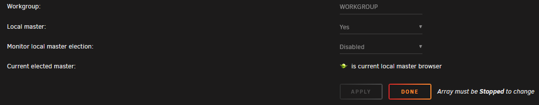

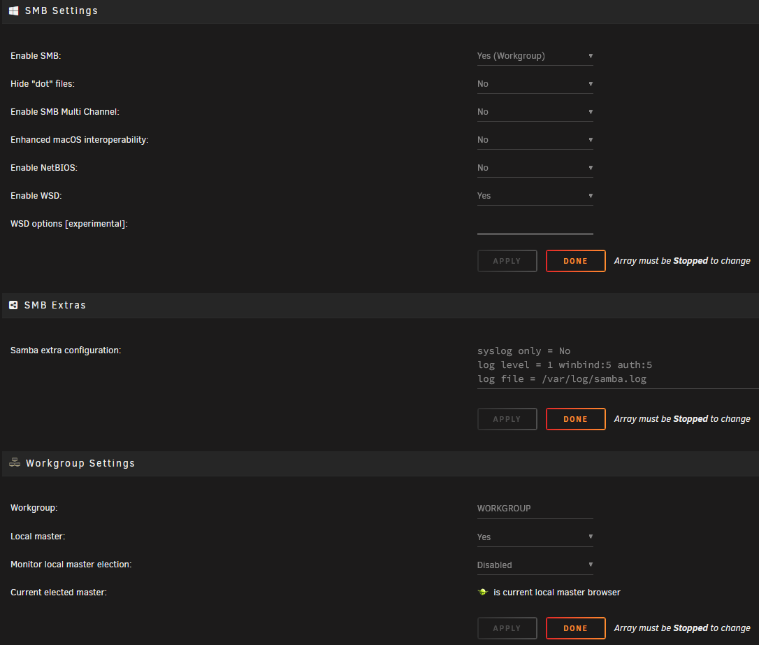

Everything was working fine with my system, but as some point something has changed and now I too, on multiple Windows PCs, have the:
My settings looks ok here:
and tower appears under File Explorer:
If I access the array via \\192.168.1.25 everything is fine.
Any ideas? I see lot's of different changes being done to various Windows settings but the thing is this all used to work OK, wish I could remember when/what has changed.

I'm also seeing in the samba.log repeated lines like:

It has been found that SMB is much more stable if a single computer is the SMB Local Master (The Local Master runs a sort of DNS service for the SMB network.)  The best choice for a Local Master is your Unraid server.   It works best if you leave the server running 24-7.  You make the setting by going to :   Settings   >>>  SMB    and look for this section:
BTW, the delay you experienced is not unusual, with a large SMB network, it can take up to 40 minutes for changes to propagate through the network.
Yes, I have unRAID running 24x7 and its the Local Master (according to Dynix plugin).
