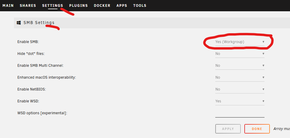

Go to  Settings   >>>  SMB    and make sure the following is set to "Yes (Workgroup)"

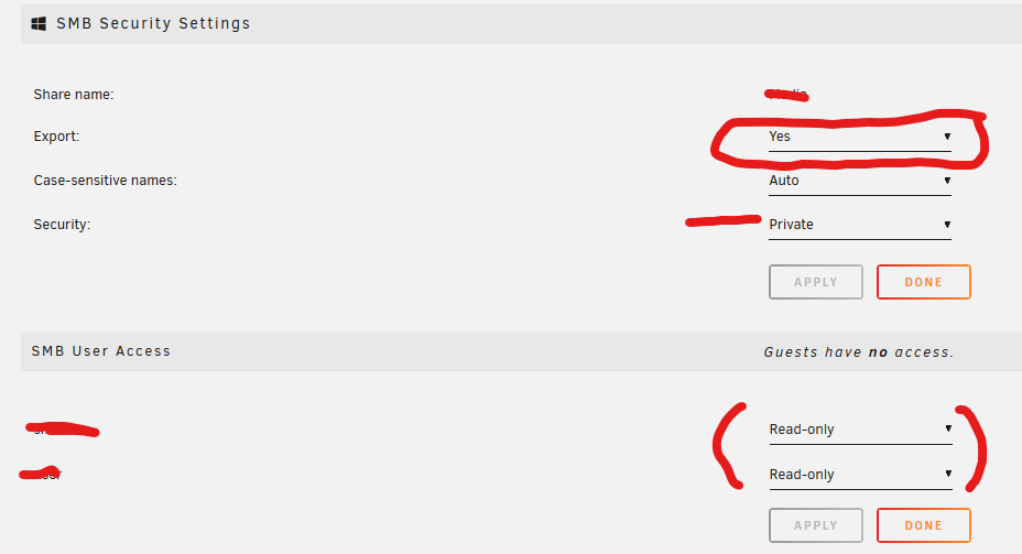

Make sure that you go to the Share that you will be mapping to your PC and change that user to have access to the share.  See below:
Notice that you will have to turn on 'Export'  and also grant the 'Share access User' (that you created earlier)  permission to access the Share!

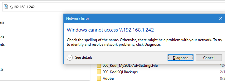

I can not attempt to chose a share, which is set to what I had before it stopped working AND what was listed above. When I browse to tower I get the error:
Windows cannot access \\tower
Check the spelling of the name. Otherwise, there may be a problem with your network. To try
to identify and resolve network problems, click Diagnose.
When I enter the IP in the explorer selection bar I see my NFS shares. When I enter \\tower\  i also only see my NFS shares

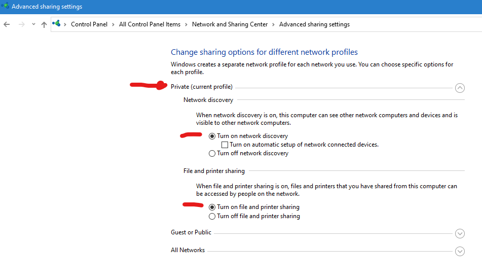

See the following Control Panel window.  The navigation to it is on the Address bar:
Make sure that you are set to a 'Private' network profile and it is marked  "(current profile)".  Then make sure that the two indicated radio buttons are selected.    (The naming of these three options can be a bit confusing at first.  'Private' is the one intended for connecting to networks are designed to be secure-- like your home.  'Guest or Public' is for connecting to open networks like the WiFi connections at airports or McDonald's.)
