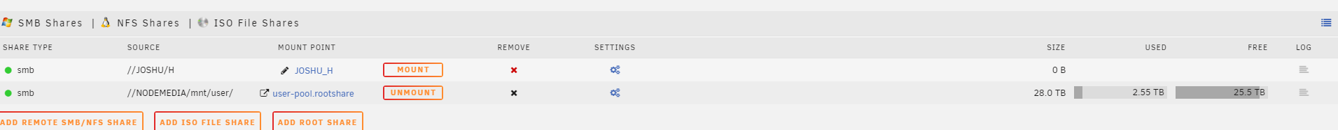

Hi, I also have a problem, though the other way around. Recently a week or so ago I shared a folder on Windows 10 and mounted it as a share on Unraid so I could move files from my PC to the Unraid server.
I tried to move files today on Rsync and was told the directory didn't exist. I looked at the share on Unraid and saw that despite being mounted, it was not accessible anymore. I deleted the share and remade it, and now when I mount it, it loads and then just asks me to mount it again. I have tried mounting it using both the name of the server and the IP address, and while it finds all the shares on my computer without issue, I am unable to mount it.
Help would be much appreciated. Thanks in advance!
Edited by joshu
format
Remote shares are a feature of Unassigned Devices. You should ask about this on its support thread with your diagnostics.
You can go directly to the correct support thread for any of your Plugins by clicking its Support Thread link on your Plugins page
Honestly thank you so much! I did not even need to consult that forum.
For some reason it didn't occur to me to check system logs / diagnostics for help. I did that and quickly narrowed the problem down to Microsoft accounts being an absolute pain. I switched my login from a Microsoft account to a local account and the share worked without issue. Thanks again for the help!
