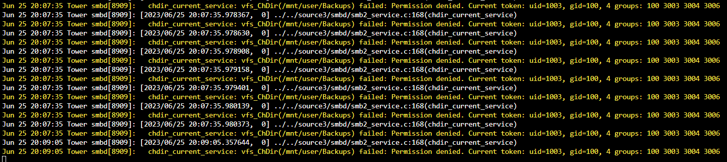

So, after updating from 6.9.x to 6.12. I can no longer acces my SMB shares. Syslog is filled with messages like these:
I've run docker safe new permissions. No change.
I checked ls -l /mnt and /mnt/user. All folders here are drwxrwxrwx with nobody:users as the owner.
I've tried creating a new user. No change
I've set the shares to public. No change.
Trying to acces the share via windows shows "Windows cannot acces \\Tower\Backups" and "You do not have permission to acces \\tower\backups", but no error code or something.
I've tried rebooting. Rebooting only samba. Removing all credentials in windows and rebooting that. Nothing seems to help.
What else can I try?

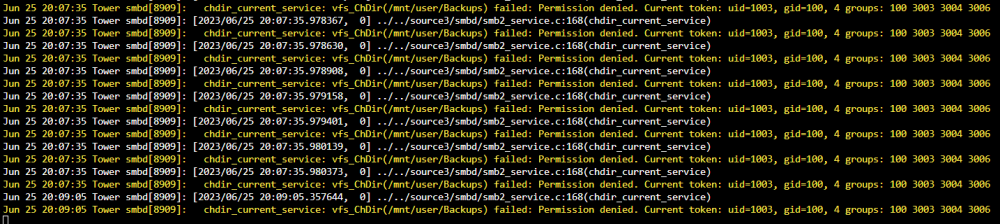

Post diagnostics so we can help you.
Don't really know either of those, but tailscale is a VPN? I do run wireguard. But not tailscale or zerotier.
This issue occurred directly after the update. The only share that does seem to work is an unassigned drive share, so samba itself seems fine? However none of the ones on the array work.
Edited by heggico
It might be worth running a check filesystem on all array drives and pools in turn.   I have seen file system corruption causing problems with shares.
I'll try that, but everything else is working fine. All dockers, the full *arr suite of containers. Plex etc.
The only thing "wrong" is SMB access.
I'll update when the check completes.
So, boot array devices (XFS) and cache (BTRFS) showed no error when running the check commands. (and scrub with BTRFS).
This didn't seem to change anything.
Also rebooted the server again afterwards. Suddenly, it works. So not sure what caused it and why it works now, but something fixed it.
Thanks for the help!
