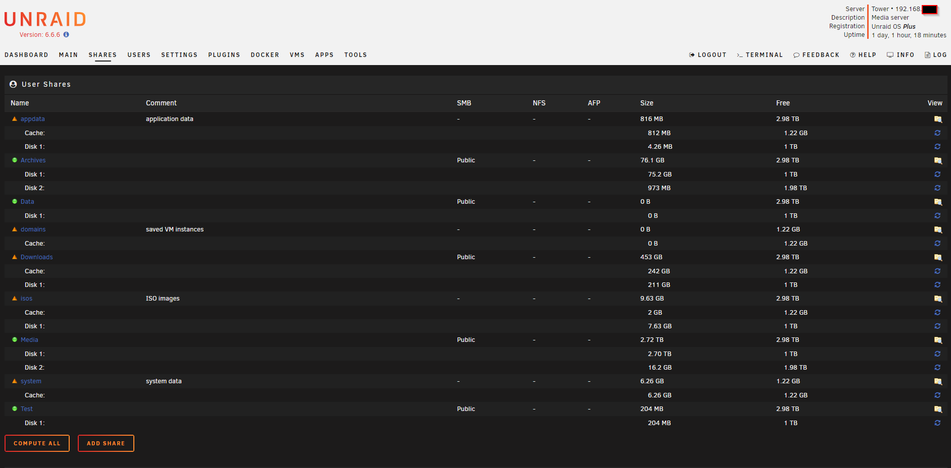

Go to the Shares page and click the Compute All button, then wait until it completes (may take a while) and post a screenshot.
1 minute ago, trurl said:
It is trying to move appdata to cache
Also the downloads share, that is likely the problem.
@johnnie.black Ahh ok, I misunderstood that. Looks like Mover is running now so we'll see how far that gets.
@trurl Alright, that is processing, will post results on completion.
