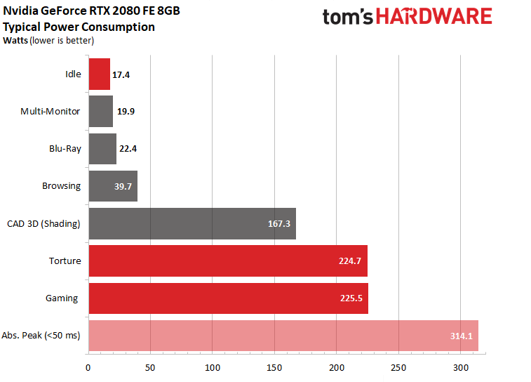

This looks like a kernel/driver issue to me. From various reviews I can see the 20-series from NVIDIA drawing 3-5 W more than the 1070 in IDLE.

True, though in IDLE both cards should consume less than 20 W:
For the 1070 it was around 7-10 W
My issue lies with the 2080 consuming more than 50 W in idle.
