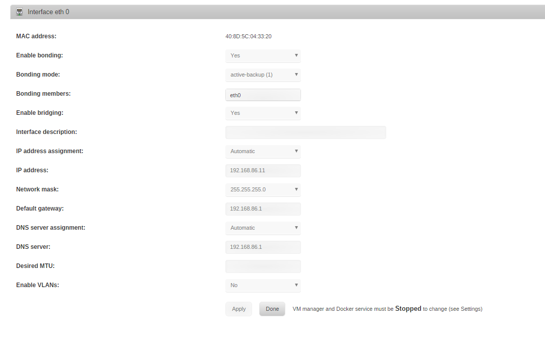

3 minutes ago, CHBMB said:
Ok, post me a copy of your screen as shown in settings => network settings

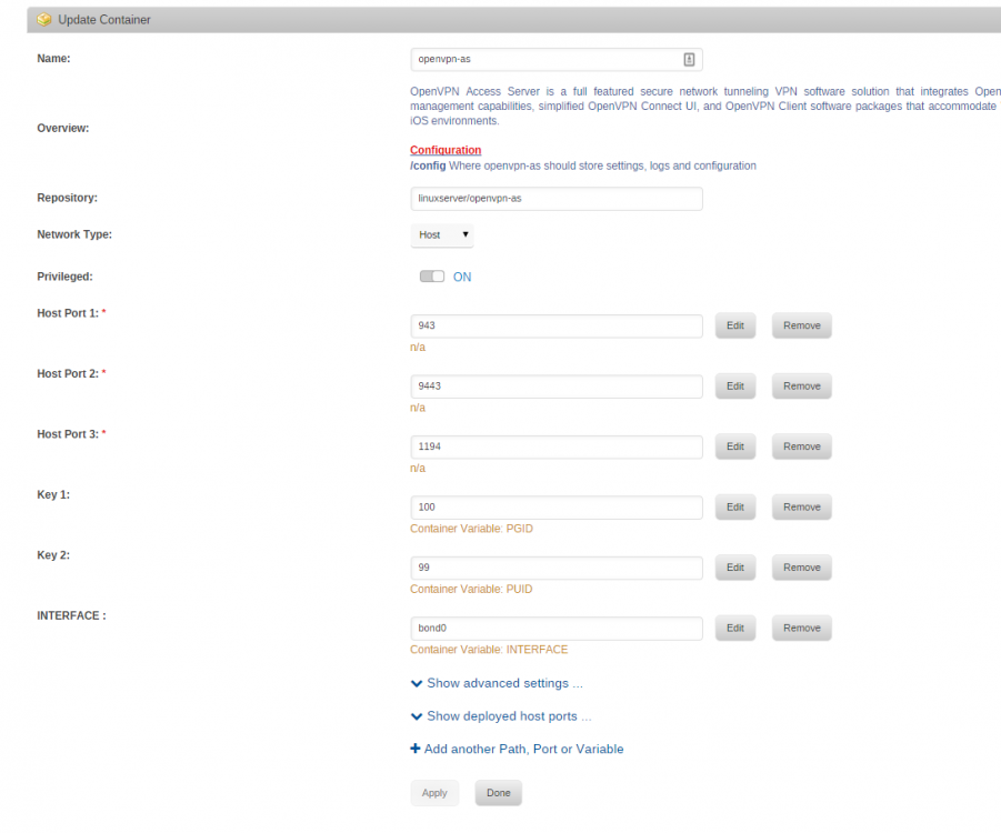

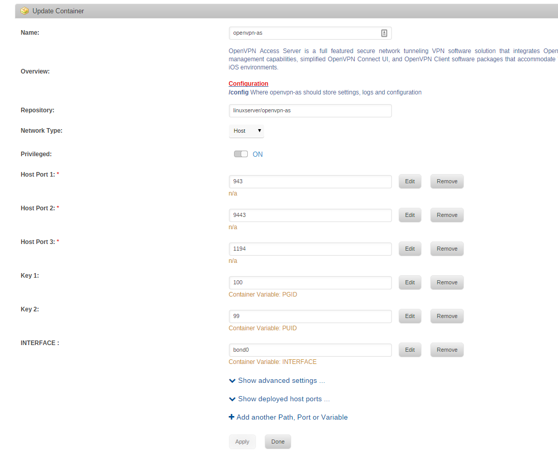

Hey guys, i'm having the same issue thegeneral was having.  I've setup a variable named INTERFACE and set it to bond0, I even tried br0.  Any help would be super appreciated.
