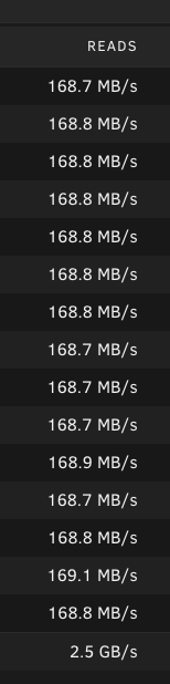

3 hours ago, BLKMGK said:
I have an Extender already in a box but based on what I saw in Johnnie's test it looks like using one slows transfer speeds down too. Right now I use 3x Perc H310 cards in my existing system and have IBM M?? cards as well which are pretty close to the same thing. We need better cards I think lol!
@BLKMGK sorry if this seems a little long but hopefully it will clear a few things up for you
IBM M1015 and Perc H310 are basically 9211-8i from what i understand, so for 1 card quick math is 8 drives x 600 MB/s = 4800 MB/s max throughput, but as it is PCIe 2.0 x8 its max speed is 4096 MB/s so 8 drives could do up to 512 MB/s each.
if you take both outputs from 1 card into an extender and have 16 drives off the extender you would have a max speed of 256MB/s per drive if you are only connecting spinning rust to them you may only just get to the limits of the card if doing something like a scrub when reading all drives at once. of course there could be some overhead info that may drop the speed a little.
if you had a 9207-8i or similar card that is a PCIe 3.0 x8 card the PCIe 3.0 x8 max throughput is 7.88GB/s so 8 x 600 = 4800 / 16 = 300 MB/s which is still plenty for HDD's.
if you only had 1 HBA IBM M1015 or Perc H310 with 1 cable to the extender and 1 to 4 drives 4096 / 2 = 2048 / 20 drives = 102 MB/s and 2048 / 4 drives = 512 MB/s

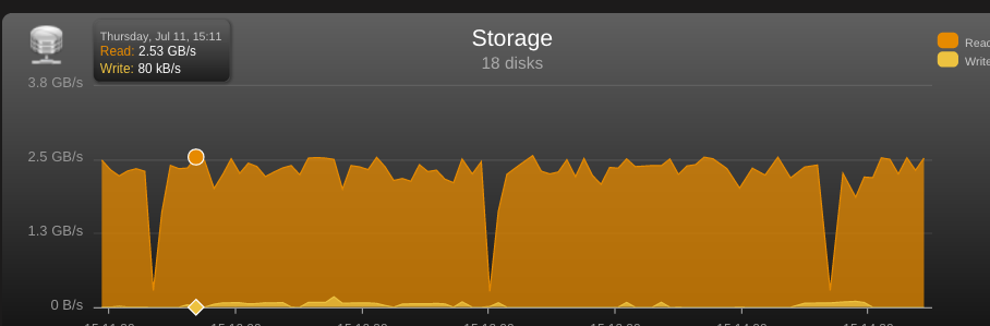

When a scrub is started on my server it tops out around 160MB/s per drive on all 15 disks which is 2400MB/s in total i only have 1 cable to the extender which is 2400MB/s max speed and as it continues through the 4tb drives it will drop to match the drives as the further you get through a disk the read speed slows down when they have finished scrubbing and all the 8tb drives are left to continue it will pick up in speed again.
I have a 9207-8i in my server as i didn't want to fuss around with trying to flash a card, these ones just work otb as jbod/i.t. mode. i just started a scrub to take some screen shots which are attached below all my drives are connected/detected as sata3 6Gb/s disks for a bit more info.

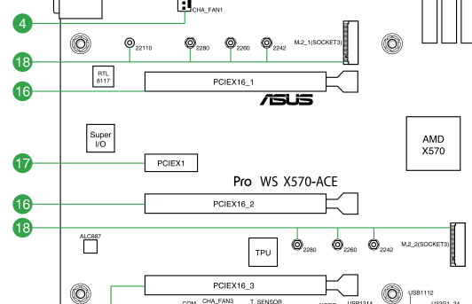

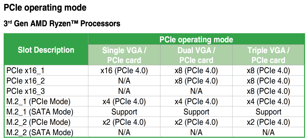

@johnnie.black Here is the screenshot of the PCIe slots :
145090200_E15611_Pro_WS_X570-ACE_UM_V2_WEB.pdf2019-07-1110-47-17.png.9eee2ad7d835302af3cc24fd23935f25.png
There is 3 x16 PCIe slots.  According to the details, this is how it operate.  I know i'll use M2_1 for my MP 600 PCIe Gen4 x4 SSD.  Still not understanding if I want to have, 2 x HBA (LSI 9211-8i), 1 x GTX 1060 (PLEX docker transcoding).  Can I still add a GTX 1080ti at full speed in one of those slots for PCIe Passthru to a Win10 VM without loosing Storage Bandwidth?  Also, there is a U.2 connector that they say in the manual can be use with a SFF to 4 SATA cable to connect 4 disks, so it means it can have a total of 8 SATA (4 Sata ports onboard + those 4 from the U.2).  Are they usually as fast as 4 inidividual SATA port on the motherboard?

4 minutes ago, testdasi said:
No way to know without someone actually owning the board. Even different BIOS versions can result in different IOMMU groups.
Thanks, i'll do some testing next week when everything will come IN.  I just got the MP 600 SSD in my hand 😃
I believe so.
