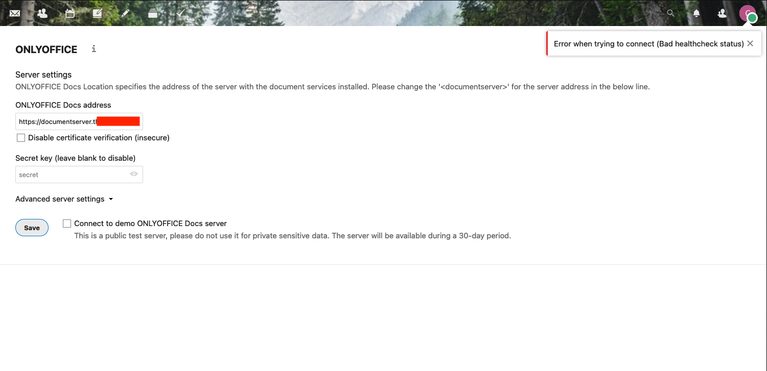

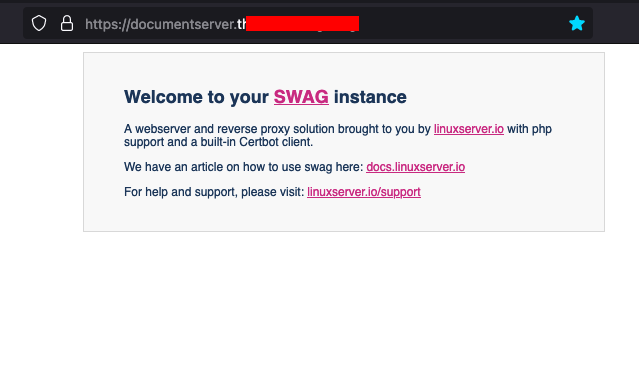

September 3, 20215 yr Apologies for reviving an old thread, but I'm trying to get this going and I'm getting a "bad healthcheck status" error when trying to connect to my onlyoffice DS. I can get to the server's welcome screen from a web browser, but when I try to connect to it in nextcloud the error below appears. I'm using nginx proxy manager This is the error: Exception: Bad healthcheck status /config/www/nextcloud/apps/onlyoffice/controller/settingscontroller.php - line 172: OCA\Onlyoffice\DocumentService->checkDocServiceUrl() /config/www/nextcloud/lib/private/AppFramework/Http/Dispatcher.php - line 218: OCA\Onlyoffice\Controller\SettingsController->SaveAddress() /config/www/nextcloud/lib/private/AppFramework/Http/Dispatcher.php - line 127: OC\AppFramework\Http\Dispatcher->executeController() /config/www/nextcloud/lib/private/AppFramework/App.php - line 157: OC\AppFramework\Http\Dispatcher->dispatch() /config/www/nextcloud/lib/private/Route/Router.php - line 302: OC\AppFramework\App::main() /config/www/nextcloud/lib/base.php - line 993: OC\Route\Router->match() /config/www/nextcloud/index.php - line 37: OC::handleRequest() What is the URL you guys are using within nextcloud to connect to ONLYOFFICE? I just use my full domain name like documentserver.mydomain.com

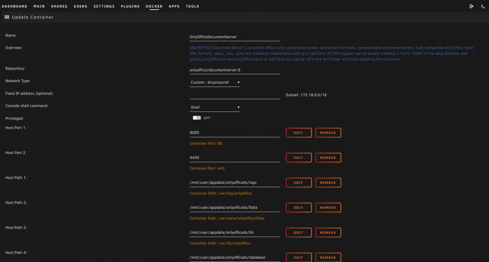

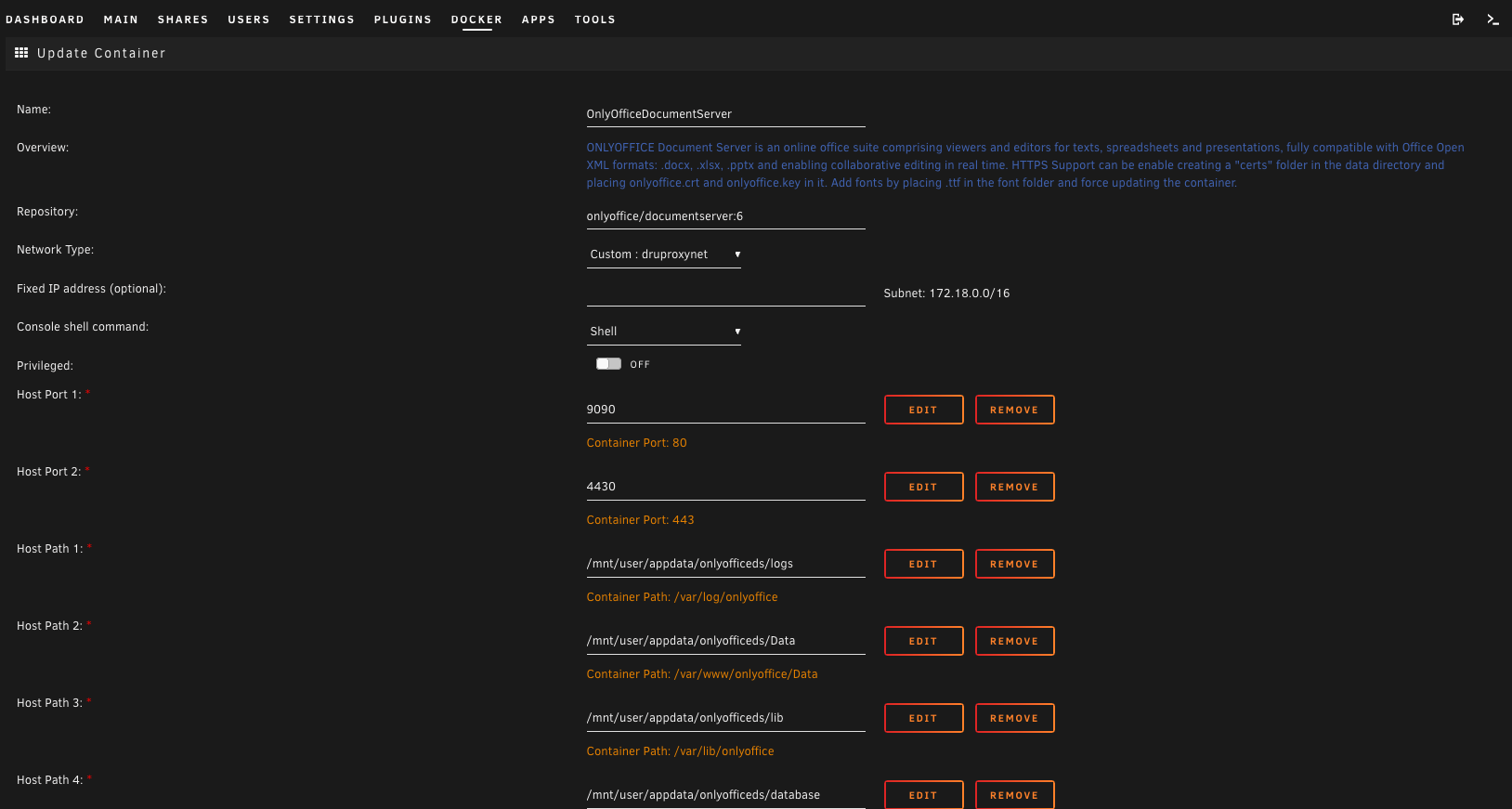

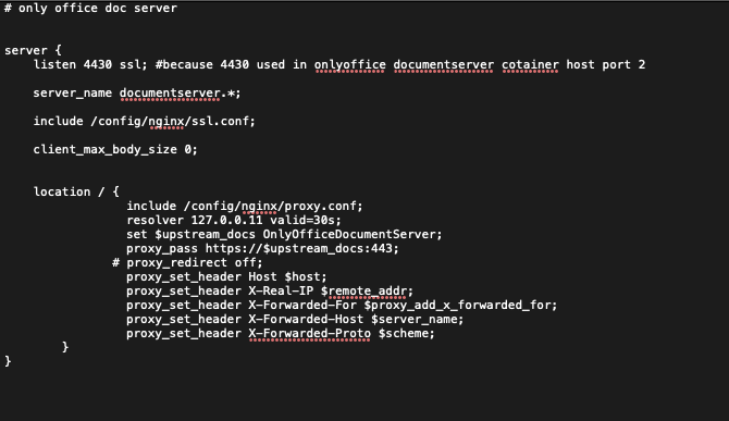

December 30, 20214 yr I'm stuck with the "Error when trying to connect (Bad healthcheck status)" error. I followed spaceinvadersone's video as well. I'm using Swag and I haven't used NginxProxyManager before. I've tried deleting the folders inside of onlyofficeds and restarted the container but that did not fix the error. I had to comment out "proxy_redirect off;" in the config file because of the ("proxy redirect" directive is duplicate in) loop I got in the swag log. I've also changed the repository to "onlyoffice/documentserver:6" but no fix. I've been going through many posts, but could not find a solution that works for me. Attached are screenshots of my setup and errors. Hoping I can get some help to get onlyoffice working with nextcloud. Does anyone know what does the "Bad healthcheck status" really mean? Thanks in advance.

January 9, 20224 yr 8 minutes ago, Trick said: Here in the same situation, did you manage to fix this? Hey @Trick, yes. You can see the solution here: I just needed to change the config file. Let me know if this works for you too.
January 10, 20224 yr 10 hours ago, TekDRu said: Hey @Trick, yes. You can see the solution here: I just needed to change the config file. Let me know if this works for you too. Thanks a lot, got it working now. Now I won't have to waste my night not sleeping
March 20, 20224 yr Hey everyone! So I just spent the past two days trying to get Only Office set-up and my gosh did I run into hiccups!! Anyway, I got it figured out after piecing together a number of different tutorials (thank you @SpaceInvaderOne!!!) and scrolling through the forums. I am no expert and do not take any credit for this but want people to have a one stop shop to the solutions to the problems I ran into. So I first want to say that I setup Nextcloud using @SpaceInvaderOne’s newest tutorials. So I am using linuxserver’s Swag and Nextcloud containers. I then went and followed @SpaceInvaderOne’s video on how to install OnlyOffice. Minor Changes throughout the video When you install the OnlyOfficeDocumentServer you will want to use Siwat2545’s docker and change the repository to “onlyoffice/documentserver:6.0”. This will install an older version of the OnlyOfficeDocumentServer. Follow all the other steps in the video for this section. You will change the scripts from “letsencrypt” to “swag” when copying the certs (this is if you are using swag) At the config file section you will want to download the file from the video and make the necessary changes that he goes over (make sure you establish a cname on cloudflare directing to whatever subdomain you use). What I also had to do different was delete “proxy_redirect off;” from the file. I then followed the rest of that tutorial. You can check to see if the OnlyOfficeDocumentServer is up and running properly through Swag by typing whatever subdomain and domain you linked it to into your browser. It should take you to the Only Office page that congratulates you on setting it up. After this I went to Nextcloud and tried to link my subdomain.domain within the ONLYOFFICE app and got this error (Error when trying to connect (Not supported version)(version 6.0.2.5)). You will need to downgrade your ONLYOFFICE app. To do this you will need to disable and uninstall the application from your Nextcloud. Then follow the step in this link. https://help.nextcloud.com/t/error-after-upgrading-app/126540/17 At step 5 I used @sonic6's suggestion and used these instead. find ./onlyoffice -type d -exec chmod 0750 {} \; find ./onlyoffice -type f -exec chmod 0640 {} \; So after doing all of this I got OnlyOffice working and I hope it does for you too. I am no expert so maybe there is a better way of doing this. I also hope people can understand my steps lol. Good luck!

October 1, 20233 yr Hello, I know this is an old thread. I attempted to follow the steps to set up OnlyOffice: 1. Created CNAME onlyoffice.mydomain.com 2. Install and renamed container 3. Added .conf to Swag 4. Copied .crt and .key to onlyoffice's folder, rename 5. Restart containers Now I'm in trouble. In the logs for Swag, it's looping "nginx: [emerg] "proxy_redirect" directive is duplicate in /config/nginx/proxy-confs/onlyoffice.subdomain.conf:16 nginx: [warn] protocol options redefined for 0.0.0.0:443 in /config/nginx/proxy-confs/onlyoffice.subdomain.conf:2 nginx: [emerg] "proxy_redirect" directive is duplicate in /config/nginx/proxy-confs/onlyoffice.subdomain.conf:16 nginx: [warn] protocol options redefined for 0.0.0.0:443 in /config/nginx/proxy-confs/onlyoffice.subdomain.conf:2 nginx: [emerg] "proxy_redirect" directive is duplicate in /config/nginx/proxy-confs/onlyoffice.subdomain.conf:16 nginx: [warn] protocol options redefined for 0.0.0.0:443 in /config/nginx/proxy-confs/onlyoffice.subdomain.conf:2 nginx: [emerg] "proxy_redirect" directive is duplicate in /config/nginx/proxy-confs/onlyoffice.subdomain.conf:16" Not only is the OfficeOffice subdomain not working, now my other reverse proxies, Nextcloud and Jellyfin, aren't working either. Help!
