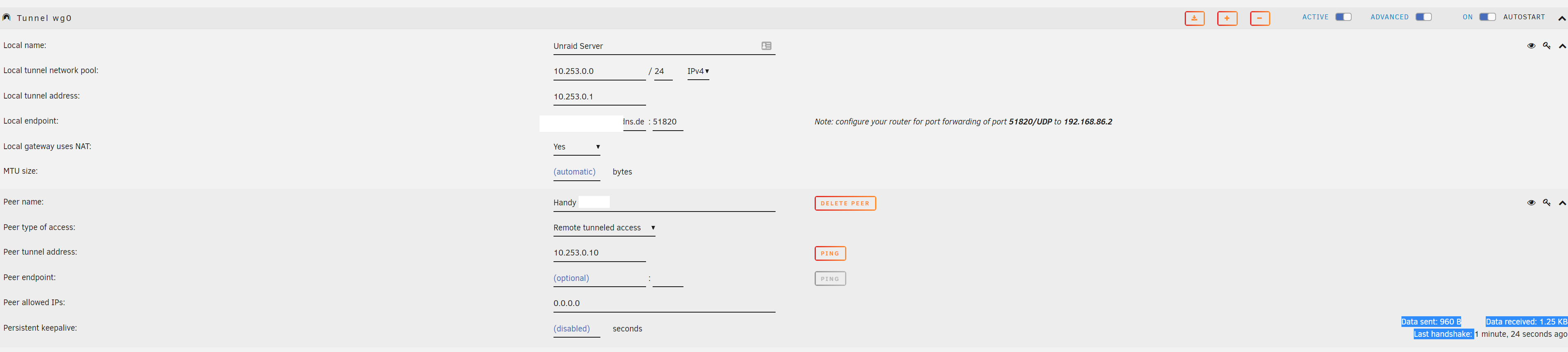

I dont understand why its not working. I changed allowed IPS to 0.0.0.0 which should mean everything, right?
The handshake seems to work. Data sent: 960 BData received: 1.25 KBLast handshake: 57 seconds ago
But i cant browse internet (or local network) via mobile if i enable the VPN.
See Picture for more. What ive changed on client (mobile) was adding a dns server (my own local DNS Server) in this case its 192.168.86.5

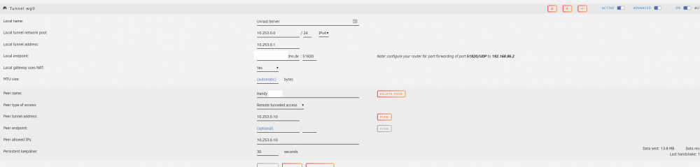

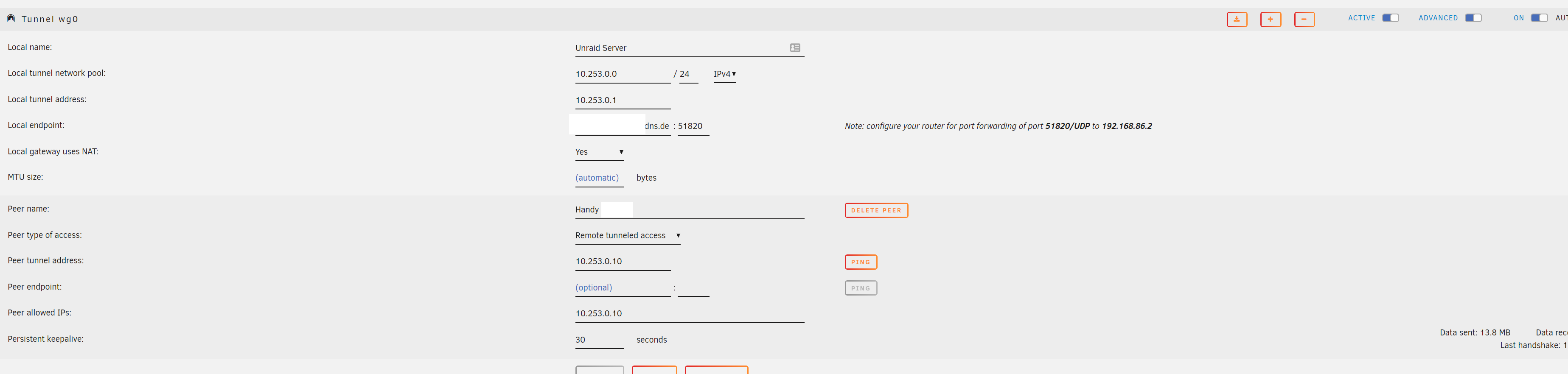

Slight issue here. I was successfully able to set up Wireguard using the Remote Access to Server option and connect via my phone. However, this has broken local access to Unraid's GUI for me. I am still able to connect to dockers such as Plex, Sonarr, etc while on the local network, just not the Web GUI.
It seemed so easy at the start. But im lost. Like suggested im using "remote tunneled access". - i want to access my LAN(s) - and Internet.
My phone can connect (handshake) with unraid.
Finally i can access unraid ip. (ive entered unraid ip in allowed ips) and see the unraid interface.
BUT i cant access internet (ive tried setting DNS to 8.8.8.8 or blank) [i think i cant access unraid when i set an DNS server???]
So ive changed allowed ips to 0.0.0.0/0 (which should mean access to all ipv4 addresses)
Then nothing works (no unraid ip, no internet)

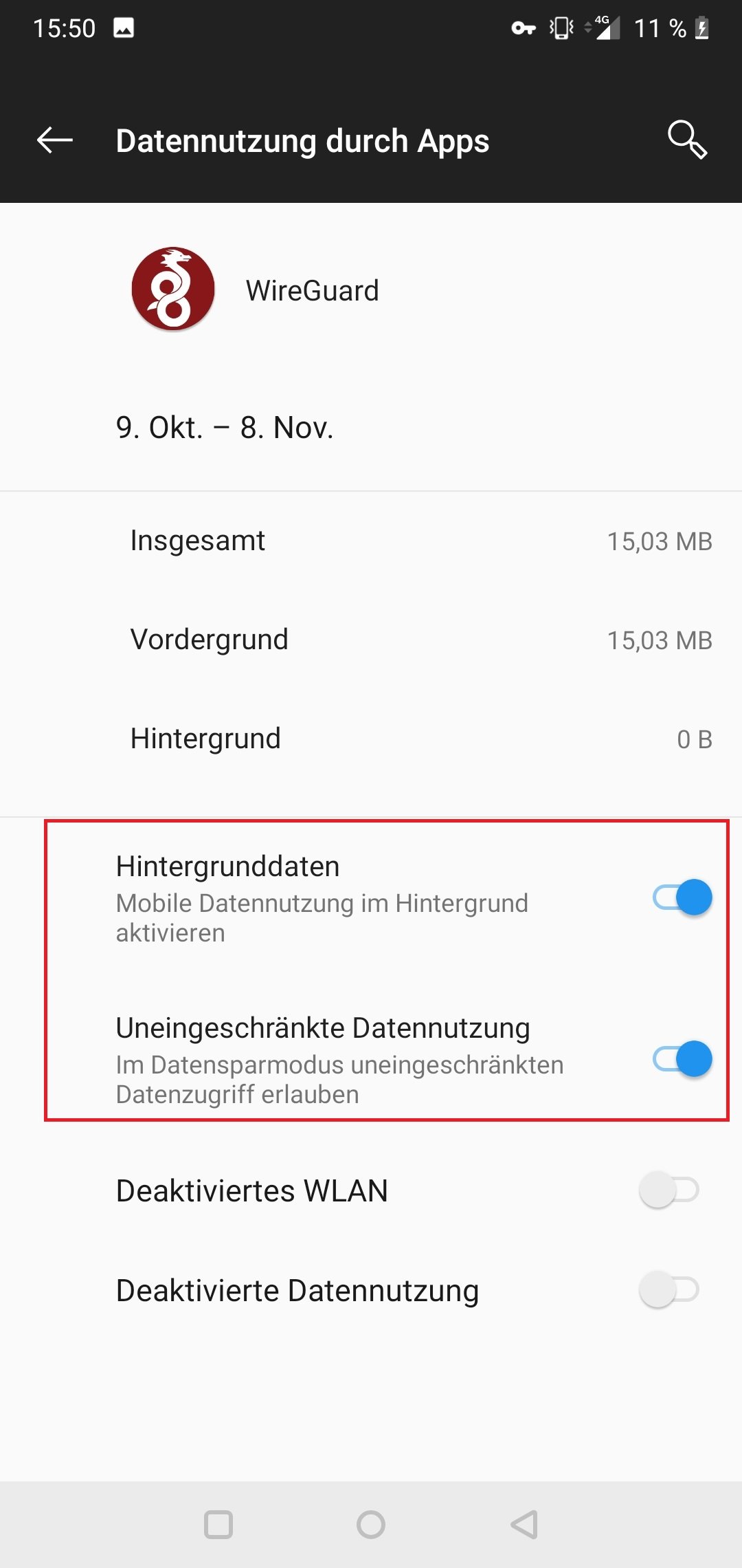

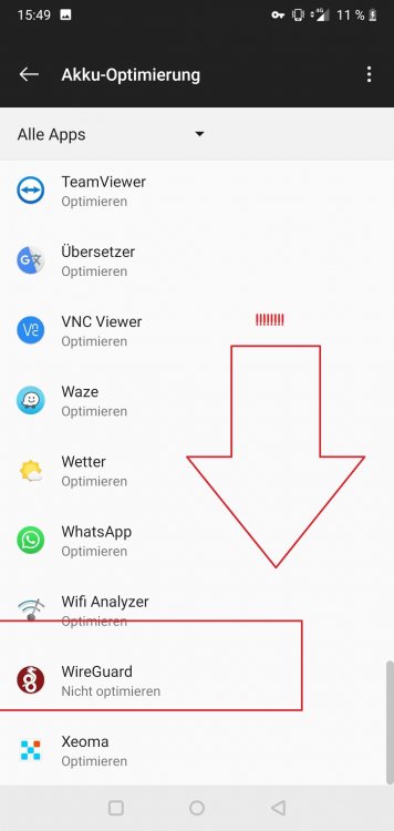

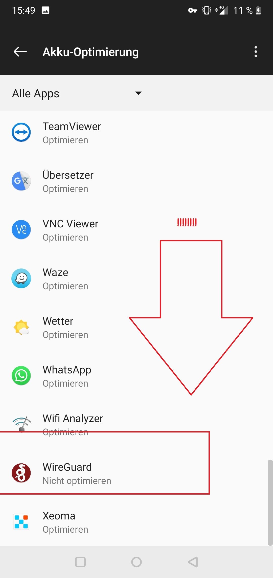

Hahha, i found out one of the biggest issues....
I always run my mobile in energy saver mode... which prevents apps like wireguard from running correctly...
YOU NEED to enable UNLIMITED DATA USAGE and DEACTIVATE any ENERGY saving features for wireguard (!!!) (or dont use energy saver mode)

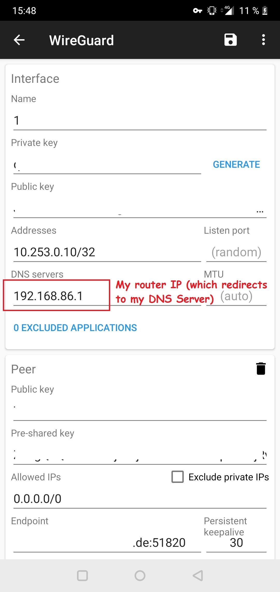

I GOT IT WORKING 100%
I needed to enter my routers IP as DNS (which himself get the DNS from my local DNS Server - i guess it was blocking other DNS Servers?)
Thats my Setup which seems to work for now with my own dns Server:
Only problem left is, how to block youtube ads on mobile... on desktop i dont get any ads bc of pihole, but on mobile, even with pihole as dns server, i still get ads.. anyone any idea?
