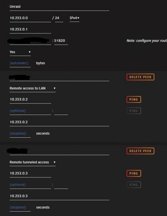

I configured remote tunneled access for one device and remote access to LAN for another.

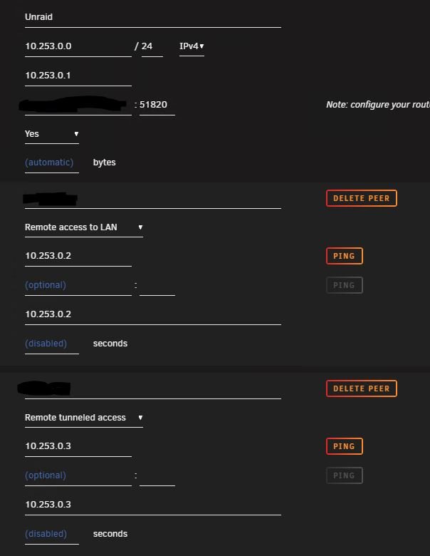

My guess would be that you misconfigured the IPs? make screenshots from your settings

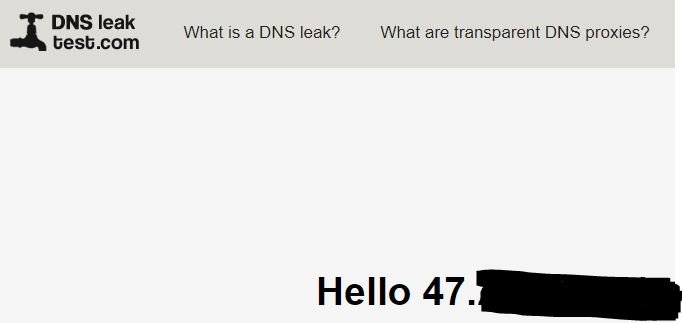

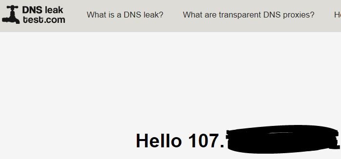

When i do a IP check i'm getting the public IP address of my internet connection, not the one supplied by the router VPN connection.
You are testing this from the client (peer) side, right?
When you activate the WG tunnel, it will send ALL traffic over the WG tunnel because you have selected "Remote tunneled access", you need "Remote server access".
Change the type of the second (and first) peer to "Remote server access". Next reconfigure the client(s) with the updated changes.

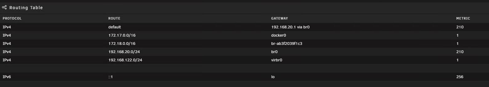

Ok, i think there is a misunderstanding here. The tunnel is working fine for both clients, the VM is NOT a client. What is happening is that traffic from the VM that is running on Unraid gets routed incorrectly when the tunnel is turned on (in a active state).
The VM does not go through the tunnel at all, it's completely separate, it's just running on Unraid. IP Address of the VM is 192.158.20.4, it goes to the router and out an OpenVPN connection configured there. When wireguard is activated the traffic from the VM is getting my ISP public address, not the VPN address it should be. So it looks like the VM is using Wireguard as it's gateway for some reason. See the screenshots.
Without Wireguard running....
With Wireguard running, remember this isn't configured to use wireguard at all.

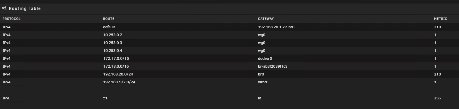

Here is the routing table when the Wireguard server is running.
Sorry for being dense, maybe my configuration is just off.
The default gateway is still your router (192.168.20.1) and VMs will still use that.
The only destinations (remote peers) which go over the tunnel are the 10.253.0.X addresses.

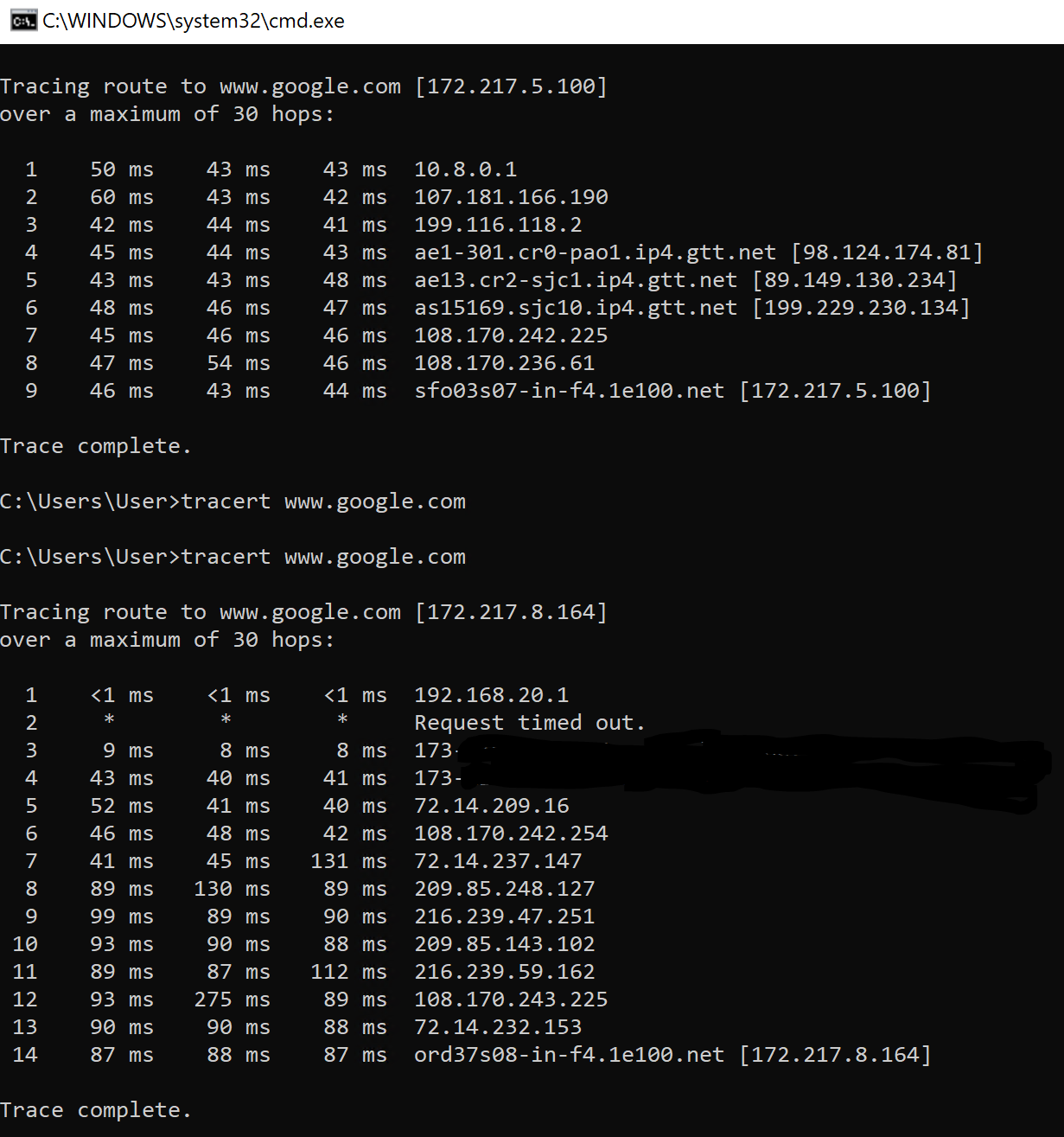

On the VM, try running "tracert www.google.com" in various configurations and see what changes. That will show you the path that the system is taking to get out to Google.
This from the VM. First trace is with the wireguard server inactive. The first IP is the gateway of the VPN. The second trace is with wireguard active. The VM isn't hitting the IP of the VPN gateway, it's using the router as the gateway.
image.png.e76b06005d40ca8600ac787c92769d70.thumb.png.34aff632da14c30bea6607c39895d883.png
OK, so 192.168.20.1 is the direct IP of your router, without using VPN.
And 10.8.0.1 is some sort of VPN running on your router?
I see no evidence of Unraid being used as a gateway or anything super strange like that.
I would look closer at how your router determines whether to send traffic through 10.8.0.1 or 192.168.20.1. Is it based on IP address or MAC address maybe? If so, you'll have to figure out why the router thinks the IP or MAC has changed.

You are correct. The vm running on unraid gets its ip from the router based on mac address, 192.168.20.4 in this case. The router sends traffic from 192.168.20.4 over the VPN. So activating wireguard on unraid is changing the ip of the vm? Seems weird. Maybe I'll try to statically assign the ip to the vm and test again.
