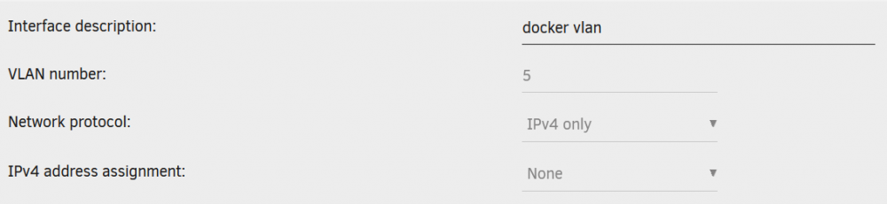

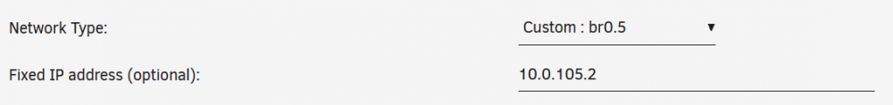

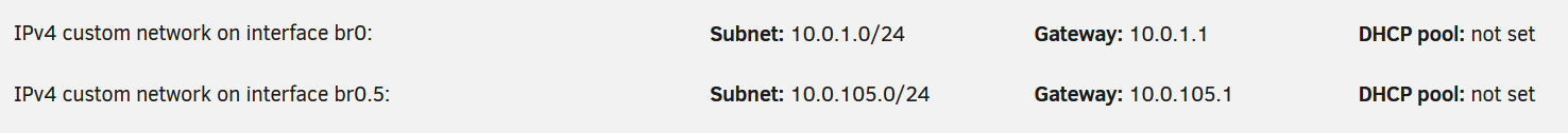

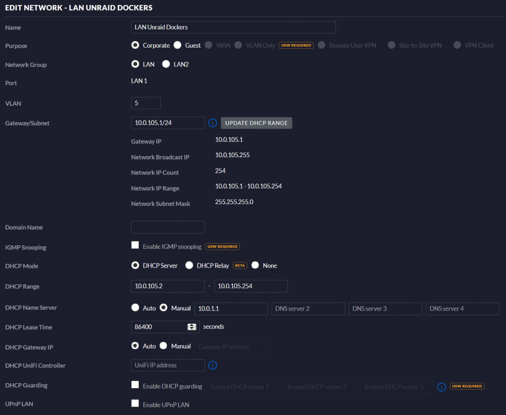

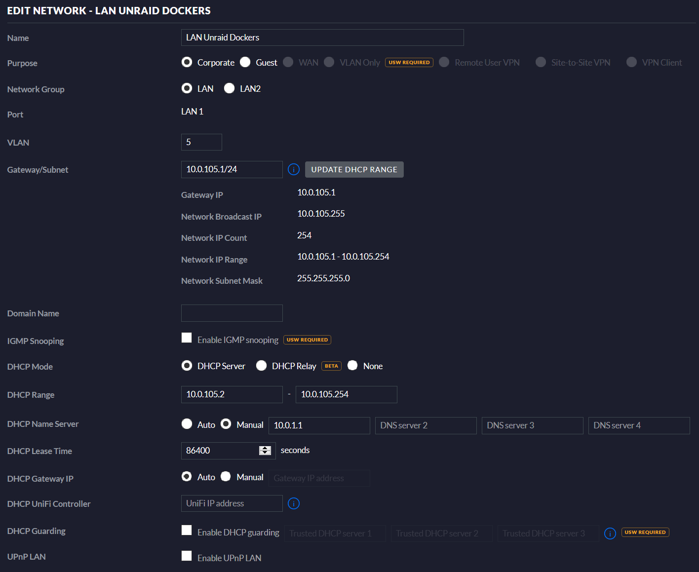

Having the same issue, but not quite sure where to go from here.  I use Pi-hole through Docker on br0 with its own IP address (10.0.1.7).  Adding a static route to the Unraid IP (10.0.1.5) allowed me to access external domains using Remote Tunneled Access but only with an external DNS server set in the Wireguard profile.  I can access all other LAN IPs on the network except for the Pi-hole IP.  If I use my router IP (10.0.1.1) for DNS, it still works, but I get DNS leaks (I'm assuming its because the primary DNS IP for Pi-hole that's set is failing so its falling back to the external secondary).
** Edit: Read up on the other Wireguard thread and tried using a VLAN for Pi-hole to fix the issue.  Looks like everything is working on a remote client (using iOS to test) and can access all Docker IPs remotely.  In case this helps anyone else, thought I'd post screenshots.
Unraid network settings for VLAN:
Unraid Docker settings after setting that up:
Unraid Pi-hole settings (I also set the "ServerIP" variable to the same and left "INTERFACE" variable as eth0):
Unifi Static route:
Unifi VLAN settings:
Wireguard client settings:
I'm no expert on this stuff, but from what I got from the other thread and setup here, it seems to be working and the IP shows as the Unraid/home network when accessing external domains when Wireguard is turned on.

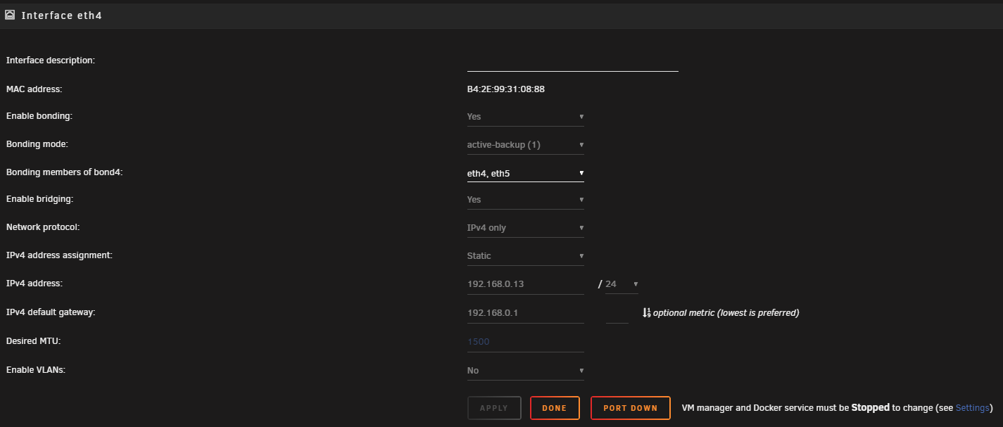

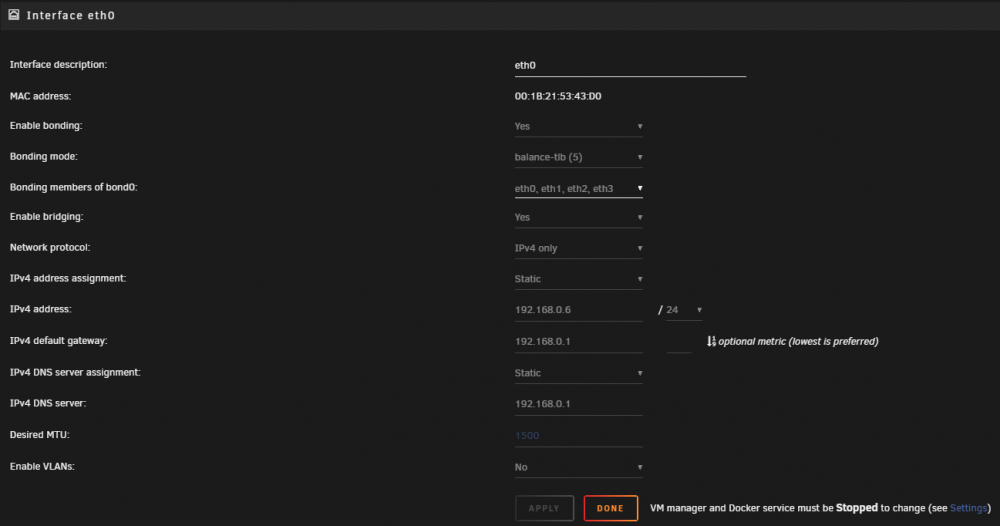

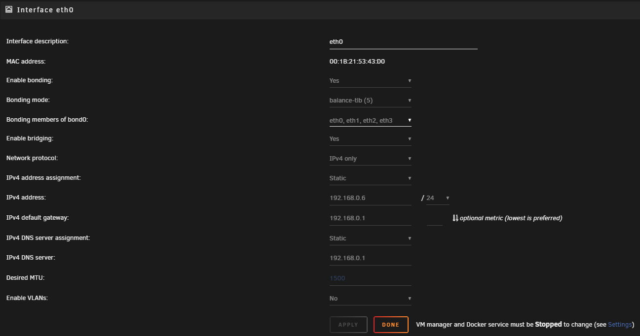

I managed to get everything working its really fast and I LOVE IT!
BUT it only works if I connect to my "fault-tolerance (active-backup) IP not the "main ip" ?
I have tried so many things but this is the only one working, any idea to why? and how I can change the priority for Wireguard?
Network setup:
eth4
Wireguard:
Any suggestions?
54 minutes ago, casperse said:
Any suggestions?
Give the default gateway under eth0 a metric 1
Give the default gateway under eth4 a metric 2
Edited by bonienl

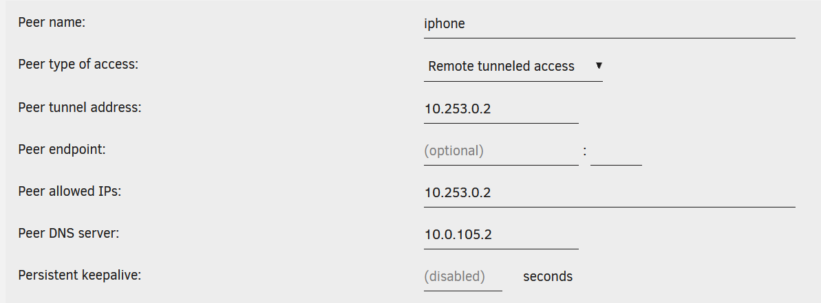

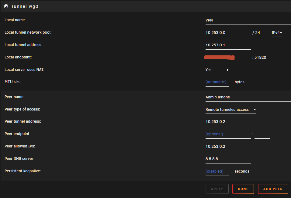

I tried setting this up. I've been using openvpn-as docker with no issues but with wireguard I cannot get the handshake to initialize.
On my iPhone the log indicates:
2019-11-08 14:53:52.110832: [NET] peer(q4nv…iXkg) - Handshake did not complete after 5 seconds, retrying (try 19)
2019-11-08 14:53:52.111139: [NET] peer(q4nv…iXkg) - Sending handshake initiation
2019-11-08 14:53:57.174070: [NET] peer(q4nv…iXkg) - Handshake did not complete after 5 seconds, retrying (try 20)
2019-11-08 14:53:57.174466: [NET] peer(q4nv…iXkg) - Sending handshake initiation
2019-11-08 14:54:02.217420: [NET] peer(q4nv…iXkg) - Handshake did not complete after 20 attempts, giving up
At first I thought it was a port forward issues, I tried enabling UPnP and letting wireguard do its thing but that didn't help. It appears that my client is hitting the service as the data sent/received goes up but no handshake.VPN.thumb.PNG.f1686e186587db2d1ad72f75601d562f.PNG
Any ideas what would be causing this? Are there any logs available within unRAID I can look at?
Thanks.
2 hours ago, bonienl said:
Try to set the MTU size to 1400 and see if that makes a difference.
Just tried it, no luck. I changed it both on unRAID and my iPhone Client.
The odd thing is, I can get it working on a Win 10 Client on my network.
I've been testing with my iPhone with wifi turned off. Would my Cell service be blocking something? (I'm on Bell in Canada)
Update: I can get it working on my iPhone while connecting to the same network as my server (Internally). Looking like my network is to blame. I'm using Google WiFi if anyone is curious.

did you set up your port forwarding? im on telus (canada) and no issues once i set up port forwarding
Thanks.
under the wg0 tunnel Local endpoint: is your public facing IPv4 address
under the peer (your phone) make sure peer end point is the static internal IP of your unraid server
