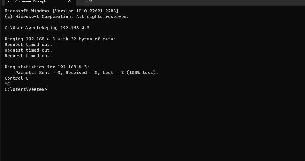

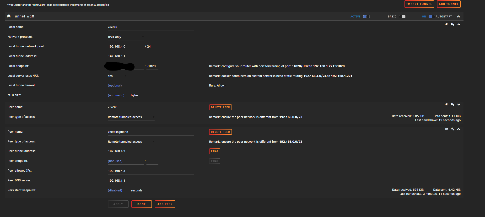

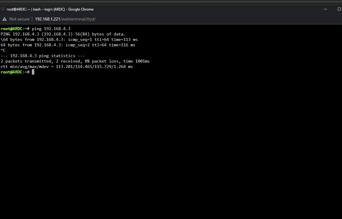

Hello,
I love this thing! thank you for making it easy to use for people like me ha :)
Just one question, maybe someone is in a similar situation.
I have WG setup on unraid  below is the config.
My phone connects just fine and I can access unraid gui (192.168.1.221), and ping hosts from my phone (192.168.4.3 when connected via WG) ,
I am also able to ping my phone from unraid ,
but when I'm trying to ping my phone from another computer on the network other than unraid , it says host unreachable
is there a way to be able to ping my phone from othe hosts on my local network ?
Thank you for your help !

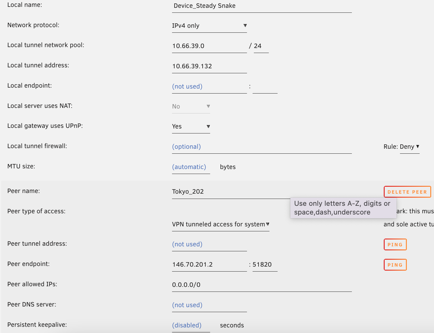

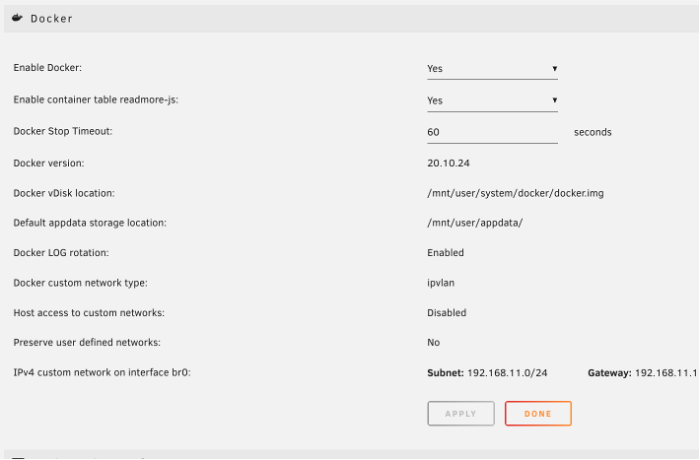

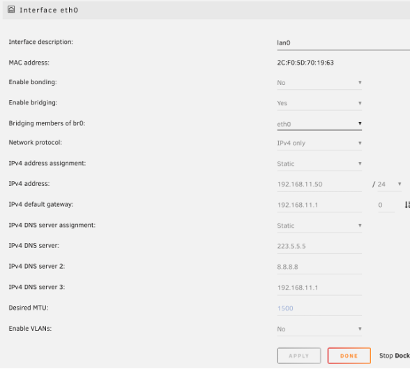

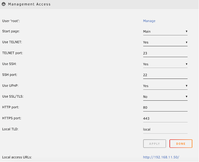

Hello Community
I have been unsuccessful in getting WireGuard to work since my upgrade from 6.11.3->6.12.6, and I am in need of guidance.

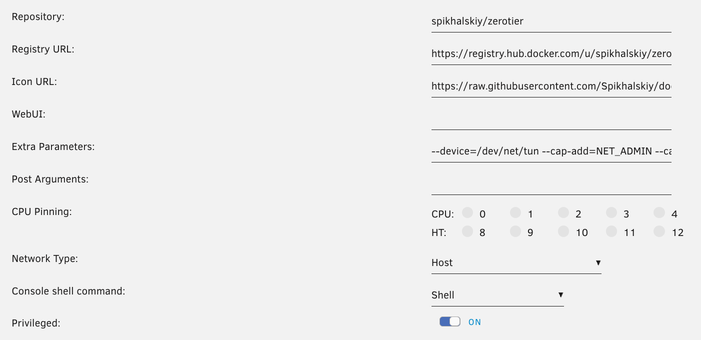

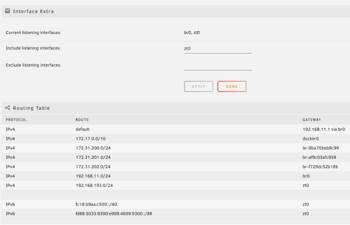

1.  I have been using ZeroTier for remote access into my server and docker UI and access to my network.  Don't really want to give that up.
2.  My goal is to have system VPN tunneling access for updates (I am behind the Chinese firewall and cannot get at Github for plugins w/o VPN.  Dockers are OK).
3.  I also want to have select docker containers (Sonar, etc) running over VPN (not Plex as my experience is that the remote access for playback does not like a double NAT).
I have read through the guides, tried a number of different things, and the configuration below satisfies my goal of using ZeroTier (with complete access to server, dockers, file system) and Plex, but cannot get Wireguard working (No handshakes)
Note:  Need to reinstitute zt0 listening at any docker stop and start, even though is shows in “listening” in many cases.
(Host access to custom networks breaks Zerotier as does using anything other than a HOST network setting in the Docker)

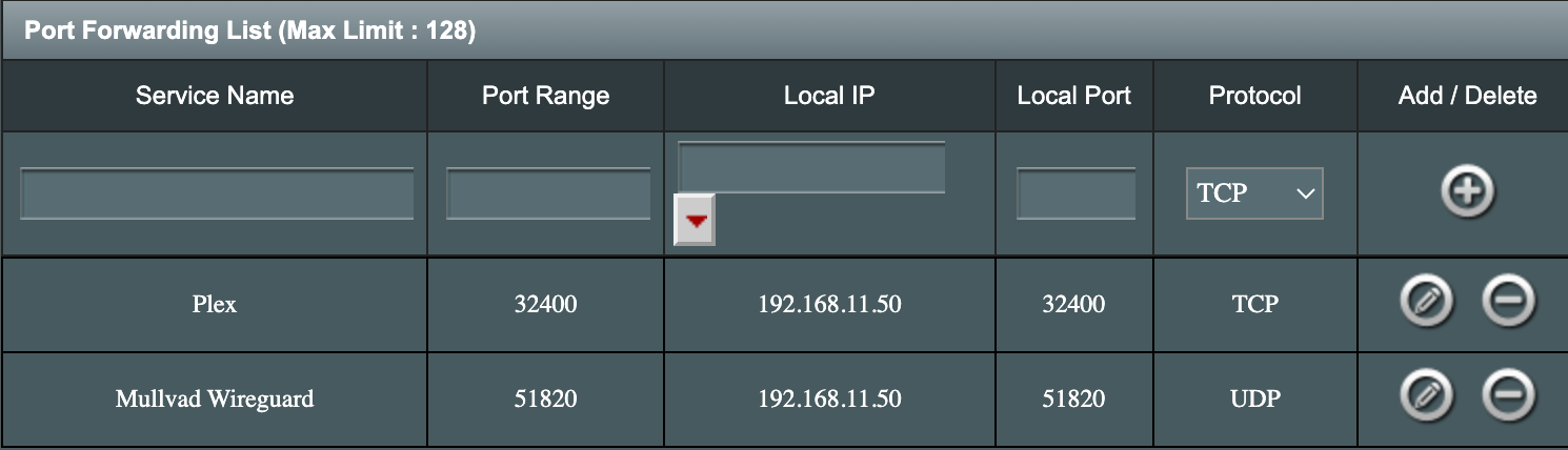

I have enabled UPnP both on the system and on my gateway router:
This is the VPN configuration:
Peer endpoint "ping" is working.
and clicking in the eyeball in with the "advanced" settings highlighted, I get this information:
WireGuard Configuration
Local server configuration
[Interface]
# Device_Steady Snake
PrivateKey=xxxx=
Address=10.66.39.132
PostUp=logger -t wireguard 'Tunnel WireGuard-wg3 started';/usr/local/emhttp/webGui/scripts/update_services
PostDown=logger -t wireguard 'Tunnel WireGuard-wg3 stopped';/usr/local/emhttp/webGui/scripts/update_services
PostUp=ip -4 route flush table 203
PostUp=ip -4 route add default via 10.66.39.132 dev wg3 table 203
PostUp=ip -4 route add 192.168.11.0/24 via 192.168.11.1 dev br0 table 203
PostDown=ip -4 route flush table 203
PostDown=ip -4 route add unreachable default table 203
PostDown=ip -4 route add 192.168.11.0/24 via 192.168.11.1 dev br0 table 203
[Peer]
#Tokyo 202_1
PublicKey=yyyy=
Endpoint=146.70.201.2:51820
AllowedIPs=0.0.0.0/0
Any guidance appreciated.
Thank you in advance.

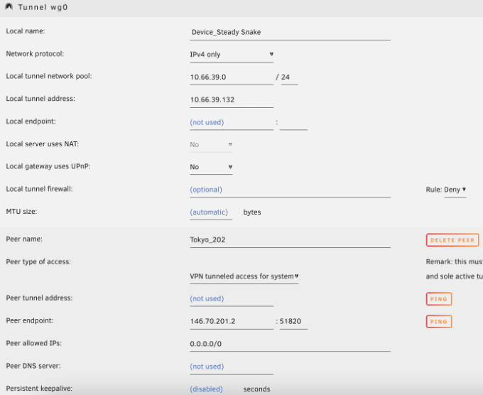

Hi All,
I apologize in advance if this might have been mentioned before, but after doing several google searches with varying search terms and finding some existing reports, none of the troubleshooting steps I came across resolved the issue I am experiencing.
Unraid Version: 6.12.6
Some background,
My WireGuard Client (Peer) was not working (connection would be established but I would have no network or internet access - configuration in WireGuard on Unraid is set to Remote Tunneled Access) and so in trying to troubleshoot, I tried deleting the Peer from the VPN Manager Settings in Unraid (among other things). Upon re-creating the Peer in Unraid, I am no longer able to download the Peer Configuration. The eye icon is greyed out.
In reading some of the other reports on this issue, there are some instances where WireGuard wasn't deleting the old Peer Configurations from the Flash Drive Config Folder and this was causing some issues. For my situation, the Peer Folder on the Flash Drive is empty even though the VPN Manager in Unraid shows I have a Peer setup.
I also tried deleting the Tunnel and peer while monitoring the Config Folder and see the Tunnel configuration gets deleted (there is no Peer data to delete so that folder stays empty), and when I create a new Tunnel, I see those configuration files generated in the Config Folder as well.
I'm left scratching my head trying to figure out what's going.
Any help is greatly appreciated!
UPDATE: Resolved
It appears the issue manifests if the Peer Name field is left empty. This seems like it is a bug since the default configuration settings indicate the Name Field is Optional.
Gonna leave this post in case anyone else encounters the issue too so they can try what worked for me to see if it helps them.

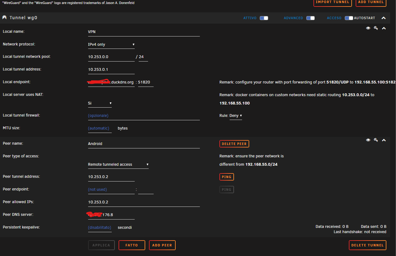

good morning everyone, I'm trying to configure Wireguard to connect externally but to no avail.
can someone help me?
I put my configuration.
Thank you
Thank you
Make sure that if you have a modem
from your ISP that you enable bridge mode. I had an issue a while back where I replaced my router. And my wireguard worked for all of about 2 weeks.  Well come to find out my ISP pushed out an update to their network which in turn reverted modem back to default settings. So I needed to go back in to enable bridge mode and it worked like a charm.
