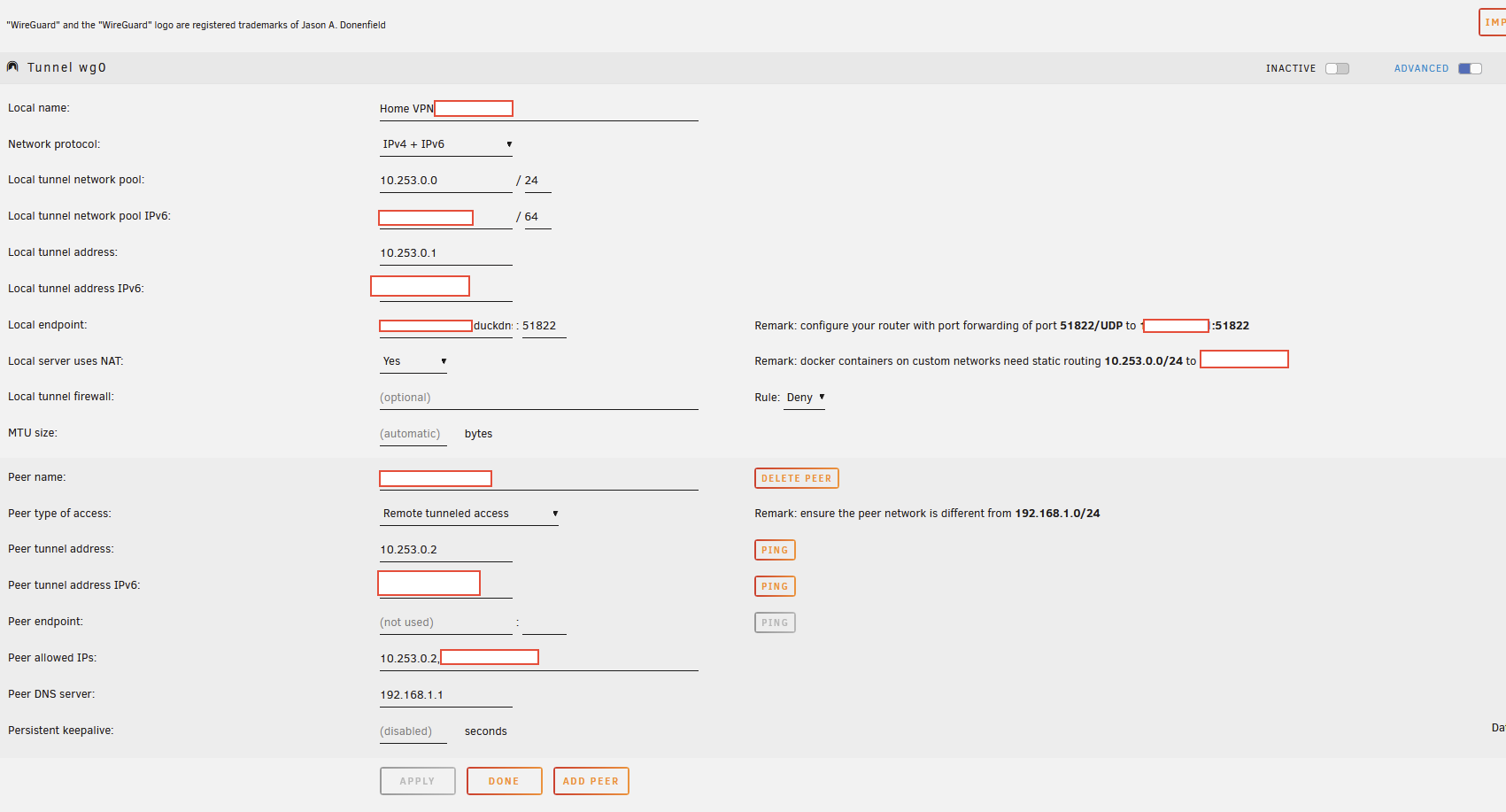

Issue: After many months of smooth sailing, I can no longer access the web when connected to WireGuard, I only have access to the LAN (Unraid Dashboard plus dockers, even those on their own IPs).
Desired behaviour: I want to route my mobile traffic through Unraid and my pi-hole when remote, like I had it going before, via Remote tunneled access.
  • Everything was working fine for months, then it suddenly stopped working
  • Changes to the server prior to the issue:
    • Upgraded from Unraid Plus to Pro
    • Added new parity drives and disks
    • Changed docker network type from macvlan to ipvlan (tried changing back, doesn't seem to be the cause)
  • Handshake and ping successful
  • Wireguard is on a different network pool, as required
  • Unraid v6.10.3
I've tried rebooting Unraid, switching back to macvlan, re-configuring Wireguard from scratch, using 8.8.8.8 as DNS instead of the router's DNS. None of that worked. Port forwarding on the router is correct; as mentioned, I'm able to connect to the VPN, but then just can't access anything external.
Here's my config, for what it's worth:

On 8/23/2022 at 2:24 AM, Refrigerator said:
Everything was going great until it wasn't...
Hoping someone might have some insights – did a lot of Googling, but have hit a wall.
  • Unraid v6.10.3
98516770_ScreenShot2022-08-22at5_21_08PM.thumb.png.ebd4ffea25f627de737ce5d69dc603c7.png

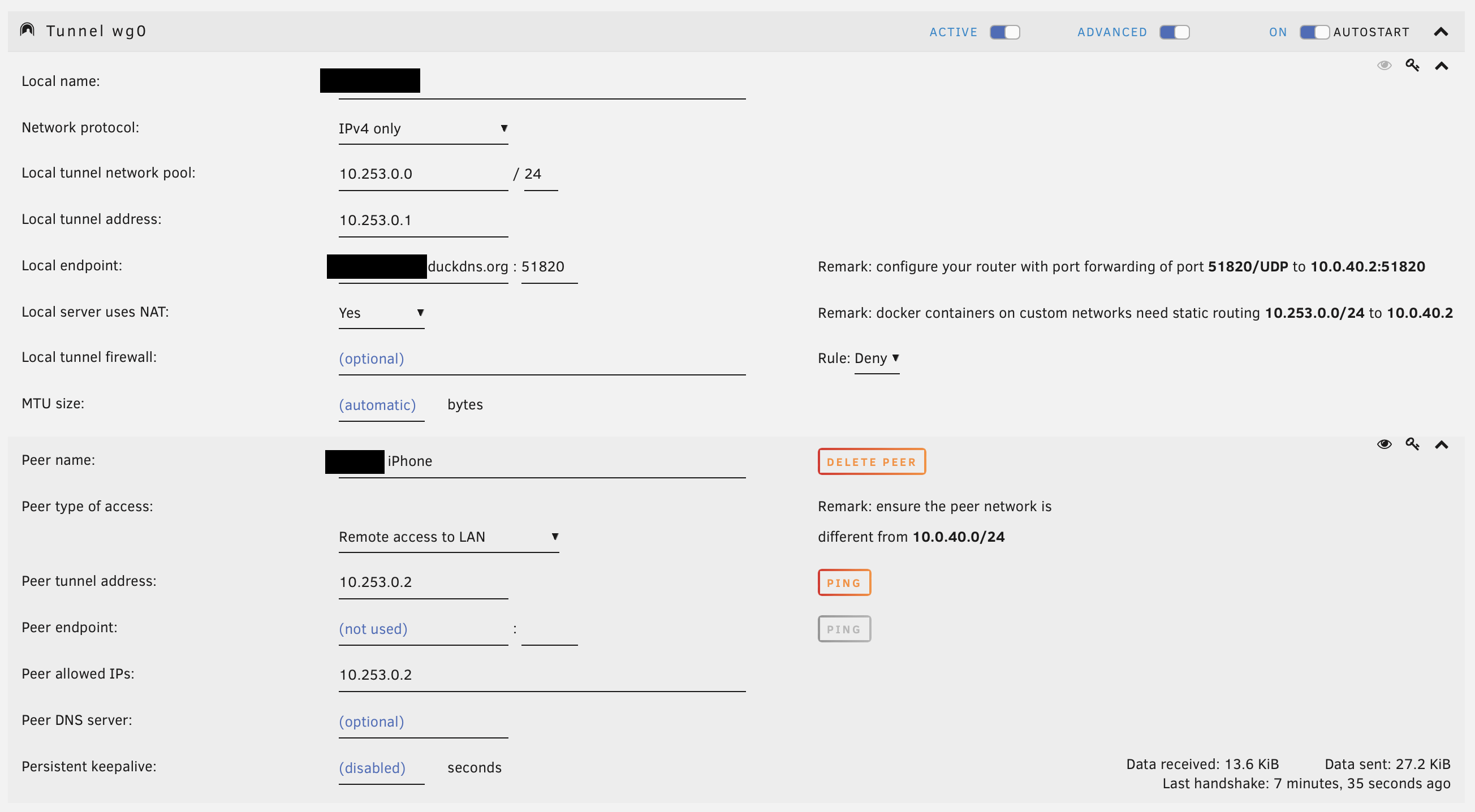

I set up Wireguard and added a peer (Remote access to LAN). I can successfully reach all of the devices that are on the same network as my Unraid Server. However, I can not access any of my devices on my other networks. There are no firewall rules preventing traffic between my networks and I confirmed via Terminal that the Unraid Sever itself can ping all of my other network devices.
Wireguard Configuration:
1320383704_Screenshot2022-11-03at12_34_49PM.thumb.png.b43b225974fe256a2c0ddea66d746ff4.png
My Unraid Server is on 10.0.40.2. When connected via Wireguard I can reach all devices that are on the same network address (i.e 10.0.40.112) but I can not reach devices on any of my other networks (i.e. 10.0.50.2)
Have I configured something wrong? The Unraid machine itself has access to all of those devices. Why can't I access them when connecting to the server via Wireguard?
