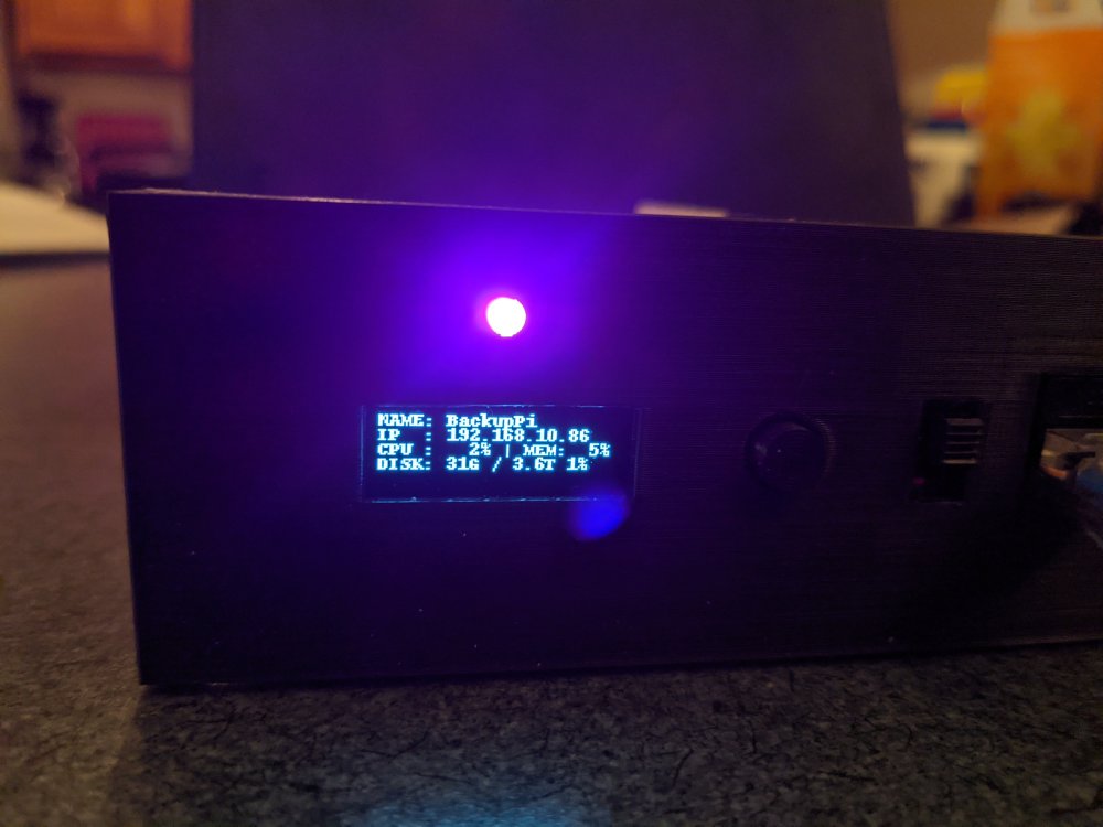

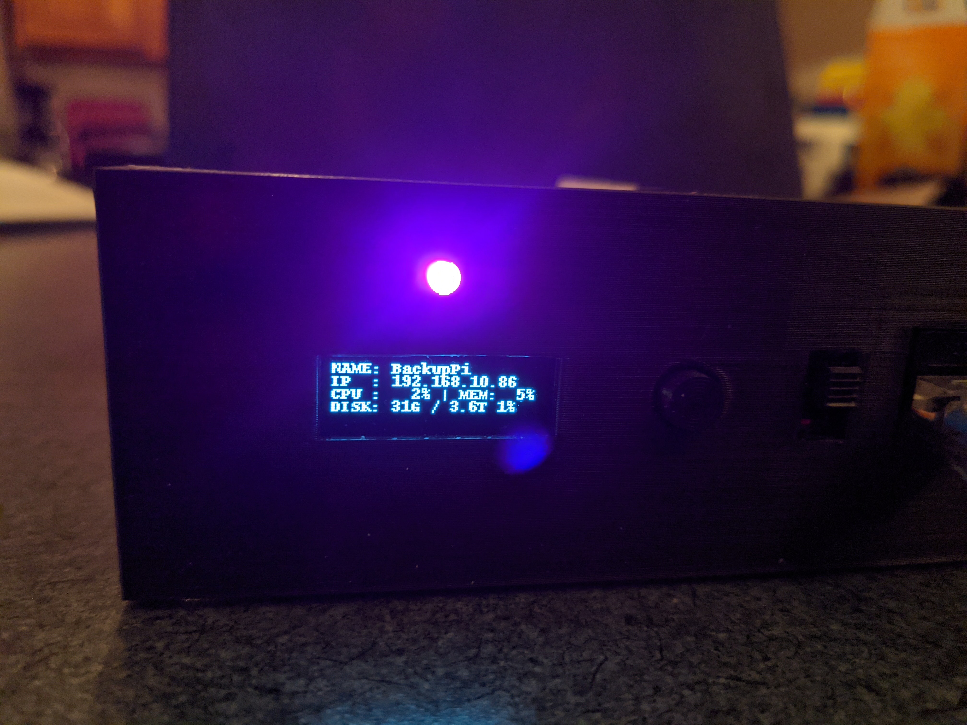

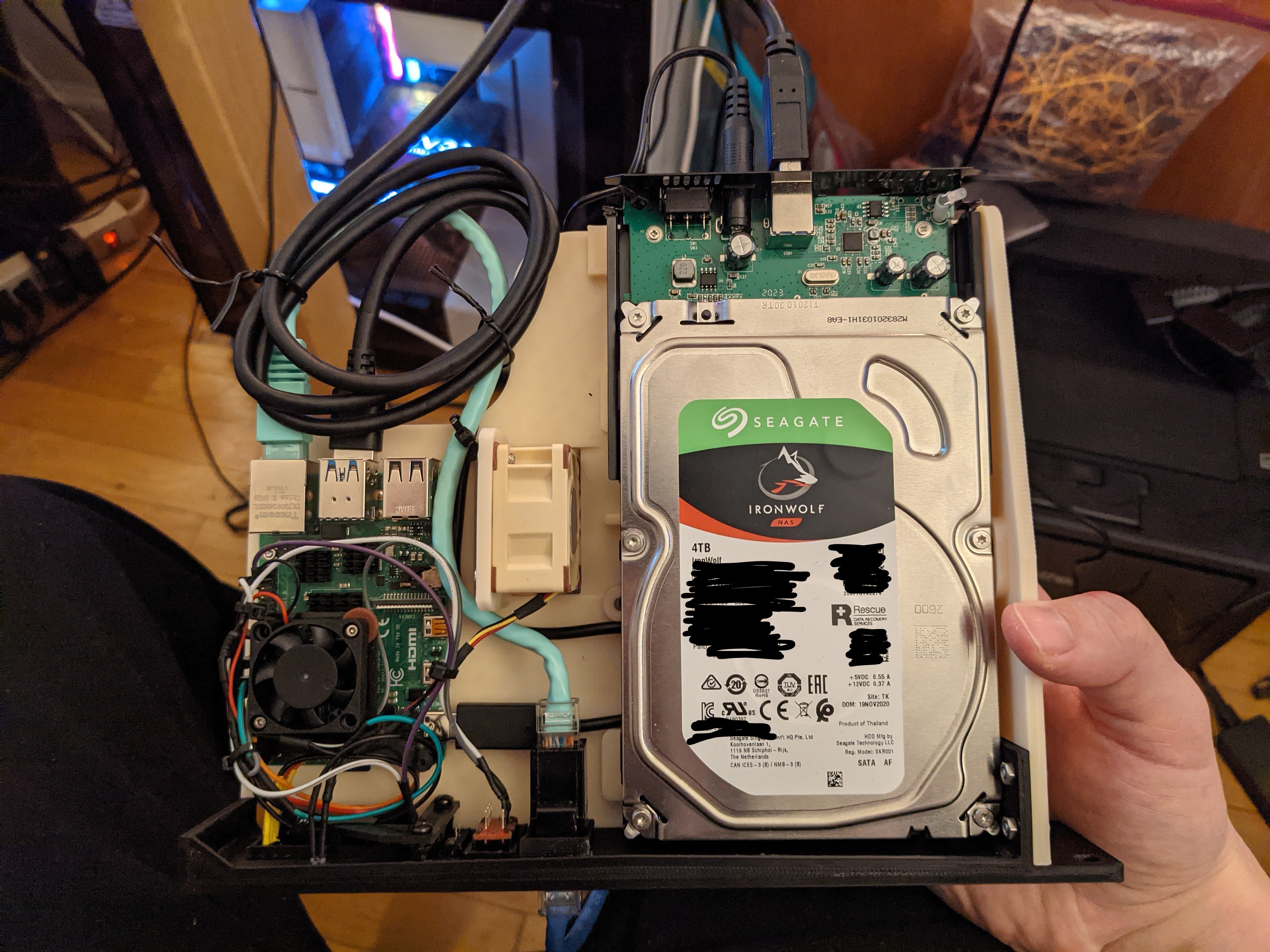

I have a fancy little OLED screen for this little server running a python script. And I know I'm going to break it if I install a new OS  😂
Attaching a couple images of my little 3D printed mount...

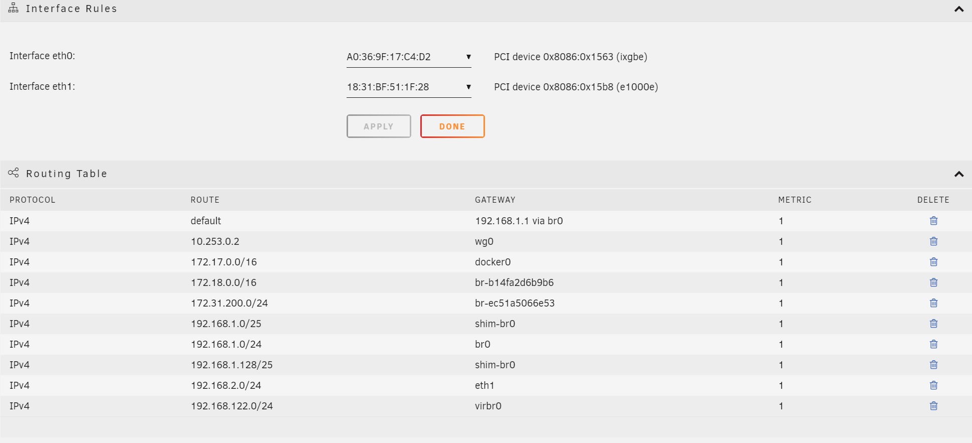

QUESTION:
Why cant this route be added directly inside Unraid? :)
Like in the "Routing Table" section.

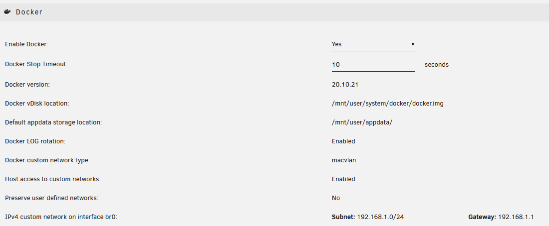

I am trying to use Wireguard with a "complex" network where I have dockers running with a br0 network type.  Wireguard is working, I can access most of my LAN via VPN, but I cannot access these dockers, like Pi-Hole.
I have followed these directions:  "With "Use NAT" = No and "Host access to custom networks" = enabled and static route " - the last item being creating a static route on my Unifi USG router through the Unifi Controller software.
Any advice on how to troubleshoot this problem?
Seems like this would do the trick. I would probably start by double checking the static route and making sure there is nothing in the router that is firewalling the traffic. Also make sure you haven't inadvertently blocked anything with the Local Tunnel Firewall in the WireGuard config.

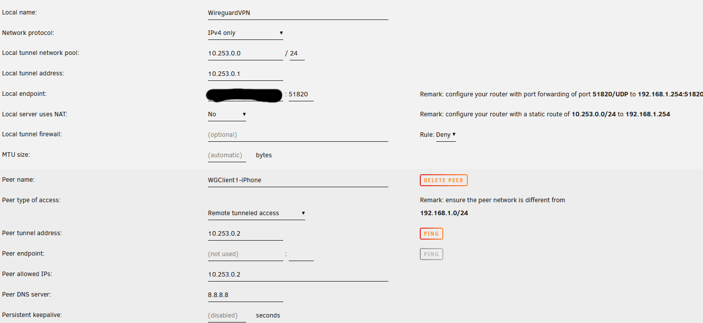

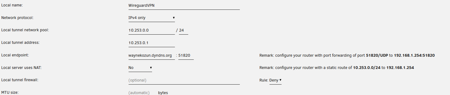

Here is the Wireguard config.  Should that Local tunnel firewall setting be changed?
Here are my settings for Wireguard, my static route on my Unifi router and my docker config.
On the static route, why is the distance set to "2"? Try "1".
I will try changing that.  I was copying what I saw from someone else's configuration.
I changed the hop distance from 2 to 1 but that does not help, I still cannot access my br0 dockers.
Is the peer file on your iphone current? It needs to be manually updated whenever you make a change to the wireguard config on the server.
No, I am using the OG config file. I will try that and see if it helps.
