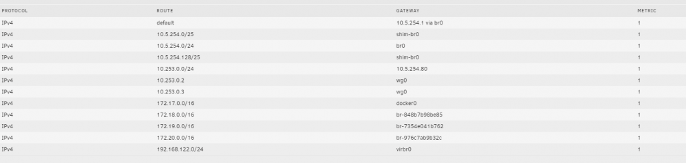

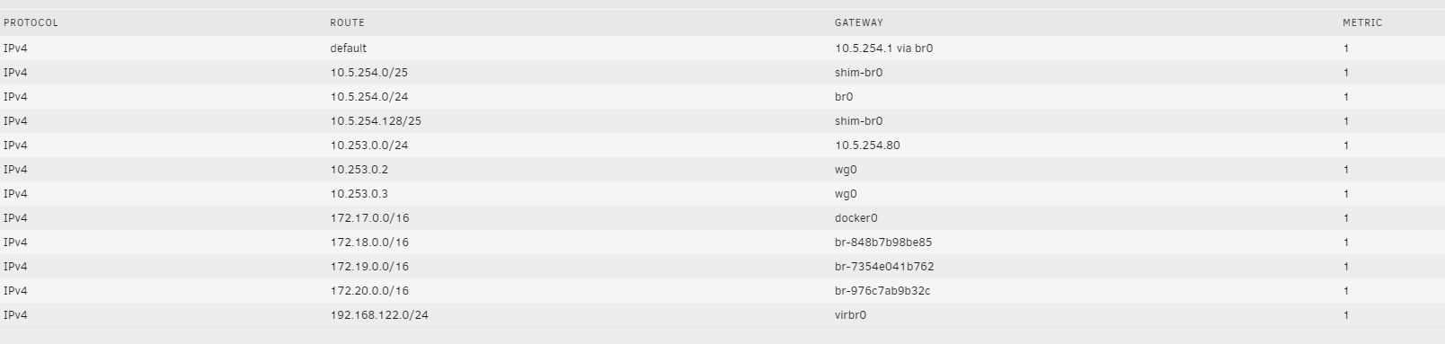

I am having no issues to connect to my server via wireguard, but i can't connect to dockers on my network
46 minutes ago, mgadbois said:
Seems I am missing a route somewhere, but can't figure it out.
Sounds like you need to add a static route to your *router* so that devices on your network can communicate with the WireGuard network pool. See the "Complex Networks" portion of the first post in this thread.
If you continue to have issues, read the section below that that explains how "Use NAT", "host access to custom networks", and having a static route all interact. Certain combinations do not work well together.
Added static route in my Router and all works now.

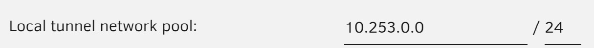

You'll want to ping the tunnel IPs, not the lan/wan IPs.
The tunnel has its own network range:
The server usually has a .1 address in that pool:
And then each peer has a unique address in that pool:
