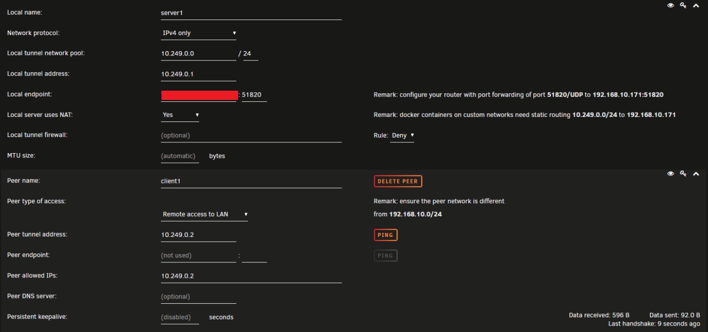

Well it was already on Remote access to LAN
I can connect but i can access only the unraid server and nothing on the lan
Edited by exico
added screenshot
Are you sure the peer has the correct configuration? It needs to include your LAN subnet.
You need to set Local server uses NAT = Yes
This allows other devices on your LAN to communicate over the tunnel to the remote peer.
If you are trying to access docker containers on their custom network address, you will need to do additional steps, which are explained in the Wireguard guide.
Yeah, my config includes allowed ips:
[Interface]
PrivateKey = REDACTED
Address = 10.249.0.2/32
[Peer]
PublicKey = REDACTED
PresharedKey = REDACTED
AllowedIPs = 10.249.0.1/32, 192.168.10.0/24
Endpoint = REDACTED:51820
NAT is on Yes as per screenshot
What I'm trying to access is something. I tried the server ipmi, the web interface of the switch, pfsense interface on the router. Nothing pops up, just the unraid works and shows up
Everything worked fine before...
What IP address are you using to access the server from the peer side?
Is this 10.249.0.1 or 192.168.10.x ?
Im using 192.168.10.171
The wireguard configuration of wg0 is alright.
You said that you have configured multiple tunnels.
Have you tried testing with only one tunnel active at the time?
I did not, just tried and nothing changed.
Just an hypotesis, can the setting "Host access to custom networks" set to enable in the docker settings be a problem?
I will have to wait to stop dockers to test this atm cause there is a task running
It should not, but please test.
Host access is a hack to circumvent the network protection of docker itself. Normally host access is not required and should be disabled.
Disabled "Host access to custom networks" and now i can access everything except one docker but i will figure it later
