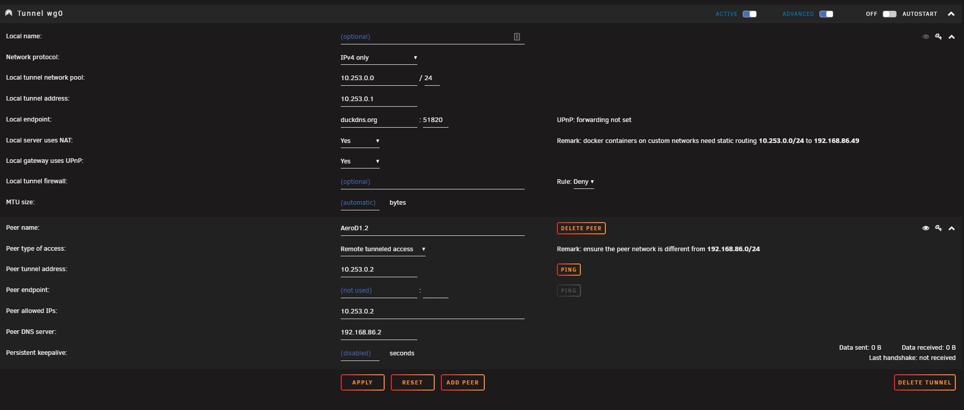

OK, I have been reading posts for 2 hours now and dont see where or what i messed up.
I have DDNS setup with a new url just for wireguard. i use pihole and did input my pihole LAN IP in the config. I have tested on my phone(cell network) and my laptop(on cell hotspot-cell network)
both seem to connect fine, but nothing loads (public sites nor LAN sites). I notice in the client log(both on windows/laptop and android app) that its sending the handshake attempt multiple times. i see on the unraid dashbaord that there is no handshake. I can post screen shots as needed and would love to use this instead of openVPN.
Any help or guidance is greatly appreciated.
