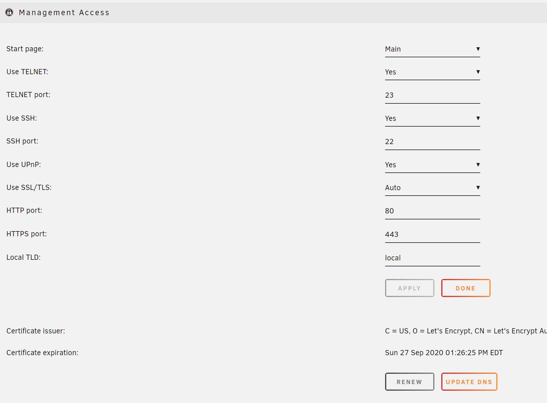

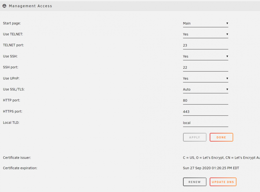

I was able to install and setup WireGuard plugin (2020.02.23) on my server and I was able to get my iPhone to connect to the VPN using the wireguard app and . However I am not able to access the server URL via chrome on the phone to access the server. When I try this phone on the cell carrier, not on wifi.. but stil no luck. I have tried url 10.253.0.0, 10.253.0.1 and 10.253.0.2 with no luck. Am I not using the correct url?
I am running version 6.8.3 with a certificate on the server, which creates this type of url "https://xxxxxxxxxxxxxxxxxxxx0f70a3509e8cda340.unraid.net/Plugins". My disk are not encrypted.

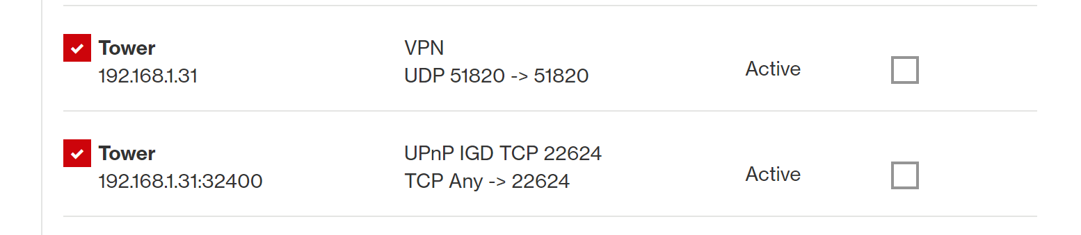

I have done the port forward, I believe correctly on my FIOS router.  the 32400 is for my Plex.

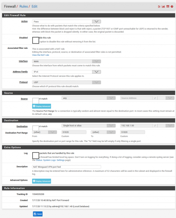

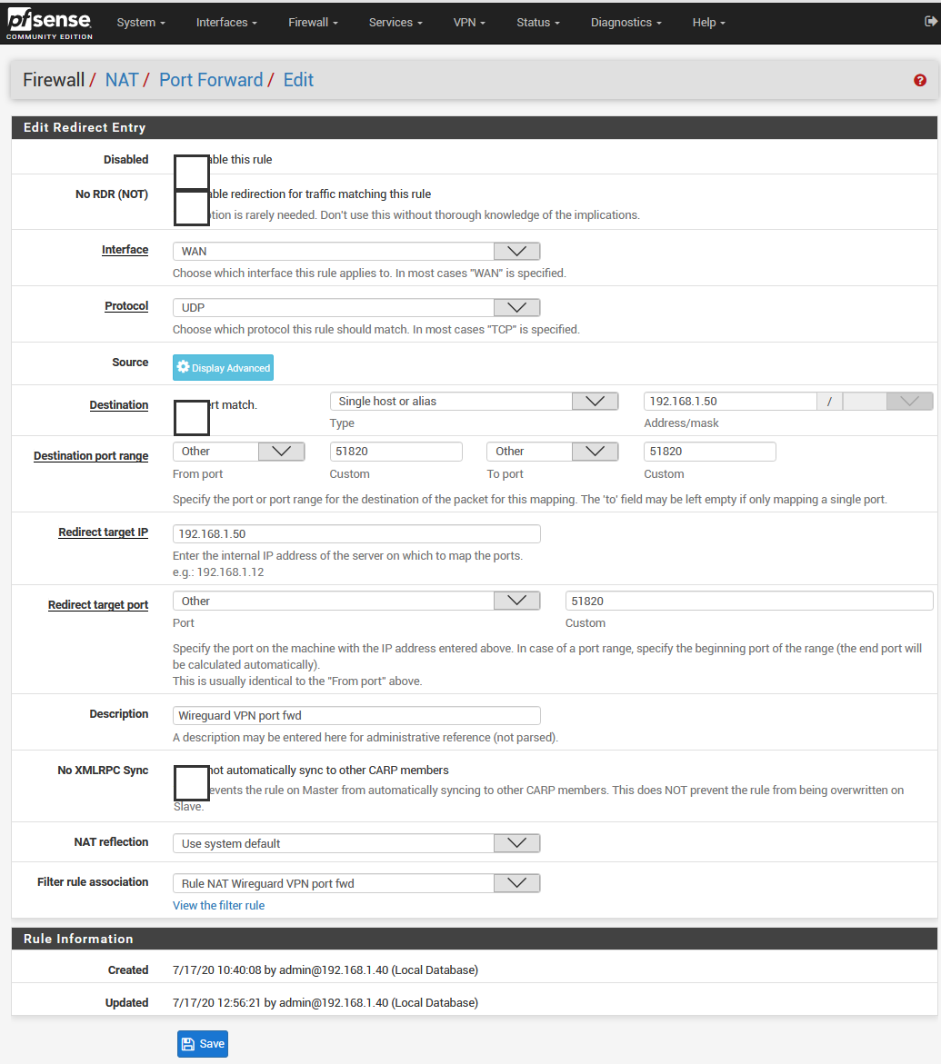

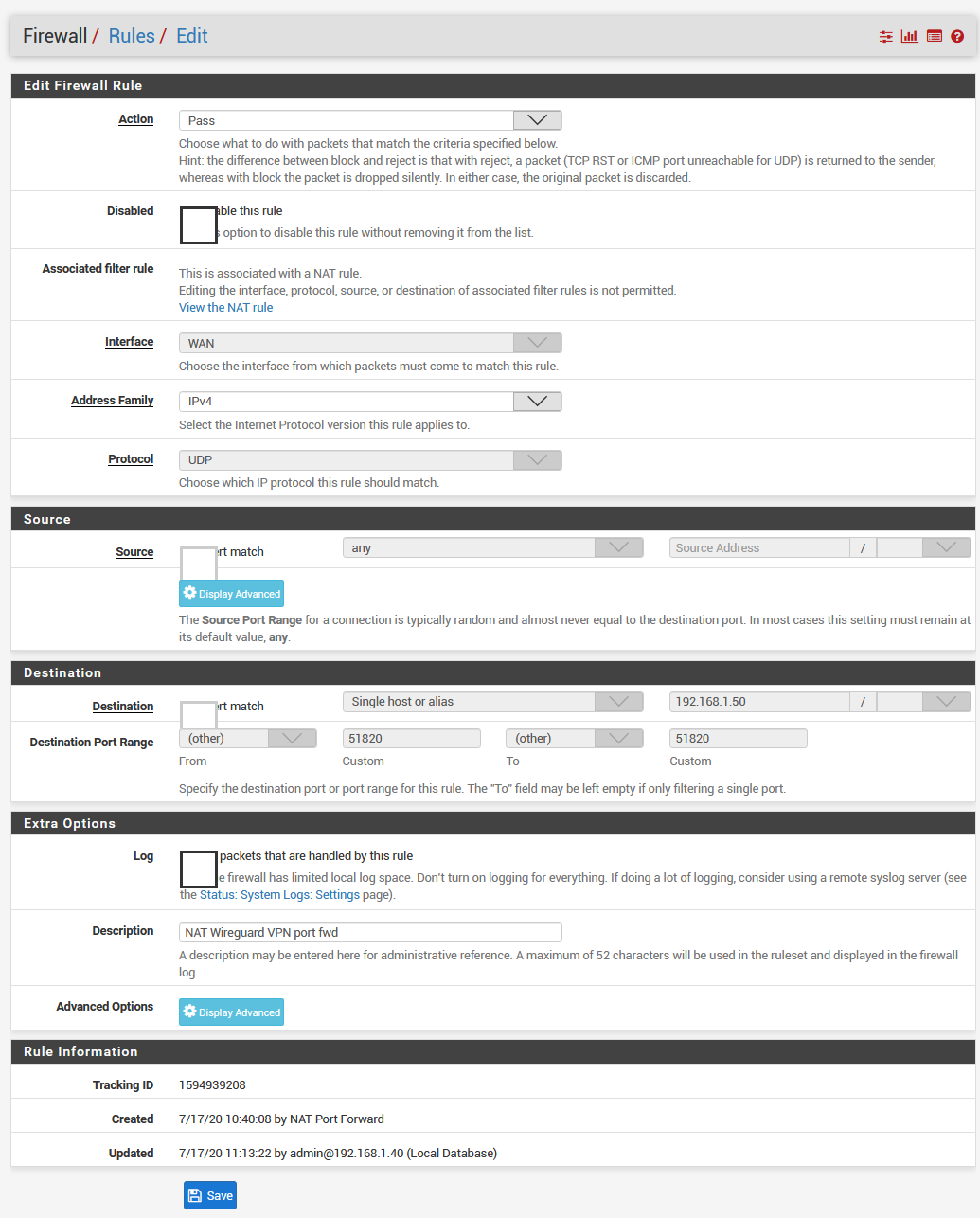

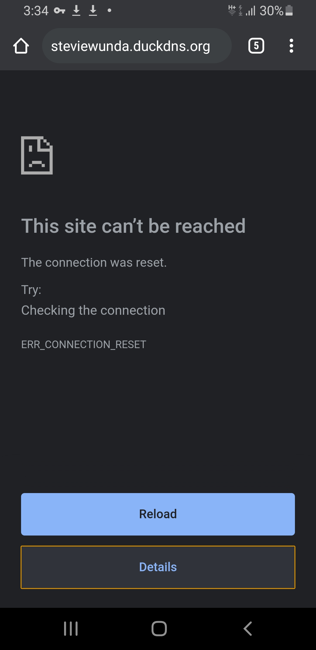

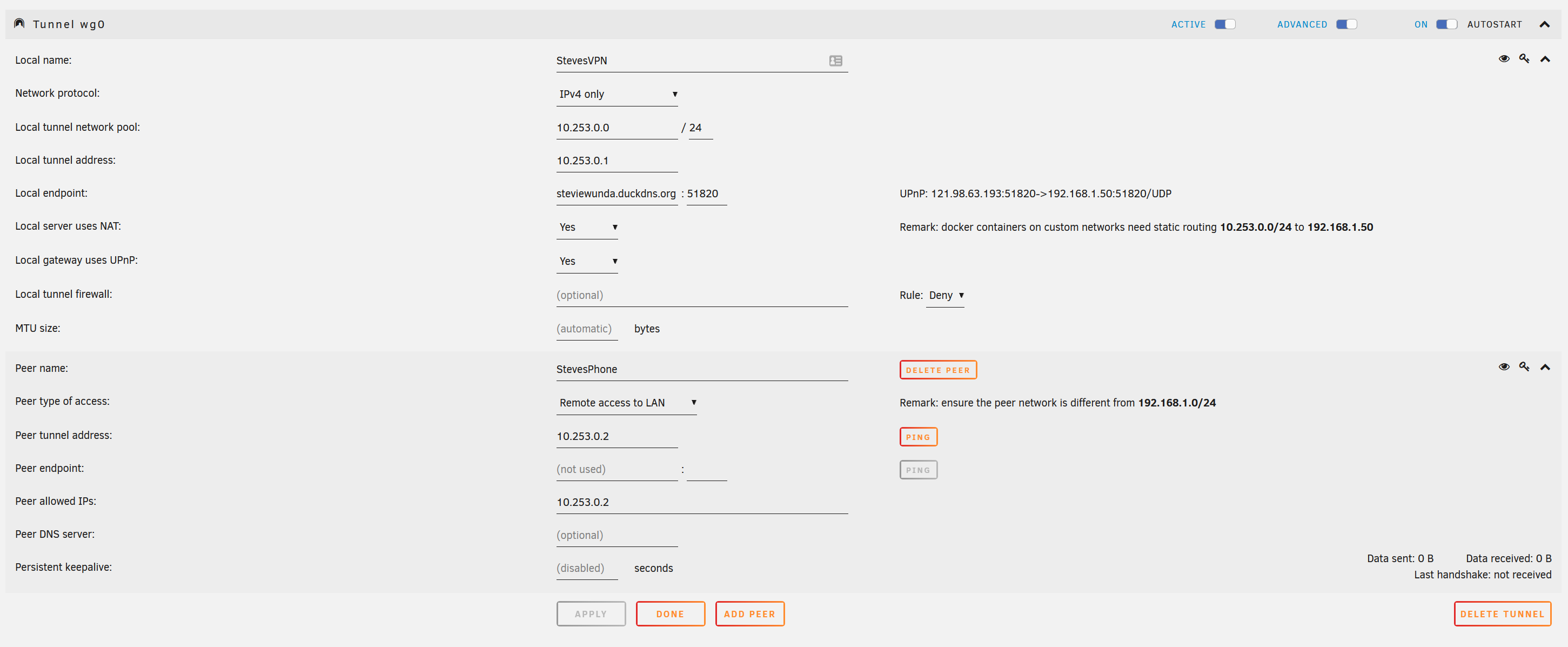

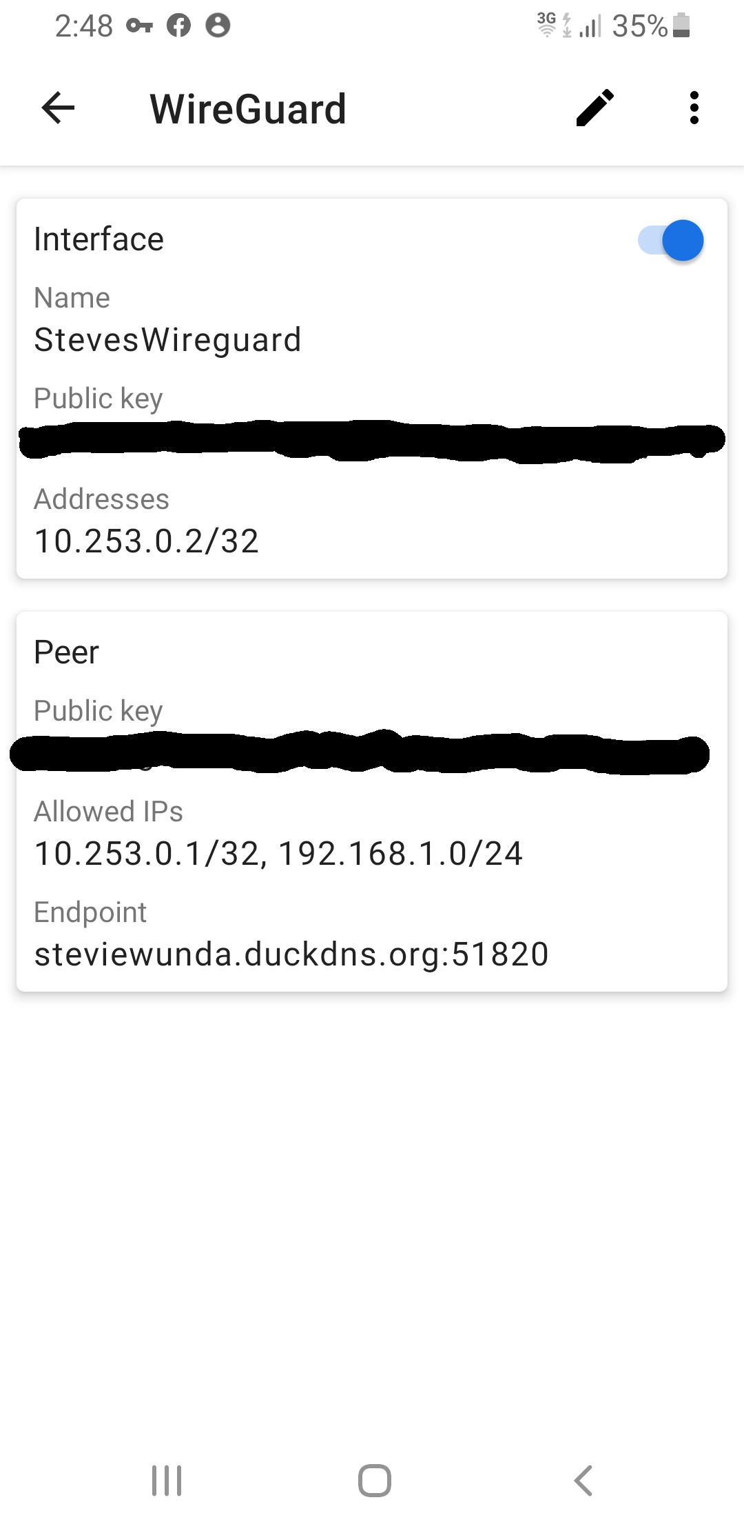

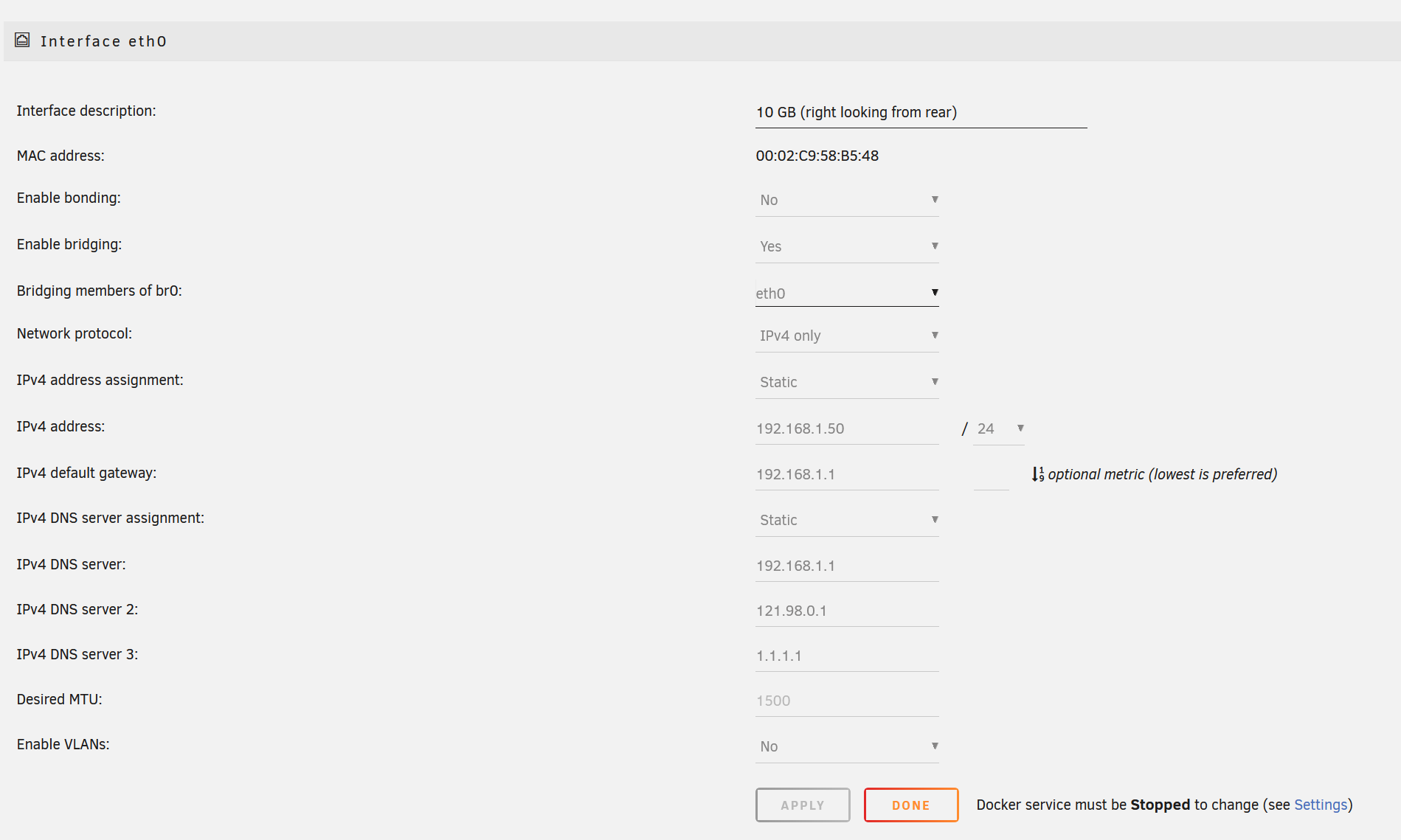

Hi - I would appreciate any help to troubleshoot my Wireguard connection via Pfsense to Unraid. I have tried all the troubleshooting steps on page 1 with no success. I have been trying to connect using my Samsung Galaxy S9 with wifi disabled (data comms only). My pfsense ability is limited - I have not been able to detect any attempts to access the router by Wireguard using packet capture, but I may not have set this up correctly.
Screenshots attached - please ask if more are needed
32 minutes ago, Steviewunda said:
You are using the wrong url here :)
Once you have started WireGuard on your phone, open your browser and visit:
   http://<unraid internal ip>
(Note: since we are going to an ip address, it must be http not https. That should then redirect to the proper url.)
Yep that did it thanks very much!!! - I was under the impression that I had to use the duckdns address to circumvent problems with dynamically assigned ip addresses?
If you look at the WireGuard client screenshot you'll see it connects to the duckdns address.  Once the connection has been made you use the network pretty much as if you were physically one the network.
Thanks again ☺️

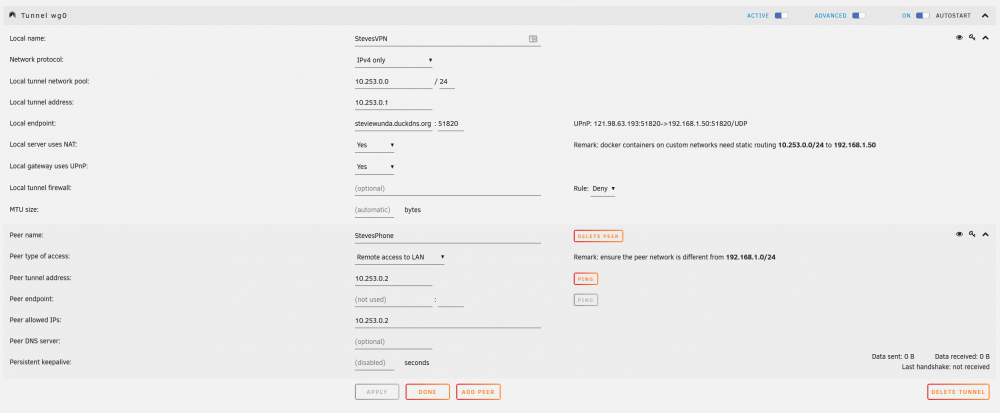

One more question that google has not been friendly for - what setting do I need to change to access my LAN? Should I add 0.0.0.0/0 to my 'Peer allowed IP's' ?
Change the "Peer Type of Access" selection.
I already have it set to 'Remote access to LAN' - what should I set it to?

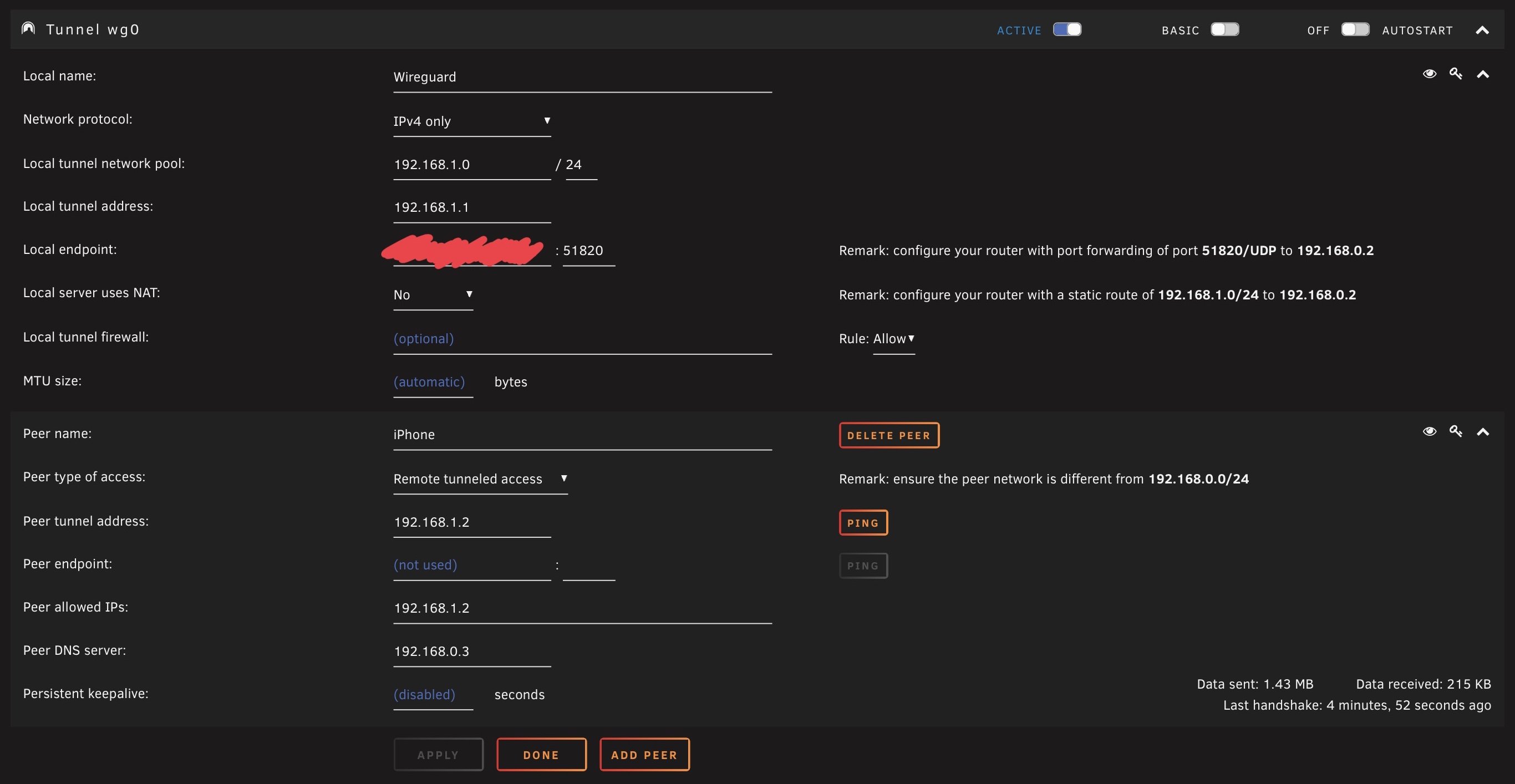

Hi! I am struggling to get my Wireguard client to access the internet through my VPN.
With my client, I can ping my Unraid server, ping docker containers, ping other devices on my LAN, and use my local DNS resolver to correctly resolve hosts. From other devices on my LAN, I can ping my client through its VPN address. From my Unraid server, I can connect to the internet. However, I cannot connect to the internet from my client (I cannot ping 8.8.8.8) or connect to my LAN through its external IP.
My Wireguard configuration is attached as an image. I have enabled Host access to custom networks in my docker settings. I have created the static route and port forward in my router (Archer C8).
Update: I got a traceroute to 8.8.8.8 from my client. The connection goes to my Unraid server’s address in wg0 (192.168.1.1) then to my router (192.168.0.1). So I suppose that my router is probably refusing to forward/NAT traffic outside my LAN subnet. Connections to addresses on my LAN don’t need to go through my router, so it makes sense I could only get to those addresses. Any help would still be appreciated.
Update 2: It was in fact my router’s fault. Unfortunately, on the Archer C8, there is no way to get into the configs and allow it to forward packets outside the LAN subnet. I also can’t find any CFW for the C8v4 either, so that kinda sucks. If anyone else runs into this same issue (doubtful), the solution is to host the DHCP server off of the router. Then, you can set the DHCP subnet and the subnet the router uses separately.
Update 3: To be clear, on the Archer C8v4, you need to set the LAN subnet to contain both the desired LAN subnet (e.g. 192.168.0.1/24) and the Wireguard subnet (e.g. 192.168.1.1/24). I tell the Archer to use 192.168.0.1/16. Then, your DHCP server should give out the desired LAN subnet (e.g. 192.168.0.1/24). I only say this because I hit the same problem again, forgot the solution, and then became confused as to why I was saying DHCP servers had anything to do with it.

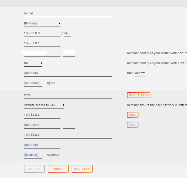

Not connecto to unit network Drive
I have a little problem, with WG Plugin, all ok, accesing to the LAN  ( http and https) but when connect to unit network, is not possible.
I select in the WG " Remote access LAN"
Select "Remote access to server" as profile.
At the peer side, it is possible to access (only) the Unraid server by its wireguard address 10.253.0.1
When you use the profile "Remote access to server", then all traffic will follow the normal route as before.
Make sure the peer (your sister) uses the correct configuration which is generated with this profile.
7 minutes ago, Alex.b said:
With this option, she can access to all dockers url ?
Yes
Each device is another peer. You can add peers to the tunnel and give the same or a different profile to these peers.
One restriction: "VPN tunneled access" must in in its own tunnel and not be shared.

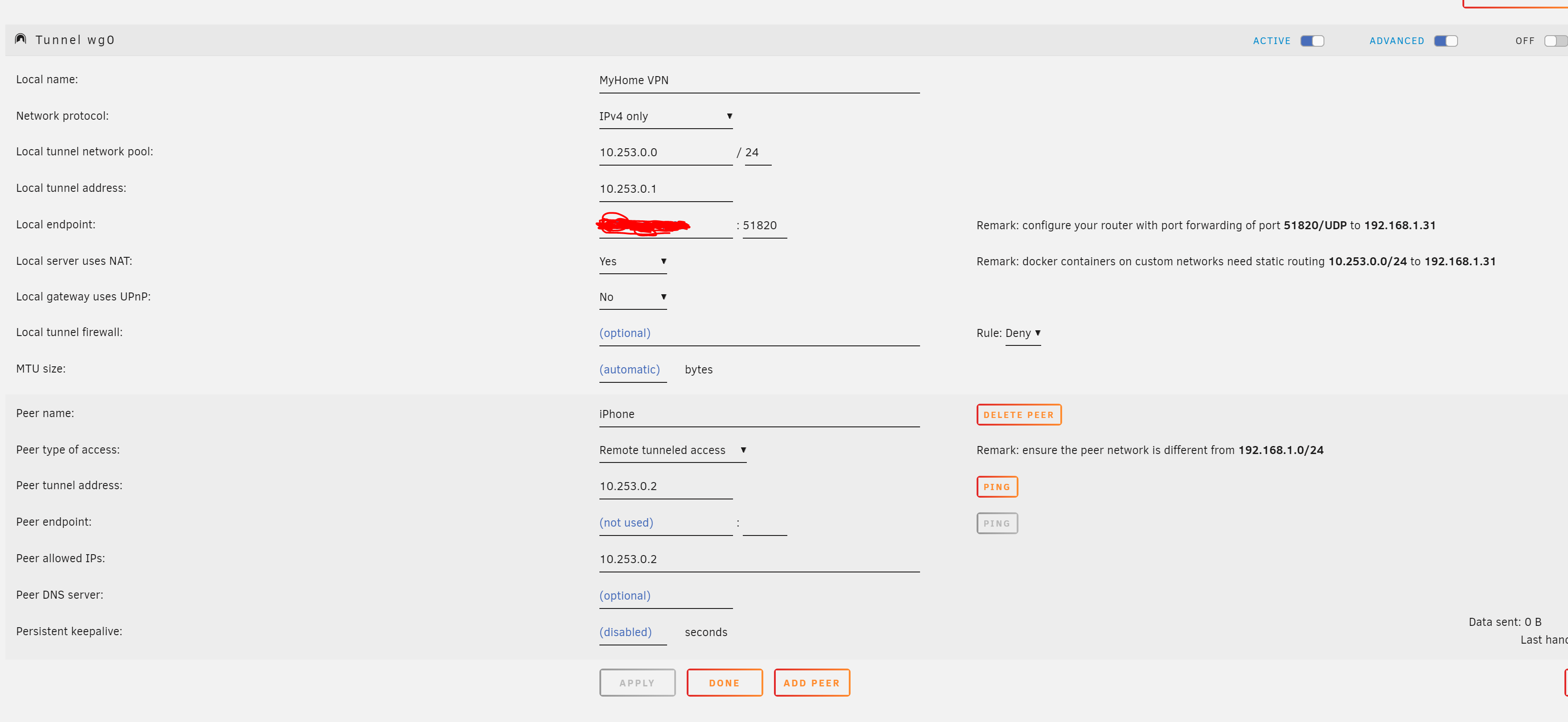

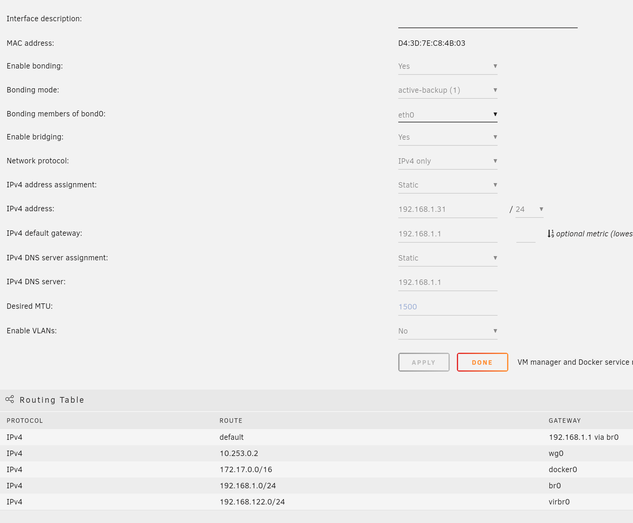

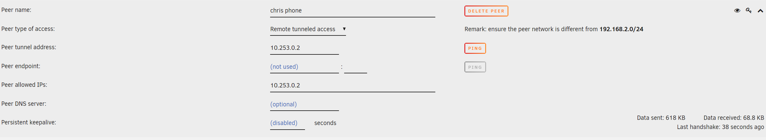

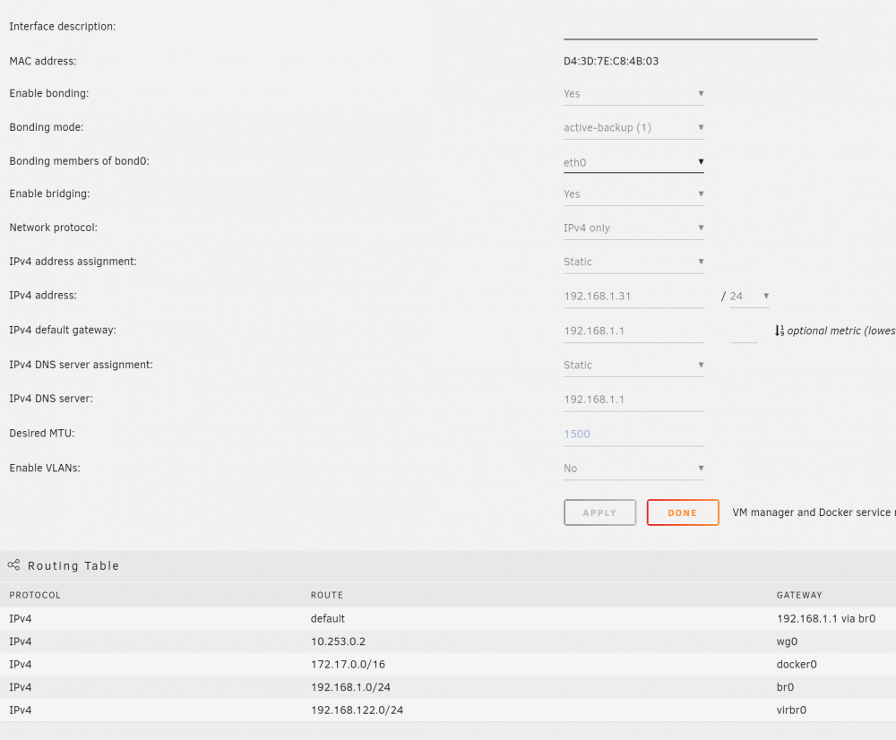

On 10/12/2019 at 4:58 PM, blackrabbit said:
@ljm42 I have attached some screenshots that show what we are talking about.
1. Active Connection on Phone
2. Connection timed out when I tried to reach the unraid server.
3. Settings for WireGuard
4. Dashboard VPN module
I am having the same issue.
Those screenshots show that the WireGuard client is not able to communicate with the WireGuard server on Unraid. The most likely cause is an issue with the port forward through the router (that was the issue the person you quoted had). You can also check the "troubleshooting" section of the guide for more ideas, I've tried to consolidate the list of potential issues/solutions we have found there.
