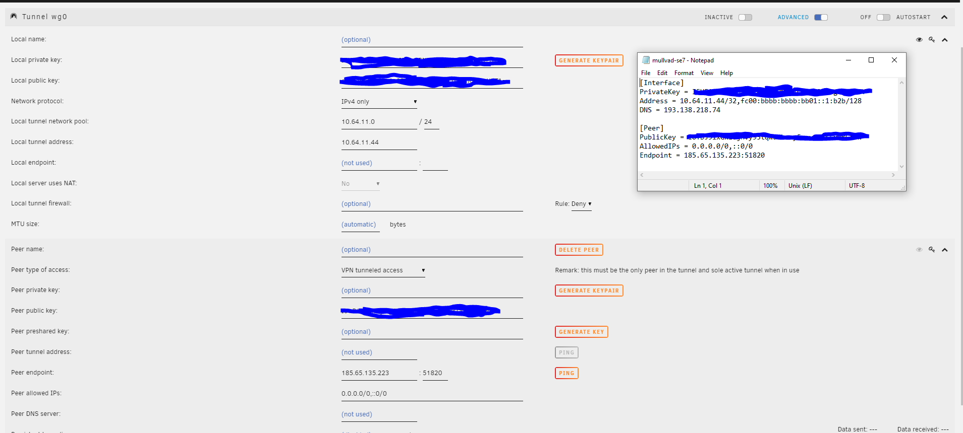

Can anyone tell me what I am doing wrong ? I signed up with an VPN-service that offers wireguard (mullvad.net) and downloaded the config.file and imported it. But wireguard does not connect.

49 minutes ago, bonienl said:
Remove the IPv6 addresses from the configuration file and test with IPv4 only.
That! And set the little inactive switch at the top to active

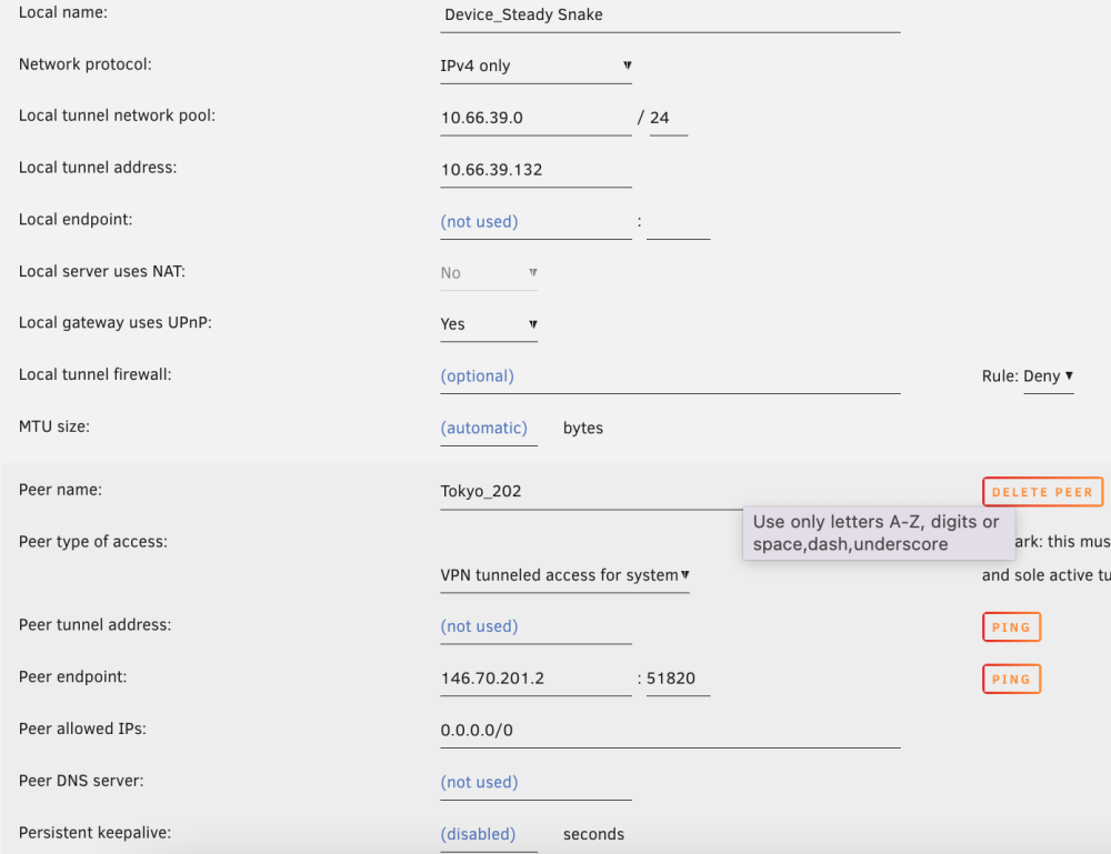

Is there a way that I can connect unraid to a Wireguard VPN and route all traffic from my unraid through that?

Removing the ipv6 from the config-file made no difference. When I flip the inactive-button to active it resets after clicking "done"
This is the thread you are looking for. It is linked in the OP:

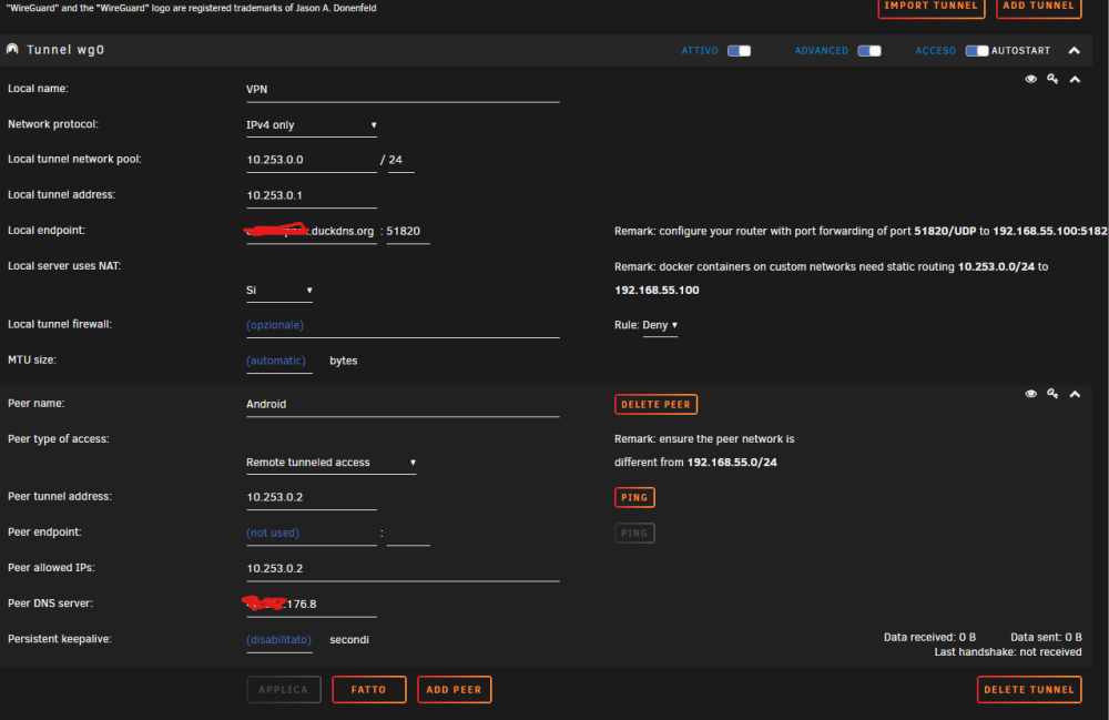

Well I did the update last night to Unraid and while configuring wiregurard I am I have loss all web access to my unraid server and not trying to figure out a way to stop it or remove it from terminal access via Supermicro iKvm into since I have neither keyboard and or video from directly connect.  What freaken way to start a Saturday morning.......should know better to do an update.

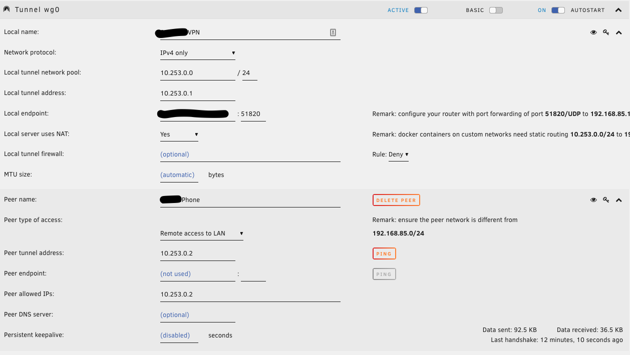

Ran into a weird issue after upgrading to 6.8.3 and was hoping someone might know what went bad. When I connect to Wireguard from my phone or laptop outside of my network I am unable to access my VMs with RDP or Splashtop that are inside the network. My main VM is located at 192.168.85.112 and the unraid server is located at 192.168.85.111.
It seems like the NAT isn't working properly. Initially I had a lot of networking issues after upgrading so I deleted by network config and rebuilt it, and this fixed most of my issues. It seems like the RDP applications aren't making the link from the 10.253.0 subnet to the 192.168.85 subnet. This was working without any issues before I upgraded to 6.8.3, so I'm not totally sure what could have happened. Thanks for any help!
1097271641_ScreenShot2020-03-11at2_37_34PM.thumb.png.c9bcb3a746aad914a8b5cbe8da4c0e79.png

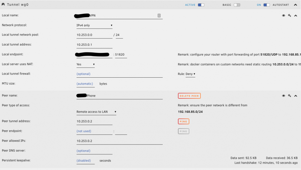

Small followup to my last post. It seems that with the Remote Access to LAN setting I am not actually able to access anything on the LAN. I checked that bridging is enabled and I can ping the server on both 10.253.0.1 and 192.168.85.111, but I can't seem to ping any other devices on the network. I downgraded back to 6.8.2 hoping that might help, but it doesn't seem like it changed anything.
EDIT: So I reinstalled the OpenVPN AS docker container just to see if that would work, and connecting through that gives me full access to the whole LAN, so the issue is only occurring with wireguard on my server. I guess OpenVPN isn't a bad backup option, but I liked how lightweight wireguard is.
Edited by phrozen087
I have wireguard working well.  I can connect to my unraid network, and access things like my router on that network.  I set it up for Remote Access to LAN.  HOWEVER, I cant access other computers on that network?  Like in windows, if I try to see network devices, I cant see my unraid server on there.  But I can see my local NAS and other devices.  AND when I am physically on my Unraid network, I can see the Unraid server in network devices.
Any help would be greatly appreciated.
