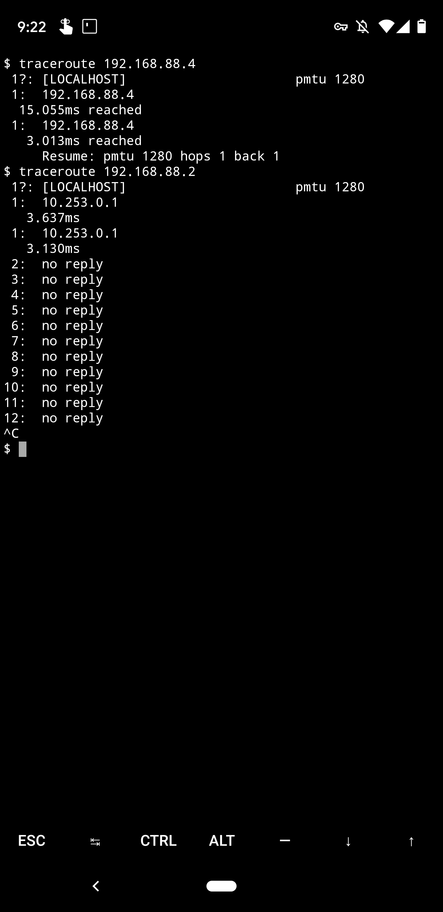

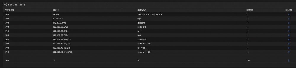

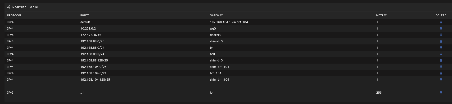

Hi folks,
First off, great plugin.  I was able to set this up with minimal headaches.
However, I have one issue that I'm hoping to get some help with.
My Unraid server has two NICs.  Both in bridge mode:
eth0: 192.168.88.0/24
eth1: 192.168.104.0/24
I run all of my containers off eth1.
For Wireguard, everything works and I'm able to resolve and route to containers, my local router (192.168.88.1) and to containers on the bridge network.
However, I'm unable to access any of my devices on the LAN (such as Pihole on 192.168.88.2) from my client.
I have my client set up with "Remote Tunnel Access" since I want everything to route through my local net.
I'm thinking there is an issue with having both NICs in bridge mode.  When I run a traceroute on my client, it works for everything but the LAN devices, and hangs after hopping to 10.253.0.1.
I've attached a screenshot of my route table in Unraid and the traceroute from my client device (Android)
Edit:  I figured this out.  For Allowed IPs on the client side, you should include 0.0.0.0/0, ::0/0 (for IPV6) to make sure Android works and routes all traffic through the tunnel.
Edited by genius384

I tried to setup wireguard for the first time yesterday, I went for a 'next, next, finish' setup, did only change 'type of access' to 'Remote Tunneled Access' as mentioned in the blogpost about WireGuard.
I did a portforward in my Ubiquiti USG.
Both my phone and win10 client could connect, but ONLY to the serer itself, I could not access Internet or any other things on my LAN.
I deleted my peers, created new ones with the type of access:  Remote access to LAN
Now I could ONLY access things on my LAN, not the Unraid server itself or Internet.
I figured that something had to be wrong, so I uninstalled the plugin and then installed it again.
Created the tunnel, the peers, but this time NONE of my peers can connect to Unraid. It doesn't matter what connection type I use, when activating the client, Unraid says that no clients are connected.
Checking my router I get a lot of hits on the portforward rule.
I have a 'basic' network setup, i do have 4 nics to spread out some load of VMs and dockers, but I don't use VLAN.
Eth0 is in bridge mode.
USG dhcp is set on 192.168.1.0/24 and unraid wireguard is on default, I believe 10.253.0.0.
So I need some help to set this up.
When a peer connects home, I want to be able to connect to everything on the LAN, use my Adguard (like a pihole but nicer gui) as DNS and be able to connect to internet.
What should I do?
