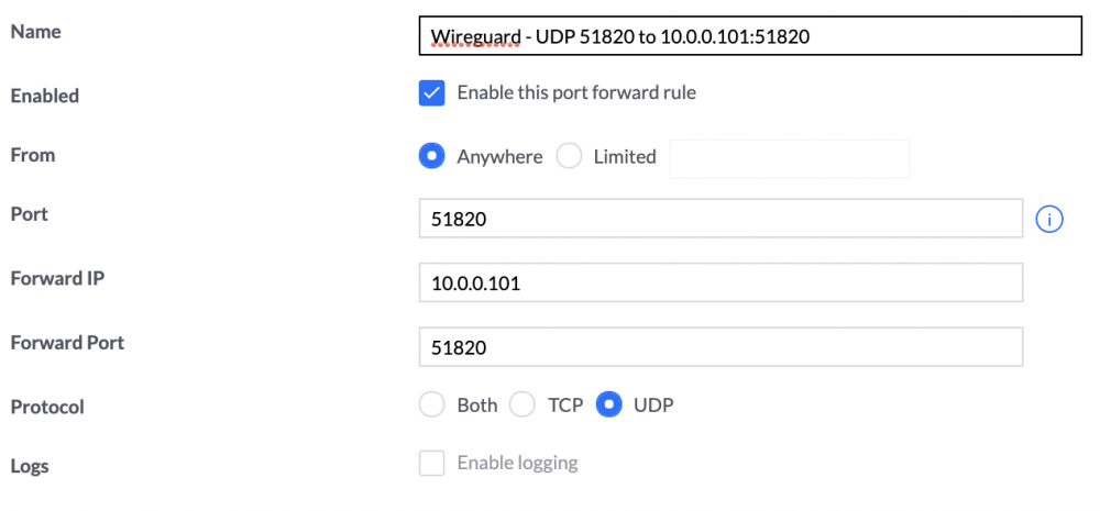

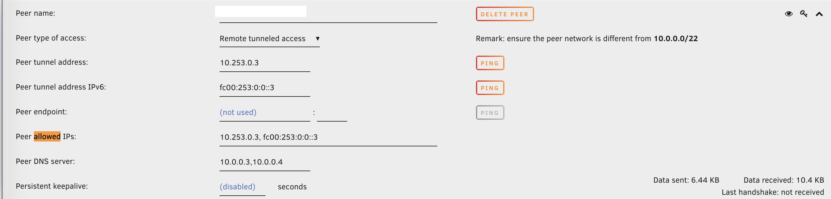

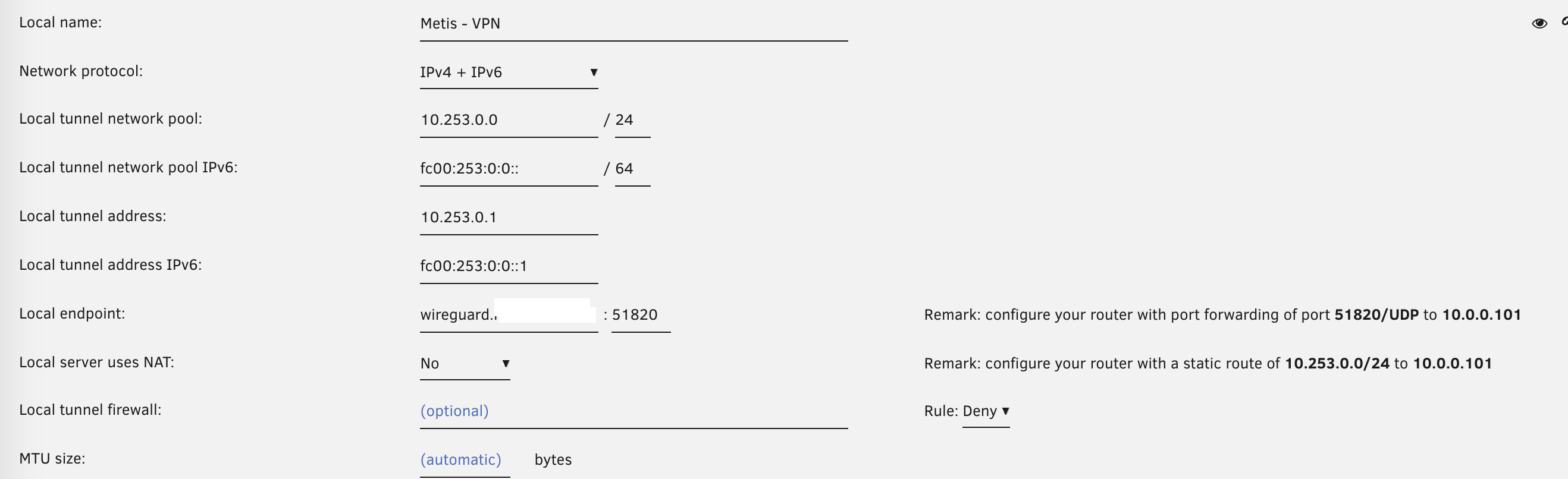

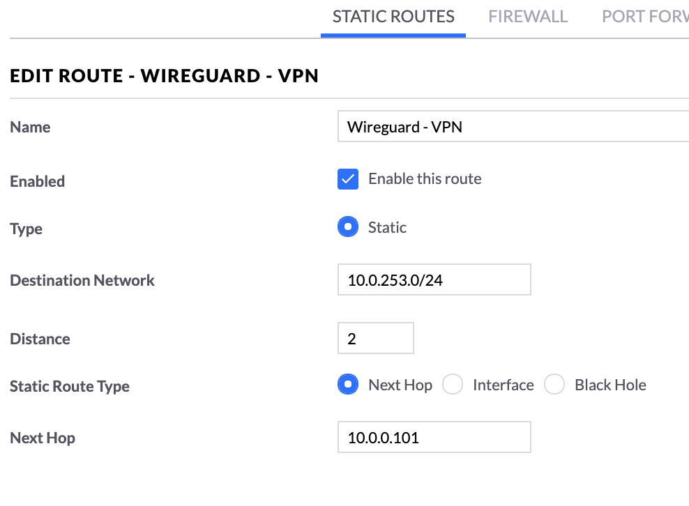

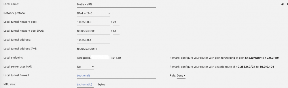

So I am not getting a handshake and I just get a little bit of data transfer. Wireguard and UniFi settings here - would love to know what is wrong. My dynamic DNS works fine for other purposes.

Is this your first attempt at a connection? You are jumping all the way into the deep end :)
Take it a step at a time and get a basic connection going before you start messing with a local DNS server. You need to isolate what is a WireGuard connection problem from a routing problem.
Speaking of routing, there is a typo in your static route. It should 10.253.0.0/24 not 10.0.253.0/24
I don't use IPV6. It may help to disable IPV6 initially just to rule out issues.
@ljm42 Thanks for the tips - I did have it working before but had to reset up everything.
So I turned off IPv6 and fixed that typo, and now I don't even get those bits. I noticed that it is randomizing the listen port on my phone every time i connect - is that supposed to happen? Or should that be 51820?
The listen port on the phone doesn't matter.
I'd suggest dropping the DNS and change to "Remote access to LAN" and see if you can get that working. Basically, make it as simple as possible until you get a connection working, then start adding things in.
Be sure to read the general troubleshooting tips in the first two posts as well.
OK - tried cutting it to LAN and couldn't get it working. I'll play around more and report back whatever it is I messed up.

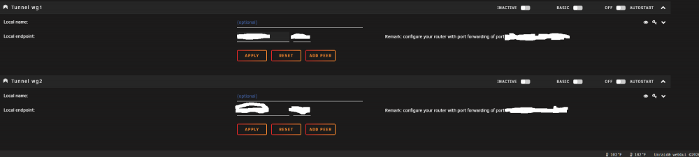

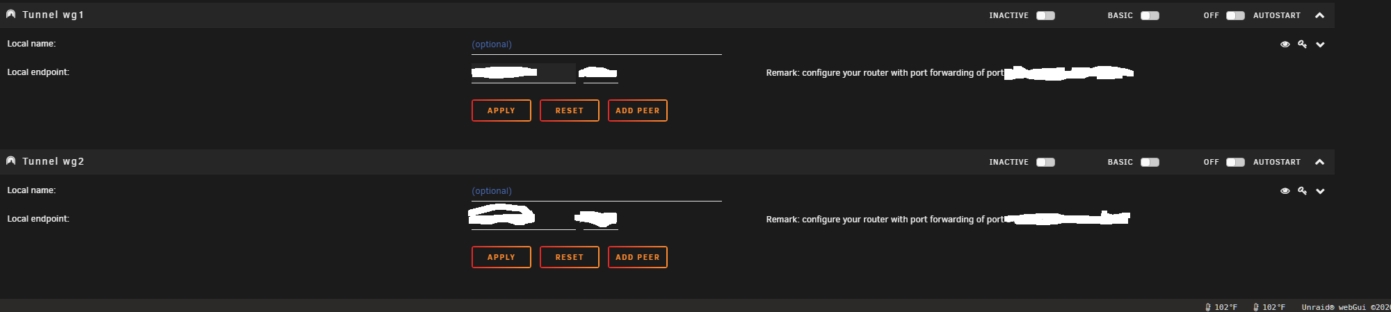

I seem to have accidentally added some extra tunnels in the wireguard config and do not have a way to delete them that I can see.
WG0 is deletedable as shown below but is not the issue:
There is no delete button for the other two tunnels that were created accidentally that I want to remove:
I have looked in network settings and WG1 and WG2 are not there to delete either.
Have you tried deleting the wgX.conf file from the /config/wireguard folder on the flash drive?
Move the slider from "basic" to "advanced", that will enable the "delete tunnel" button.

This does not happen in my case as shown by the pictures submitted above in my original post.  The delete option is indeed there for WG0, but not for the other two that i would like to remove.  Thank you for the reply.
Your screenshot shows each of those tunnels are still in "basic" mode.
