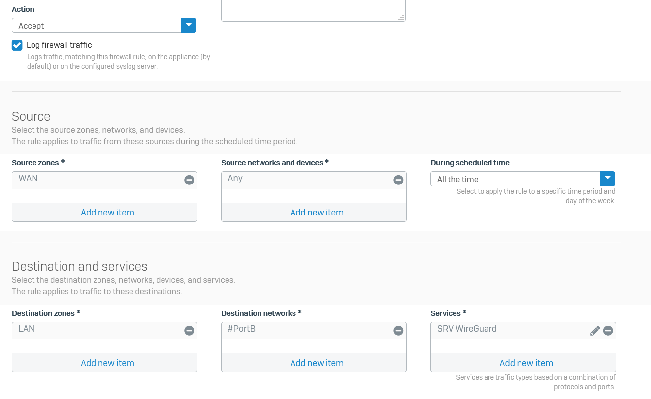

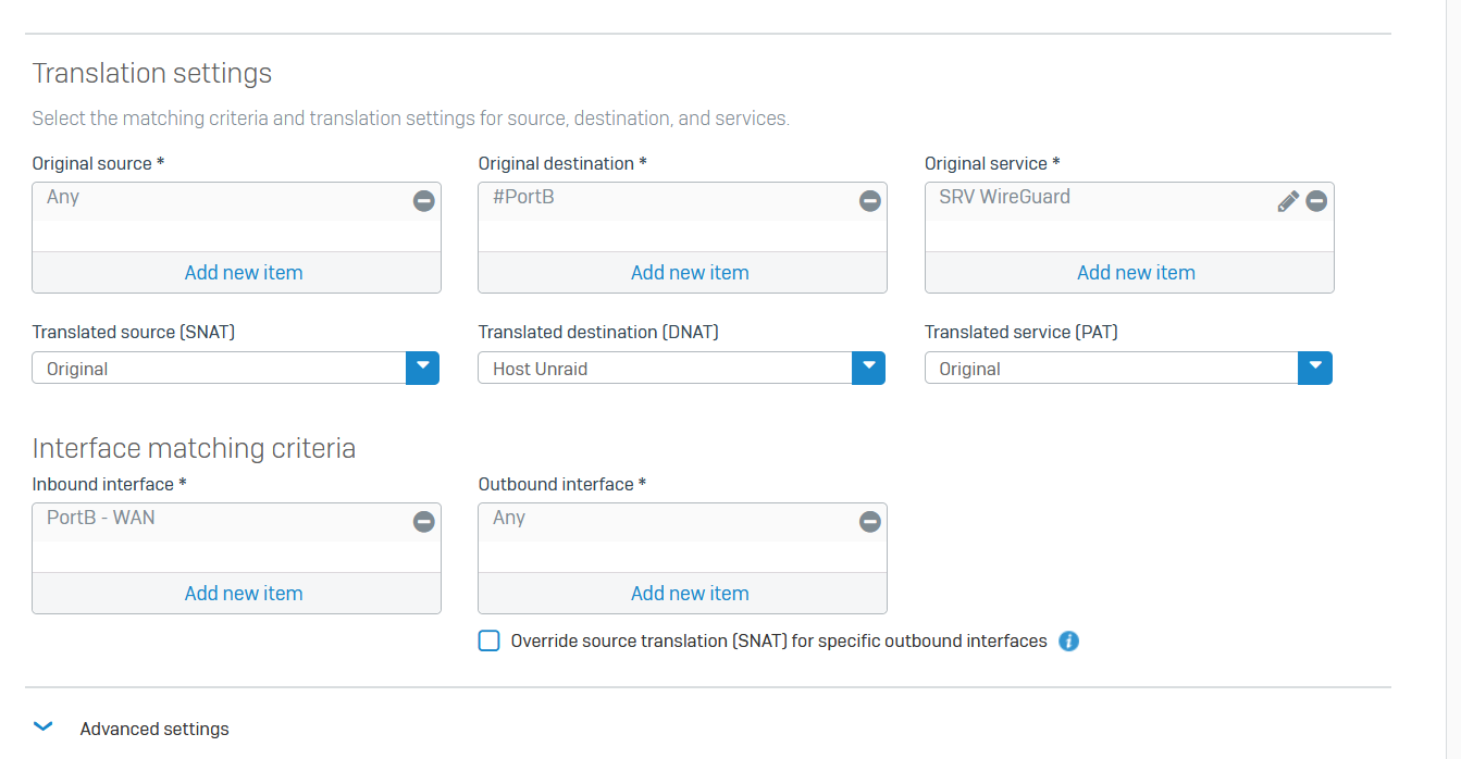

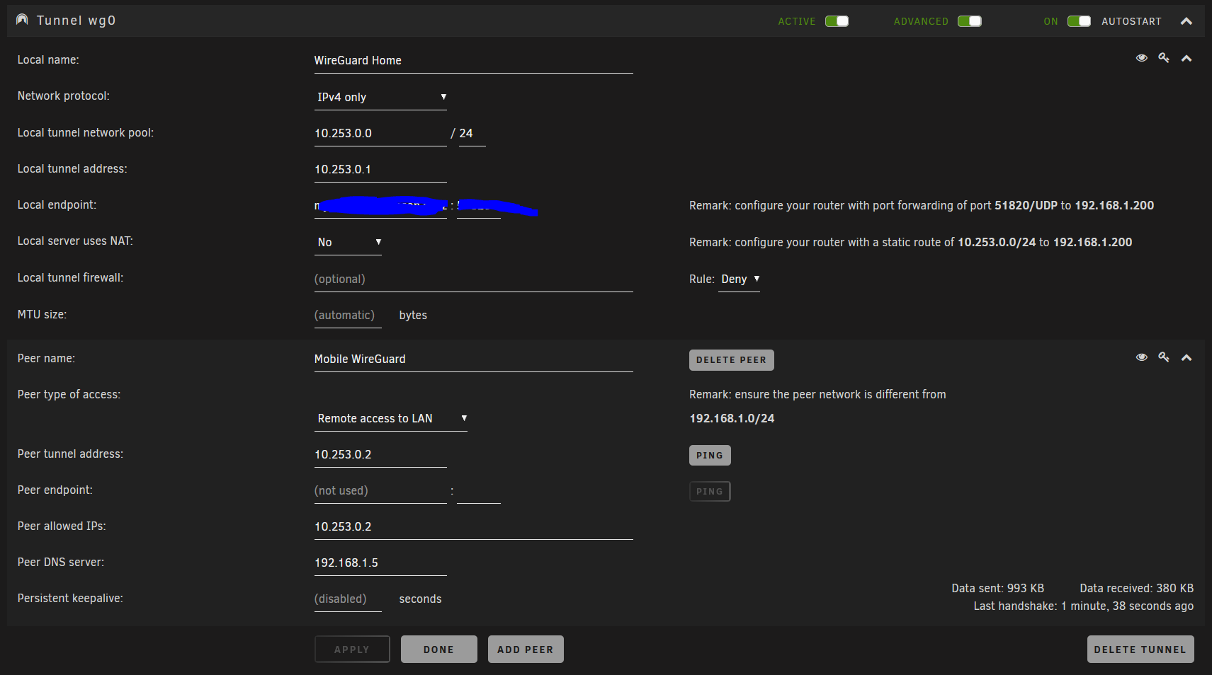

I have configure wireguard like this, I pretend to acces my whole LAN from the Peer.
192.168.1.0/24 Is my LAN
In Sophos XG I have configure a FW rule to accept incoming connections from WAN to my public IP in UDP 51820
Then a NAT rule to redirect the incoming connections to that port to UNRAID where wireguard is
So I connecto to wireguard server, and I can reach Unraid Server from my phone but that is all, I can not ping my phone ip 192.168.1.231 from any device in my network, windows pc, etc, or I can't reach with my phone to any other IP.
Regarding Local server uses NAT, if I enable it does it mean that I won't be able to access to any docker with custom IP from my phone?
I would appreciate some help or recommendations to setting up wireguard. I guess it would be cleaner to create the server in another network, disable "local server uses NAT" and then configure the static routing in the firewall.
Then you have misconfigured the "Local tunnel address" in your WireGuard config. You should start over, and leave the local tunnel address at the default.  The tunnel is not part of your LAN and cannot share the same IP range.

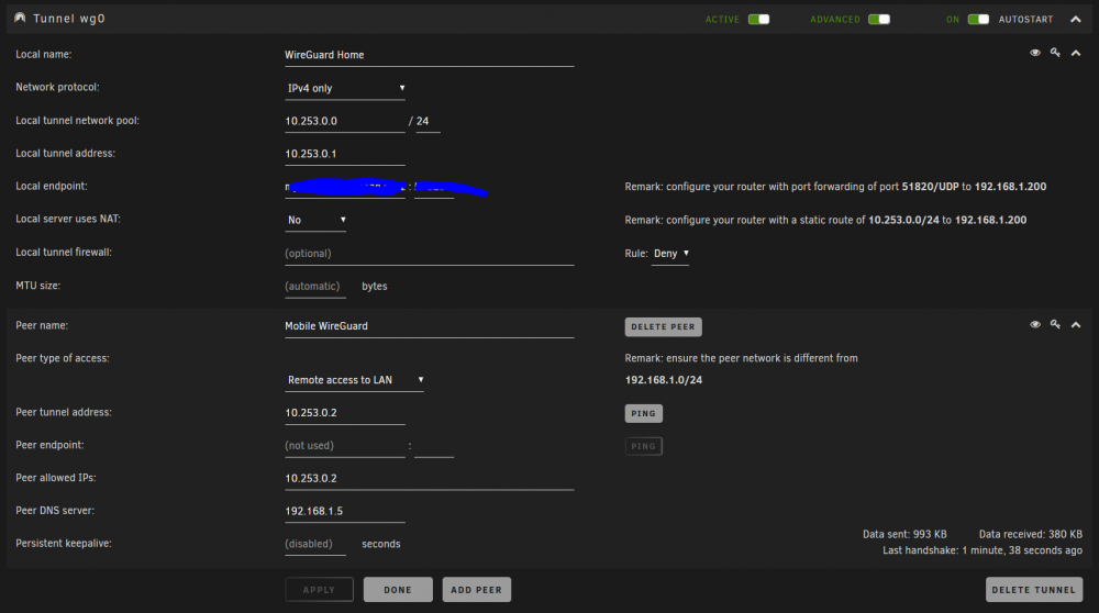

I have set the tunnel address as default, but once connected I can only see unraid server.
Do I need to create a rule in the firewall to provide connectivity beween my LAN and 10.253.0.0?
Shouldn't I see my LAN once connected without adding any additional rule? is there any step by step example of someone with a Remote access to LAN connection?

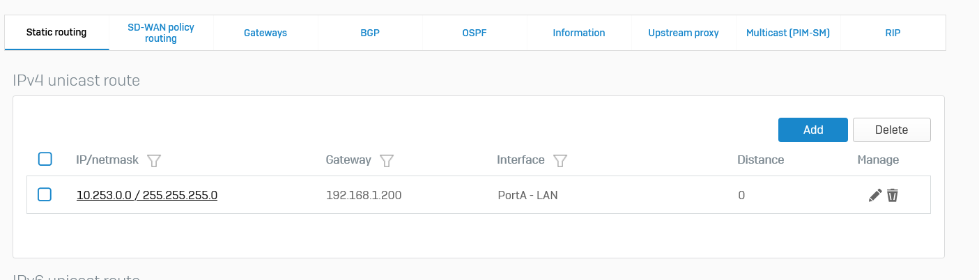

That is exactly the scenario that this quickstart guide walks through :)
Depending on your network, you may need to add a static route to handle that. See the "Complex Networks" section of the guide. To make this easier, the WireGuard plugin now includes "remarks" that tell you what IP range to setup the static route for. You may need to switch to advanced mode to see it.
How are you trying to connect to the other devices? You won't be able to connect by name, only by IP address.

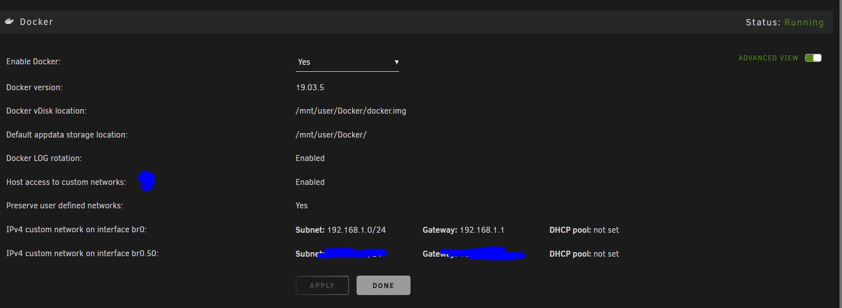

I guess I must be doing something wrong in my firewall
I have added a route
I have enabled the host access to custom networks
Still, from phone I only see the unraid machine, I can't see any other web service I have in the dockers using their IP's
Can you access any other devices on your network? Ones that are not in any way hosted on your Unraid server? I'm guessing you should be able to.
As I mentioned in my reply to phrozen087 yesterday, I have no trouble accessing my router or a raspberry pi through the tunnel. But I am not able to access VMs running on Unraid. Haven't figured out why yet.
I am able to access Unraid Dockers, but my setup is simpler and I don't have any Dockers on their own IP. Because of this, I have "Local server uses NAT" set to Yes.
No, I have scanned the entire 192.168.1.0/24 (ping) and I only see unraid server while I had several devices connected in the same network that has nothing to do with unraid dockers and VMs
Do I have to create a firewall rule to provice visibility beween 192.168.1.0/24 and 10.253.0.0/24?
Did you re-download the latest client config after making any changes via the Unraid interface?
What are the "Allowed IPs" shown on your client?

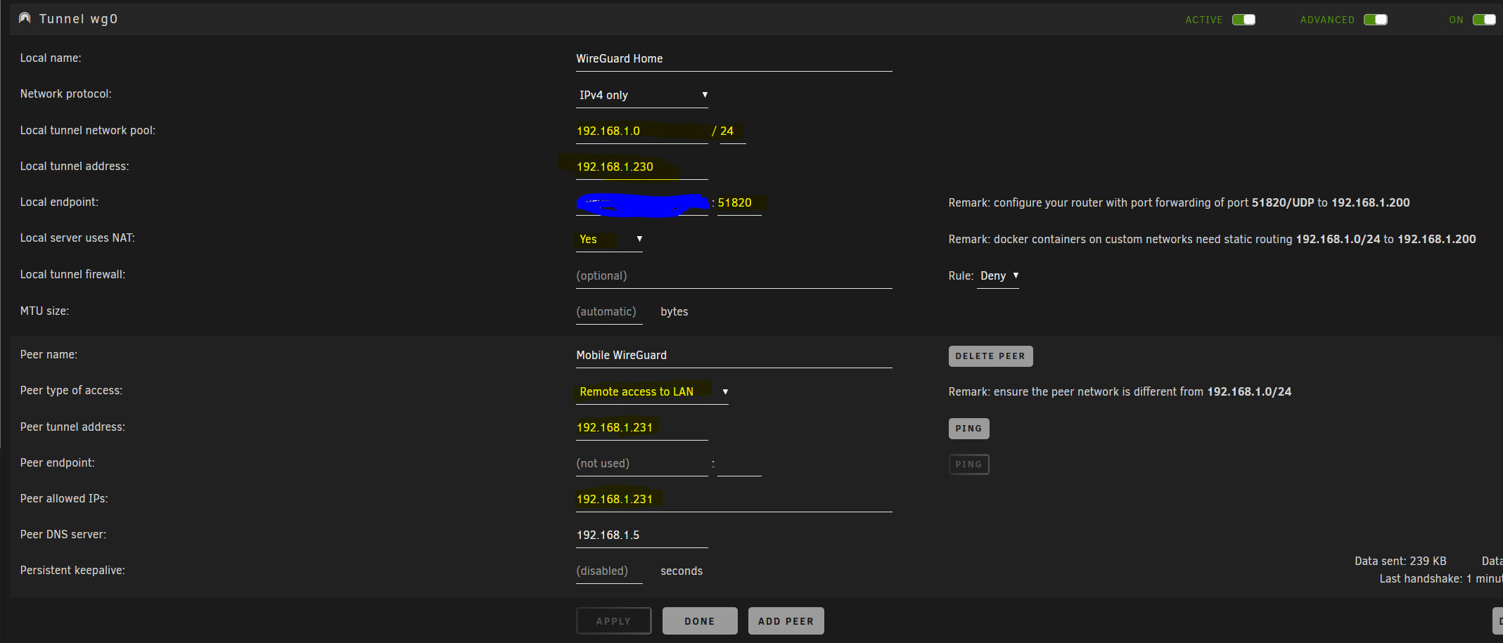

yes,
and allowed IP's are 10.253.0.1/32   10.10.10.0/24   192.168.1.0/24
I have added 10.253.0.0/24 just in case and it doesn't work either.
Edited by L0rdRaiden
51 minutes ago, L0rdRaiden said:
yes,
Any idea what the 10.10.10.0/24 range refers to? I would remove that.
AllowedIPs=10.253.0.1/32, 192.168.1.0/24
