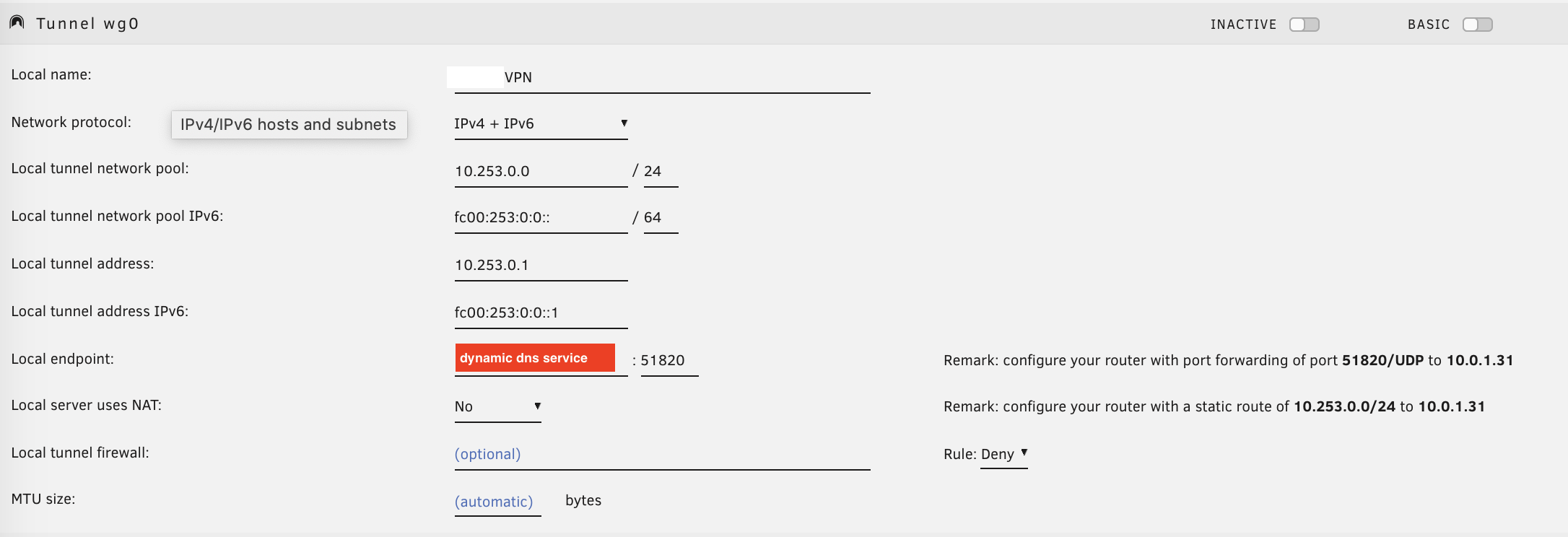

I am having the same problems others have had with handshakes.
10.0.1.2 is pi-hole/unbound running on a DietPi VM.
Tunnel setup:
I844343501_ScreenShot2020-02-17at16_48_17.thumb.png.acff8cd77cc296e8dc1780415af518cc.png

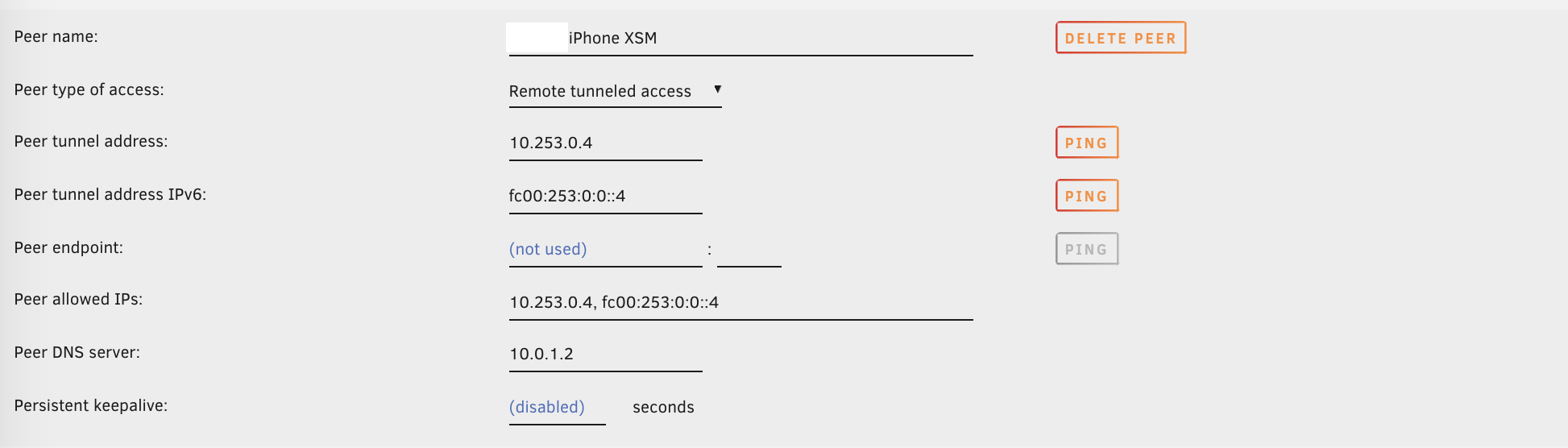

Peer setup:
451156858_ScreenShot2020-02-17at16_48_24.thumb.png.223dd5cb27c8610ea12c3309583045d0.png

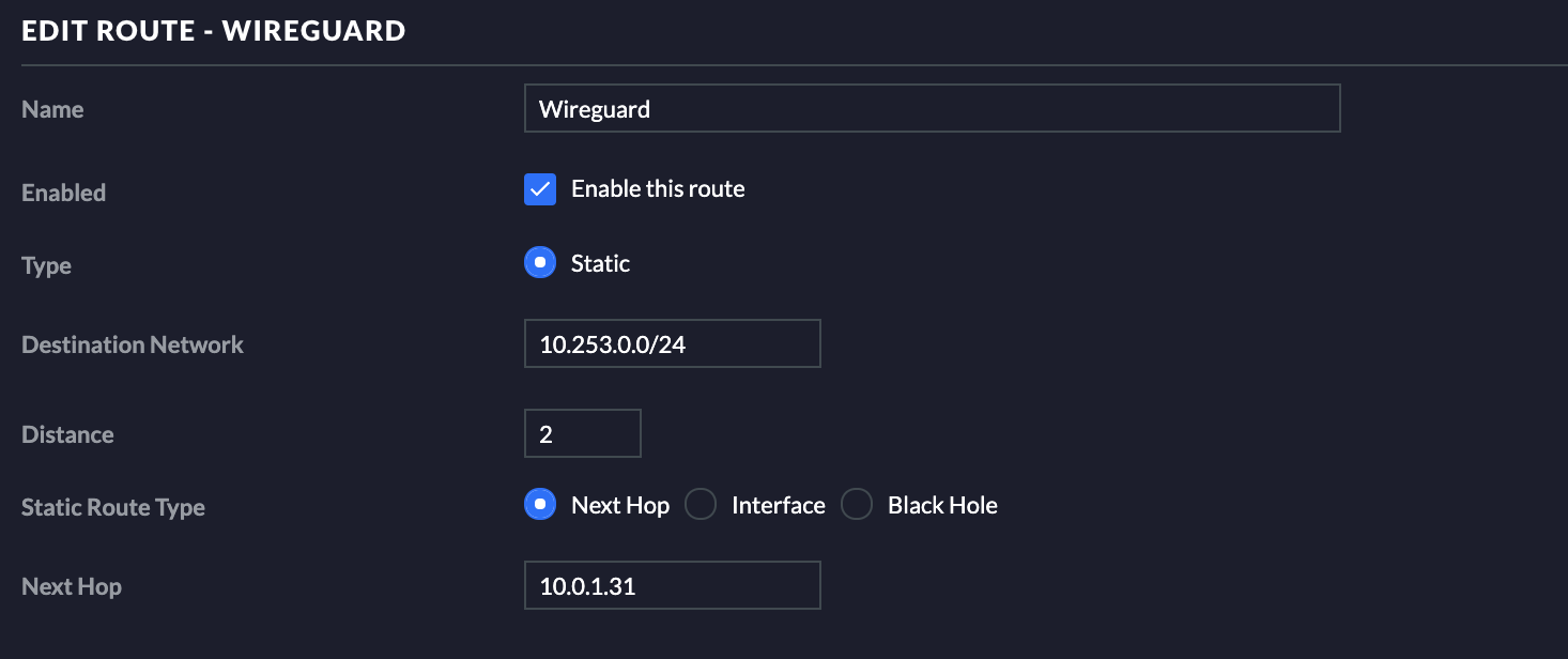

Unifi setup:
490173180_ScreenShot2020-02-17at16_51_54.thumb.png.c51ca0f2f5a7671224cfcb4cdb9a3c00.png

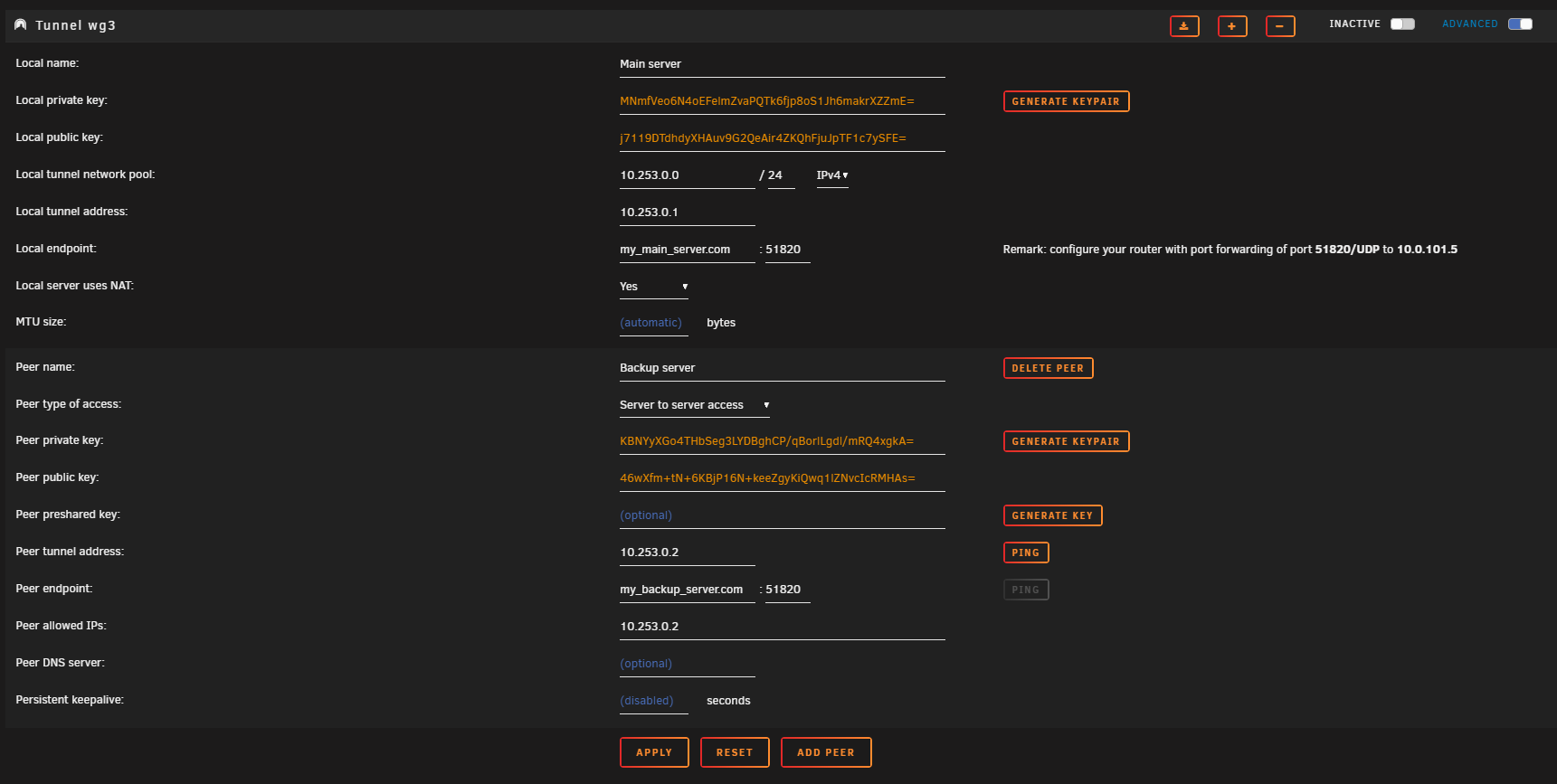

On 12/19/2019 at 10:48 PM, bonienl said:
Below an example configuration
It is mandatory to define a local endpoint (main server) and a peer endpoint (backup server). These endpoints can be a URL or a (public) IP address of the server.
When the main server is behind a NAT router then port forwarding must be set on the router.
The same is true for a NAT router used at the backup server (peer) side.
@bonienl thanks for this screenshoot but this is only configuration for "main server", could you post screenshoot about "backup server" settings? I'm asking about it because I'm struggling with this for many hours.
I will be very grateful. Thank you.
