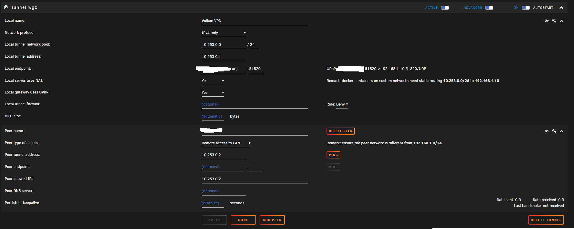

I've tried setting this up for a couple of hours now and I can't for the life of me get it to work so help would be greatly appreciate.
I running a UDM router, the ports open but since I didn't get that to work I enabled uPnP. DNS is working.
Setup tested with a P30 Pro, Wireguard android app, added connection with the use of QR-code. Running 4G connection.
This is what the setup in unRAID looks like;
Edited by Davegtl
Troubleshooting WireGuard is tough because it either works or it doesn't, and when it fails it fails quietly so there aren't any hints as to what the problem is.
I don't see anything obviously wrong, best I can do is recommend that you go through the troubleshooting steps in the second post.

My operator router does not allow adding ip route, so I can't do this config to get access to all my equipements
If I add the static route in my dockers containers it works, but it's not persistent to update or reboot
Is there a way add route as parameter in docker? I didn't find it. Or is there another solution I could apply?
