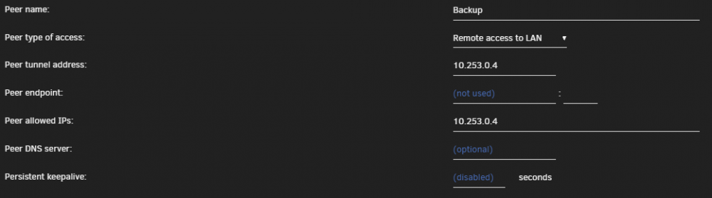

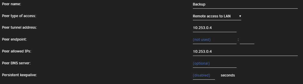

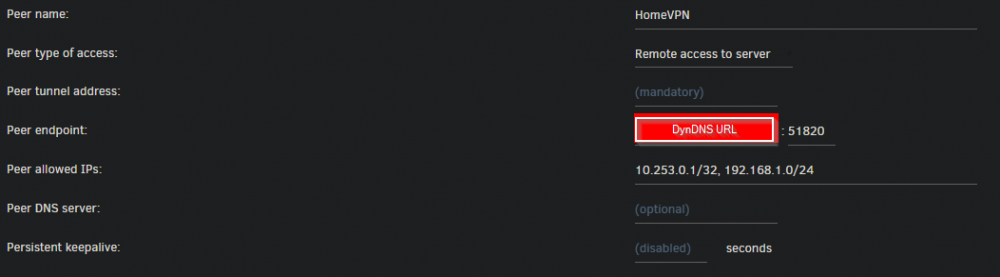

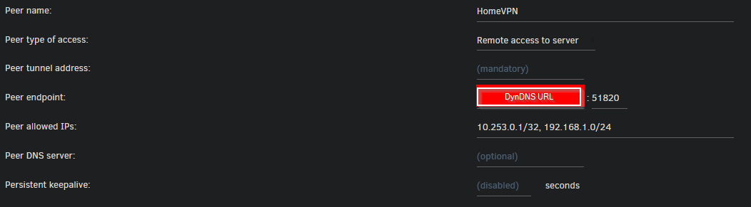

Long story short, I rebuilt the USB stick on my backup server. I added plugins 1 by 1, enabling and configuring as I went. When I got to WG, I installed the plug in, then imported the .conf file. As soon as I click the "Inactive/Active" slider to activate the tunnel, the WebGUI hangs and never comes back. I had full access to the shares, and could telnet in, but now, I can't even do that. I have to go to the attached console and powerdown from there. When it reboots, it comes up with WG disabled and I have full access to the WebGUI. I can repeat this at will, though I don't really want to...
Here's a screen shot of the config on my main server showing how it's set up
And this is what it looks like on the Backup server
The diagnostics dated 2020.01.26 are fresh from the backup server today.

As I said, this had been working. I don't know what I've done differently now to make it not work, or if this was the initial cause of my WebGUI hangs a month ago.
UPDATE for clarity: My goal is to have the backup server off-site and have it connect to the main server. I don't want LAN-to-LAN access, and I don't want the main server initiating the connection to the backup server. I'm not 100% certain that I'll have access to the remote location's router to punch a hole through for WG to pass through, thus, I want to initiate the connection from there. At the moment, the two servers are sitting side-by-side at my house, both on the same network (192.168.1.x).
