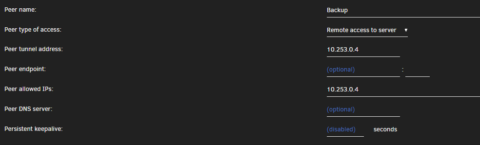

On the main server there's a 10.253.x.x IP address in the "peer tunnel address" and the same IP address is in the "Peer allowed IPs" entry. On the peer setup on Backup, which will be the "remote" box, I have the peer endpoint set to my DynDNS URL. There's a "peer tunnel address" which I have not configured, but the prompt text says it's mandatory. Do I put the "Peer allowed IPs" from the main server into the "peer tunnel address" on Backup?
Here's the Backup server side of the config:
1858345292_2019-12-1616_49_11-Backup_VPNmanager-Brave.thumb.png.2a0ac8dba49690cc4526287c09d5f63c.png
And here's the main side:
530629306_2019-12-1616_49_52-NAS_VPNmanager-Brave.png.ae78b705269935ba42855bf42a670f93.png
With this setup, it appears that they are talking to each other via the VPN, as shown on the VPN section of the Dashboard:
1017359230_2019-12-1616_53_20-NAS_Dashboard-Brave.png.cbe883ba953d2422ca5264bc1360cac8.png

11 hours ago, FreeMan said:
Which side initiates the connection request? i.e. for my phone, the phone initiates the connection and I have to have the port forwarded at home. Can I force the Backup machine to initiate the connection so the same port forward at home will cover all VPN connections, or is it somewhat of a lottery which server starts the server-to-server connection, thus ports have to be forwarded at both ends? I'm pretty certain I can get to the router at the other end to do the forward, but I'd prefer not to if I can avoid it
You can add your backup router as a second peer to the existing tunnel, next to your phone.
Like your phone set the backup router as "remote access to server (or LAN)". This allows the backup server to initiate the connection. For example a scheduled script can make contact and initiate the connection.
A server to server connection is intended to let both sides intiatie the connection setup, it doesn't matter which side does it. This is convenient if you want either side to be active in setting up the communication.
