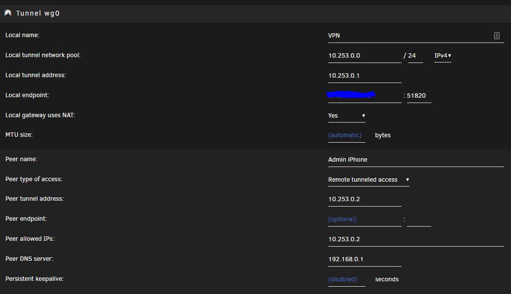

17 hours ago, casperse said:
Hi All
I don't seem to see the option to change  the "local tunnel network pool" anymore in Advanced view
Also tried to delete the plugin and install it again, nut the last update made i vanish from my plugin list maybee by design?
Should I delete the config folder on the flash drive to get back to "start"?
UPDATE: Delete the folder rebooted the server, did the configuration again - found that Local tunnel was in the Peer name (Sorry)
I am now connected but no handshake?
Added the port and also the static route, and I see some activity so what could I be missing?
Any suggestions I have read through the post and I can't see anything wrong...
I am only testing by phone app. Also tried to change tunnel to LAN but I still get no handshake? (Logfile on device says no to handshake)
Regards
Casperse

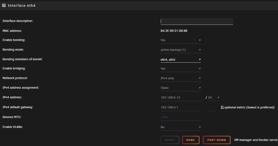

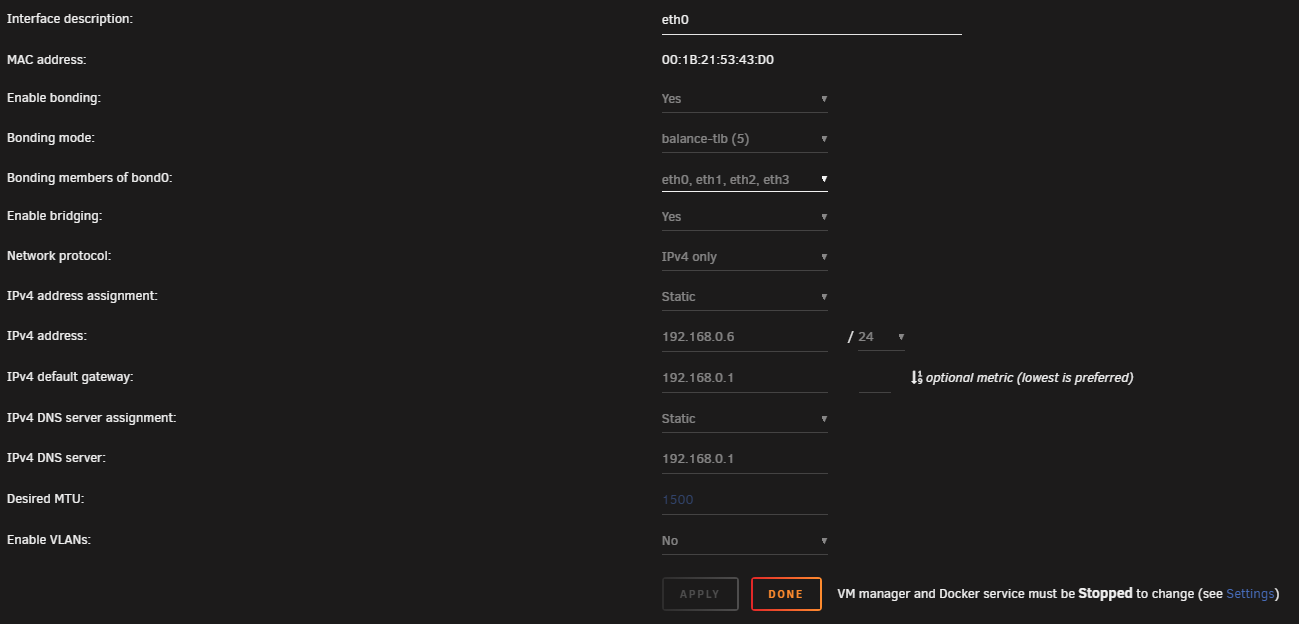

Ok so I just tried my other IP on my Unraid server (have a backup) and then it just worked? (Bridge is enabled!)
How can this be? what sets the priority of my IP's for the Unraid server?
Have I configured the network wrong?
Primary IP (Should be) 192.168.0.6
Is it a bug? running 6.8 - rc3
Secondary IP: 192.168.0.13 <---- Wireguard connects to this one?
Edited by casperse
Try testing with "Local gateway uses NAT = NO"
This prevents adding additional iptables rules to the server.
SORRY spoke to fast Update No that didnt work either the handshake was cashed  @bonienl
Changed the static route to my primary IP and also the forwarding, changed NAT to NO and then no access
Edited by casperse
Sorry no that didnt work spoke too soon
