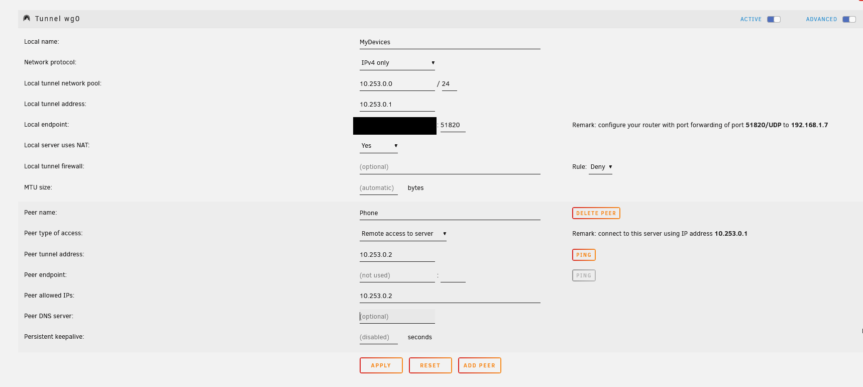

I have wireguard setup with "Remote access to server" so my laptop can access my unraid server.
I'm trying to understand how to access a VM that's running on unraid, but has it's own IP.
For example, my unraid server has IP of 192.168.1.2 and my VM has IP of 192.168.1.100.
For my wireguard tunnel and client setup, my unraid server then is accessible via 10.253.0.1.
How do I access the VM?  Do I need to have it also connect as it's own Wireguard client?  I'm confused because when I read the first post it talks about VMs being accessible but I'm not sure how that works exactly becuase how can my laptop (when I'm away from my LAN and connected via Wireguard) be able to access the VM without an addressable IP?
"Remote access to server" will give you access to the server's main tunnel IP. If you want to access IPs on the Unraid server's network you want "Remote access to LAN". Be sure to update the client config after making this change.
If you run into trouble, see the "Complex networks" section of the first post as there are certain settings that conflict with each other.

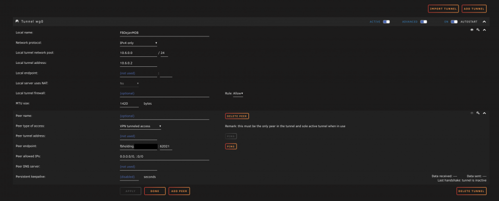

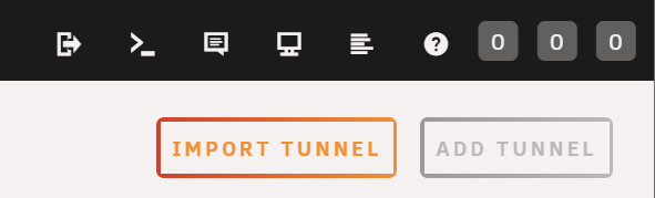

Hello,
sorry if this was already asked, but can I use the vpn manager to import a tunnel and to connect to a different wg-server over this plugin or is this not possible and the plugin is only working as a server?
Purpose want to connect to a client where I run a wg-server at rpi and rsync files between two NAS.

4 hours ago, PsYcRo said:
Hello,
Yep, there is an "Import Tunnel" button in the upper right corner
Thats what I have already done but after the import where can I connect to it. The Gui seems very chaotic from first for a new user like me. I have wireguard on different rpi installed but that was straight forward. in my example I have wg0 now imported but where can I now connect to it:

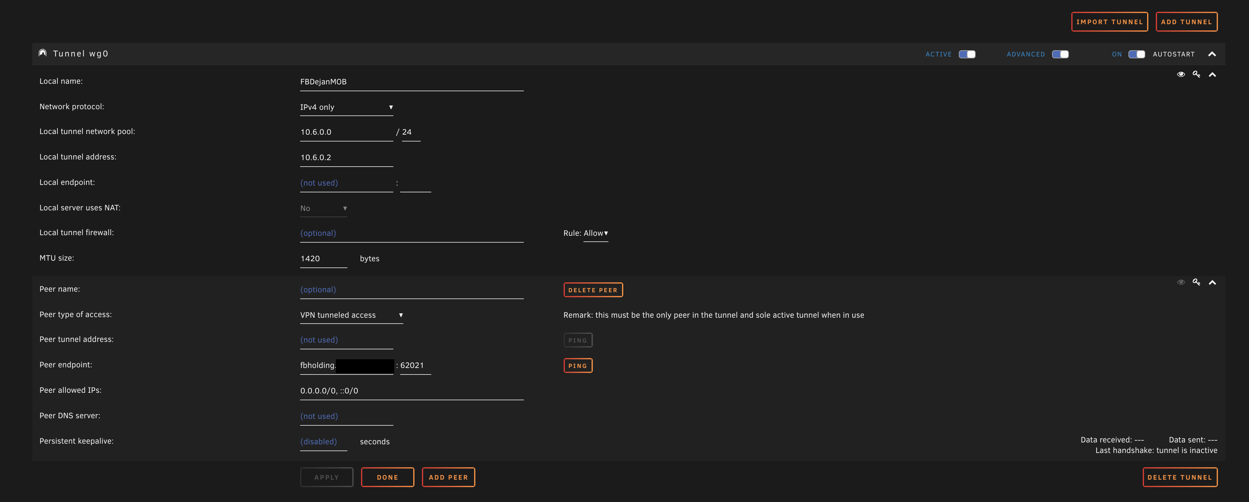

Change the "basic" slider to "advanced" to see more of the settings from your config file. Change "inactive" to "active" to start the tunnel.
I already tried it with the slider active but no response...
Here is the requested screenshot:
Looks like it defaulted to "VPN tunneled access". I don't think that is what you want, probably "Remote Access to Server".  You can turn on the help to see the difference. I'd recommend clicking the little "eye" icons on the right side of the screen to see what the configs look like. You may need to make further tweaks until the configs look like what the rpi is expecting.
Also, click the "key" icons and confirm that the local tunnel has both a public and private key, and that the peer has at least a public key. You don't need to include those in any screenshots though. The same keys will be visible if you click the "eye" icons.
Also there is a peer endpoint but not a local endpoint, that means your server has to make an outgoing request to start the tunnel. If you want either end to be able to start the tunnel, add a local endpoint here and a peer endpoint on the other end (edit: you'll also need a port forward on this end)
How do you plan to test this? Note that the WireGuard connection is only on the server, it is not shared with your LAN. Will you be transferring files from the command line or through a docker?
(FYI, LAN to LAN is possible as well, although a bit more complicated: https://forums.unraid.net/topic/88906-lan-to-lan-wireguard/ )
