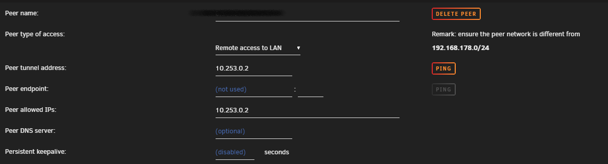

Hi all,
I'm using wireguard as VPN service. I'm using Peer type of access: Remote access to LAN
It works fine but I don't have access to the share folder (SMB).
Could you help me ?

Best guess based on what you have written... make sure you are trying to access the server by IP address and not by shortname.  i.e. make an SMB connection to \\ipaddress not to \\tower

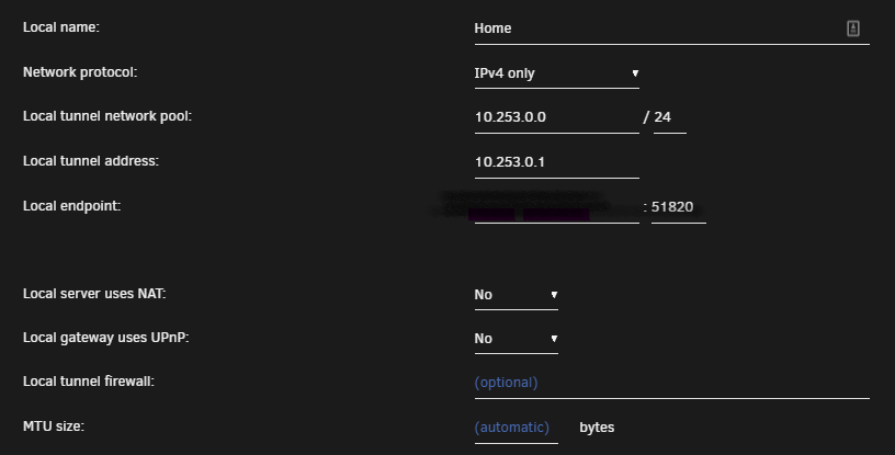

I tried also with IP but nothing.
This is my configuration
You have "Use NAT" = No, there should be a remark telling you to setup a static route in your router, have you done that?  There are more details in the "complex networks" portion of the first post.  Until you work through that nothing on the LAN (including accessing the server by its LAN IP) will work.
FYI, you can also access the server by its tunnel IP. So SMB to \\10.253.0.1 should work regardless of the "Use NAT" setting or whether you have a static route setup.
