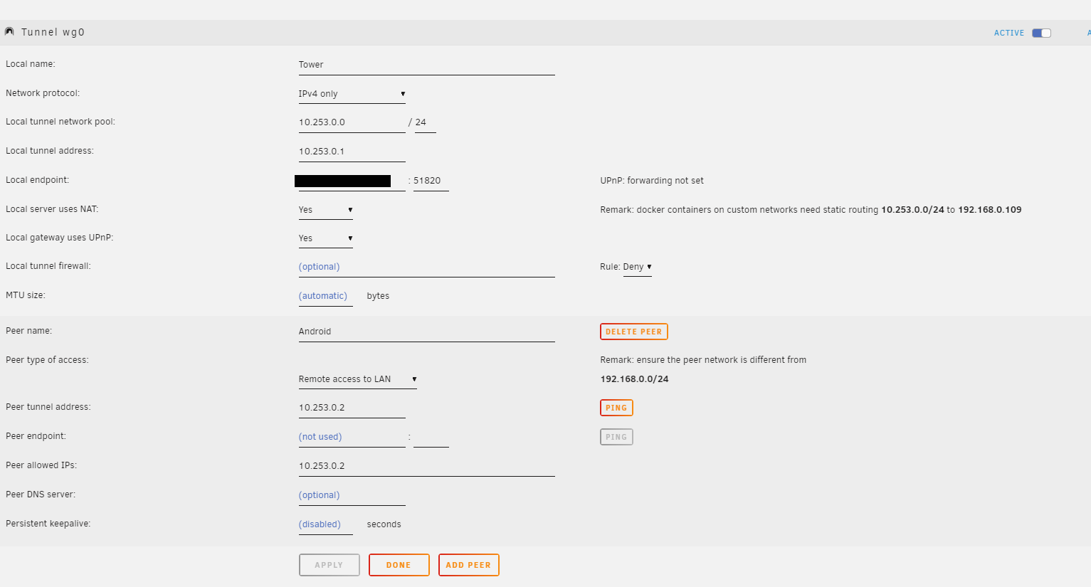

So, I had this working fine and for some reason it recently stopped.  I can't get it to show a connection or handshake.  I've tried to reconfigure and even deleted the tunnel and started from scratch.  I have upnp enabled on my router but the server is showing it's not set.  I also have the port forwarded to the server. I've switched to my wan ip instead of ddns that was working.  I've read through the troubleshooting tips at the start of this thread but am not sure where to look next.  Any recommendations on what info I can provide to help get this resolved? Client is on an Android phone, wifi is off in order to use cell network.
upnp.PNG.fbc491851e02207c4de7b7ca54d92d3c.PNGforward.PNG.f429b7523ec272946e7eb24eaa0e5f4e.PNGsettings.thumb.PNG.e6aeeca34e6267d78dd2eff9ec76736d.PNG
Everything looks good. Once you start the WireGuard client on the phone, are you doing anything to trigger a data transfer? There won't be a handshake until you send data.

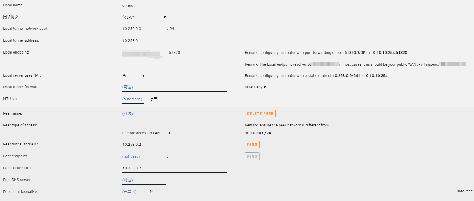

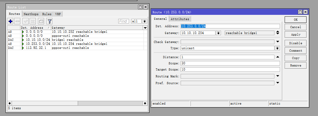

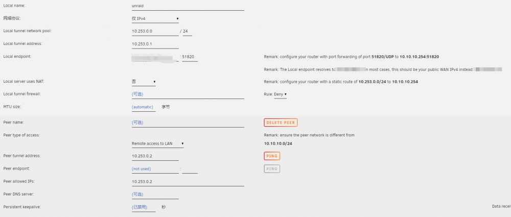

Hey,
I have configured it according to the instructions. Disabled NAT and add static route. I can connect to wireguard and access unraid (10.10.10.254) and router(10.10.10.253). However, other devices in the LAN cannot be accessed (incloud ap, unraid vm, custom ip docker).
Thanks !image.thumb.png.b8b7663e5de57d10a2943c791efef64c.pngimage.thumb.png.aec6b4a6730d13c913ab68b99154f079.png

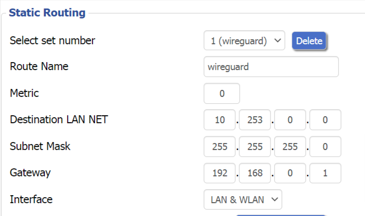

I'm trying to get access to a docker that has custom Ip. I've tried to do everything listed in complex setups section, but just can't get it to work.
Currently I can access Unraid server over the wg connection. I can access dockers that use the server ip. I can access other lan devices. But cannot access dockers with custom ip.
I have set Use NAT to No and I have Host access to custom networks enabled. I'm using DD-WRT on my router and have set static route as follows. Is it set correctly?
Edit: I have Peer type set to 'Remote access to LAN'.
Edited by lsaranto
It looks like you have set the Gateway to the IP of your router? Per the OP that should be the IP of your Unraid system.
Yes, I should have been more clear. My Unraid is 192.168.0.1. My router is 192.168.0.254. Call me weird, but I don't like the router taking the first address.
Hmm, nothing else is standing out, sorry
I think my docker settings were somewhat corrupted. I think even though 'Host access to custom networks' showed enabled it actually wasn't. Possibly for containers created after a certain Unraid update. I stopped and started docker service a couple of times and toggled Host access setting back and forth in-between. Now I got access to docker containers with custom ips, too.
