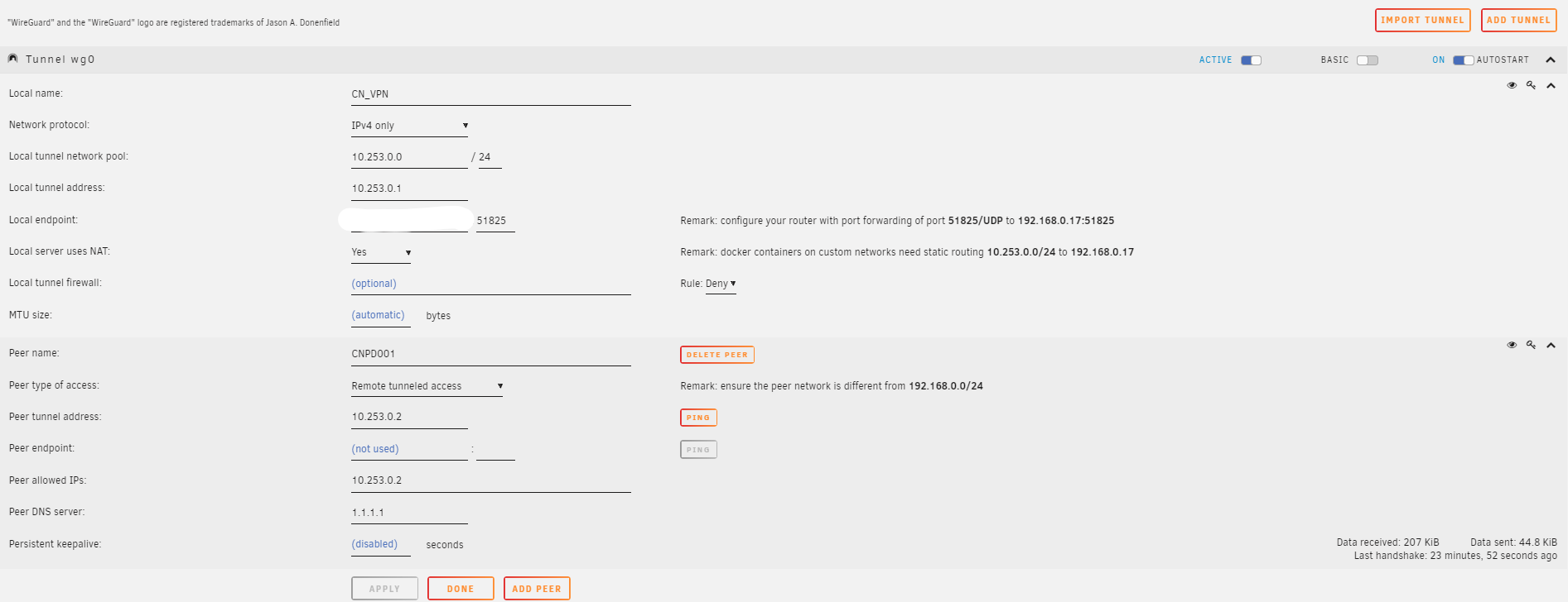

I have an issue with my laptop similar to some people here with no solution. Maybe I missed but here it is:
In the config for "remote tunneled access" I can access everything using my android phone. Internet & LAN. While being on the same connection, my laptop with exactly the same vpn settings, does not connect to LAN. I downloaded the same profile that I created for the phone and on the laptop it still does not access LAN.
If I create a new profile in wireguard config as "LAN access" and use that on the laptop, I can access unraid tower from browser but still no network drives are visible.
So my deduction is that something is fishy from the laptop, since laptop is the only thing different. Either laptop settings or something about the vpn client app. If someone could shed some light it would be awesome.

An update on my issue... This seems an issue with Windows 11 only. Same config works on Win 10. That brings the question if win 11 has some settings that is causing this cause Win10 is just plug and play for me.
What I've tried:
-Set Inbound/outbound rules for firewall
-Turned Windows Firewall on/off
-Set the network adapter to private
-Used Tunsafe to see if it was wireguard app related
-Used "secpol" and adjusted the stettings there too.
Is there any potential setting that I'm missing?

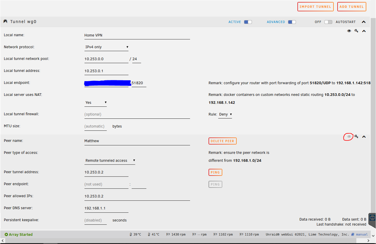

Hoping someone can help.  I am able to access my server remotely via Wireguard.  However, I cannot access any other asset on the network (i.e., Home Assistant on a VM/another IP).  Additionally, I cannot access the internet.  Below is my configuration on VM Manager.  Any insight would be greatly appreciated.
Edited by BigMal

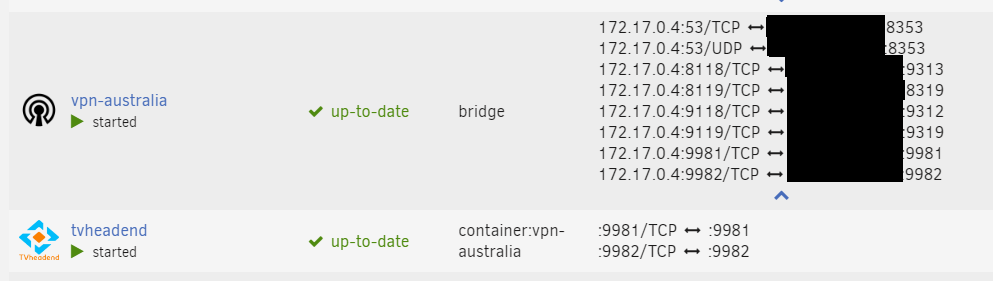

Hi everyone, I've just setup WireGuard and everything is working well except I have an issue with a couple of specific docker containers where I route traffic via other containers.
I have a couple of instances of this setup but I've provided 1 example in the screenshot, essentially the tvheadend container the network is set to none with the parameter "--net=container:vpn-australia" to using the network of the vpn-australia container, the vpn-australia container is just openvpn using PIA to connect to their Australian server.
While connected to WireGuard on my phone I'm able to access all my other containers and I'm even able to access the vpn-australia container but I cannot access the tvheadend container.
Has anyone had a similar situation they've come up with a solution for?
Any help would be great. Thanks!

I have 2 peers, a "Remote tunneled access" and a "Remote access to LAN". Both can connect and handshake with no problems. I can access the unraid webUI but neither allows me to access anything outside of unraid server's IP. I can access my dockers that are on br0 but nothing that uses a custom IP, nor any of my VMs or other devices on my server's LAN.
Any ideas would be welcomed, have been pulling my hair out for a few days trying to figure this out. I can post images or anything to give more context if needed.
