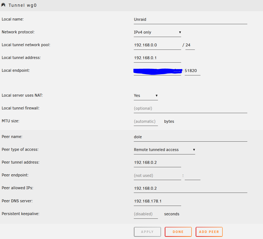

I am a newbie here but I followed all the steps perfectly... but I am not able to make fireguard work. I was able to open the port 51820 in my router, configured VPN manager try to connect from my iPhone. I could even see the handshake is successful but I am not able to access local shares or Unraid server through my iPhone.
690869383_Screenshot2023-01-23at10_57_19AM.thumb.png.4db1355771ae06dc926aa40e840fc2f3.png
Can anyone tell me what else I need to do and where I am making a mistake ?

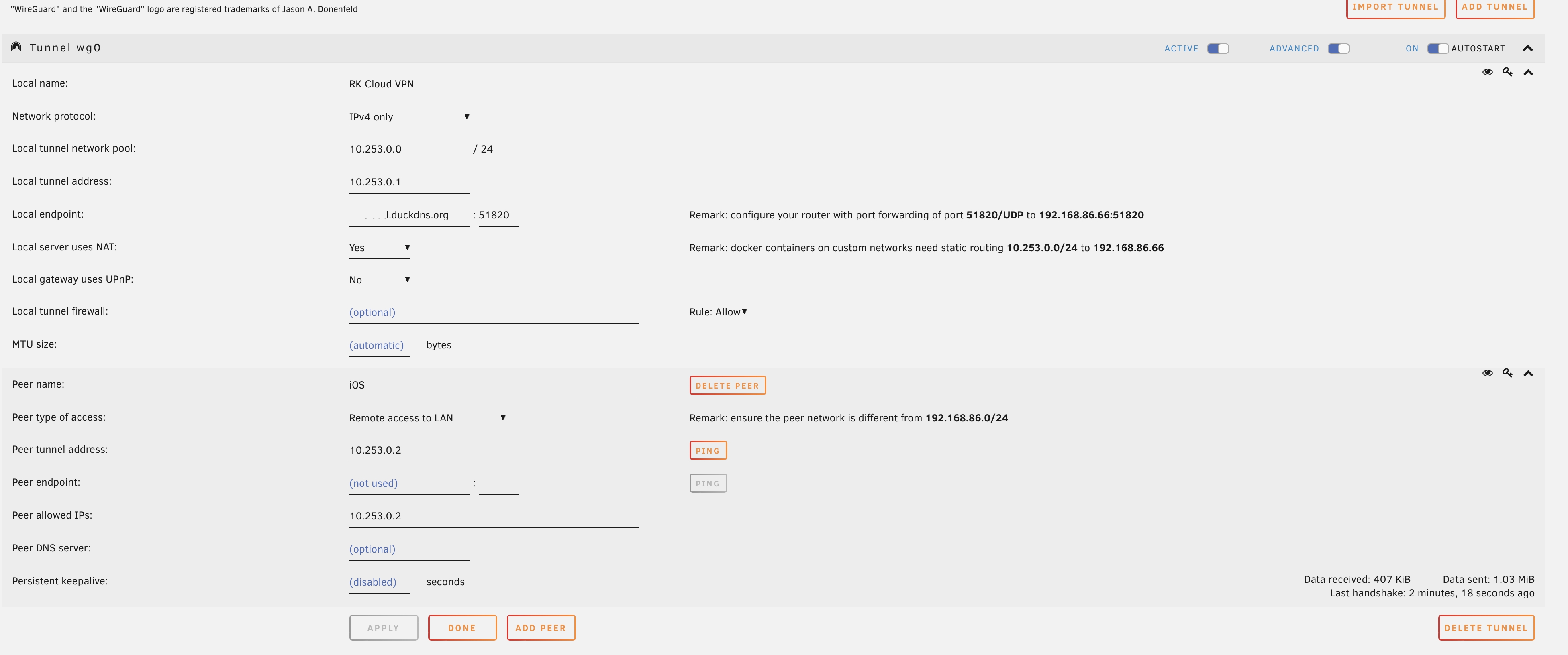

I am trying to setup the last option in the list above for 'Complex Networks':
"With "Use NAT" = No and "Host access to custom networks" = enabled and static route
--server and dockers on bridge/host - accessible!
--VMs and other systems on LAN - accessible!
--dockers with custom IP - accessible!
(woohoo! the recommended setup for complex networks)"
I have tried the following settings:
-WireGuard 'Local server uses NAT' = No
-Docker 'Host access to custom networks' = Enabled
-static route on my router 10.253.0.0/24 to IP_of_Unraid_machine
with the above, when I connect my mobile device (on cellular network) to WireGuard, I get access to other machines on my LAN, and to Unraid Docker containers with custom IPs. But I don't have access to the WAN. A traceroute on my mobile device stops at my router and doesn't make it out to the WAN, even if I try to access a website by URI (i.e., 172.217.1.14 for google.com )
I then tried the following settings (which corresponds to the second entry in the list from 'Complex Networks'):
-WireGuard 'Local server uses NAT' = Yes (only change compared to above)
with the above, when I connect my mobile device (on cellular network) to WireGuard, I get access to other machines on my LAN, and to Unraid Docker containers with custom IPs, and now I also get access to the WAN.
I am left scratching my head why my setup works with the opposite 'Local server uses NAT' setting compared to the quickstart guide? The guide says I should leave the 'Local server uses NAT' set to 'No', but when I do that I lose access to the WAN. When I leave 'Local server uses NAT' set to 'Yes', then I get access to everything LAN, Docker containers with custom IPs, and the WAN, but the quickstart guide specifically indicates these settings should not work this way.
Am I missing something obvious here? Will having 'Local server uses NAT' set to 'Yes' create problems down the road for me?
Very confused, thank you for any insight you can provide!

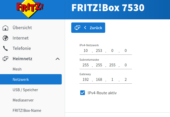

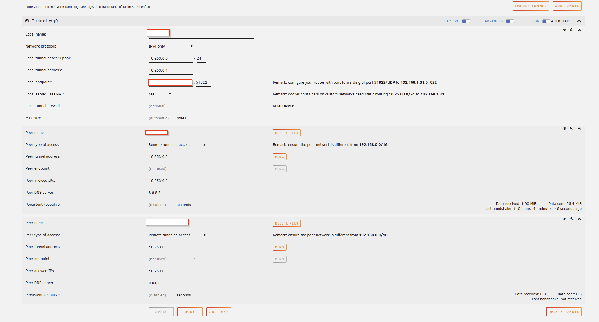

Good day all,
I've been using wireguard for a while, and always had the issue that i cannot acces the internet while connected to the VPN. Previously this was an non issue, as i didn't actually needed it, it recently however has become an issue.
Now, i'm geussing since i used the quickstart guide, i should post here. So let me start with explaining the layout of my network. Starting from the ISP going in.
From the ISP side, i have a WAN box (Ubiquiti EdgeRouter-12).
- I use this to connect my optical connection directly to my network. This ER also serves as my firewall / DHCP server.
- It runs the DHCP for 4 Vlan's (something with not wanting CCTV and IoT mixed in a network)
The ER has a static route to my ICX 6450-48P, which serves as my router.
- Primary reason for this is because the routing capacity of the ER is lacking
- secondary reason, i need PoE ports more than the ER can supply, and i already had the ER
- Third reason, the ICX has no WAN ability
From the ICX, i connect to another ICX via a single 10gb fiber connection. Which has the unraid box behind it. The 2nd ICX is in switch mode.
Firewall ruling disables acces between the different subnet, and the CCTV camera's have 1 hour of acces to the internet a week for only time synchronisation.
On unraid i run dockers for pihole and lancache. Which effectively are my internal DNS servers. This should be a nice to know, but not a requirement as i don't need these for DNS purposes when using Wireguard.
Troubleshooting steps:
Changed connection types, which didn't yield any results (logical, but worth a shot)
Changed DNS from local to 8.8.8.8, no notable results
Added allowed ip's equal to the subnets of my Vlan's with the /24 notation, no notable results.
When doing a tracert to a (both DNS and IP), i get a result only from my unraid box, everything after that times out.
So my understanding is that the internet requests do not leave the unraid server. Which leads me to believe i'm missing a link between the server and the router. Am i assuming correctly? (NAT issue?)
--- Solved ---
After adding the static route not only to the ICX router but also to the ER (WAN), it works.
So maybe one could adjust the write up, that the static routing needs to be in other places as well when there is a split configuration?

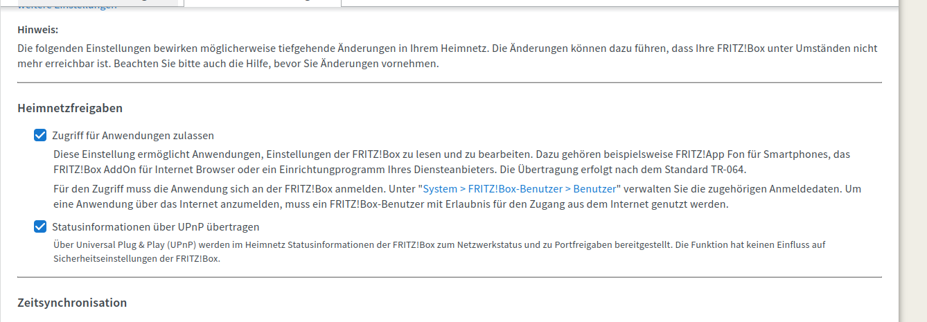

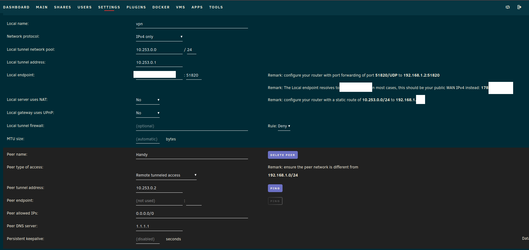

Hey Squad,
I can't activate my vpn server, does someone know why?
( from extern port 58120 is closed )
Port 58120 is forwarding from extern to intern via fritzbox
UPNP is activate but unraid think it is not. So in the config it is disabled.
Static rules:
Wireguard config:

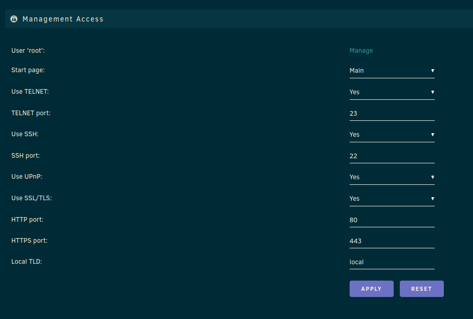

I think you might have missed this from the first post:
If UPnP is enabled on your router and you want to use it in Unraid, go to Settings -> Management Access and confirm "Use UPnP" is set to Yes
Also, you are getting a warning that your local endpoint doesn't resolve to Unraid's WAN IP. I'd really recommend investigating that, the the port forward doesn't matter if the local endpoint doesn't point to your router.

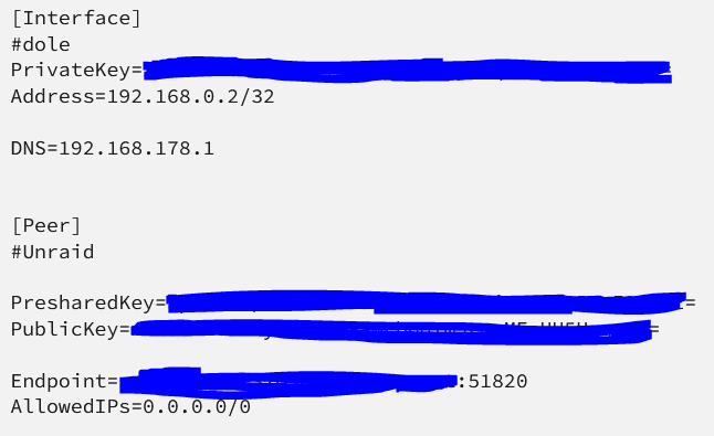

Hey.
I have set up the VPN in Settings>VPN Manager. It works on my android phone but not on my other Windows laptop. Has anybody encounter this problem? When I connect to the VPN from my phone and ping it from Unraid it replies, but the windows laptop does not.
On 6/9/2023 at 6:40 PM, Lecso said:
Hey.
My best guess is that your windows is on the same if not similar subnet, and the phone is not.
My laptop was on a wifi hotspot created on my phone. On the phone that works. I also have problem with an ipad. Remote access to server and remote access to LAN has internet, I can reach the Unraid login page and my routers login page, but nothing else on my local network. I tested this on the hotspot shared from my phone too.
Allright.
Can you connect to the unraid server via its DNS address, or only via its ip address? If the latter. its likely something in your DNS settings.
1 hour ago, Caennanu said:
Allright.
I will try to explain it better!
I tried two android phones with mobile data, their settings are Remote Connect to LAN. Both worked as they should, I reached everything like I was on my home network. I could reach my 3D printer, Unraid, my router, everything on their usual address.
However, the Ipad, connected to one of these android phone's hotspot could only reach my router on its default 192.168.1.1 address and my Unraid server login page via this address (in Remote connect to LAN mode too): 1907528148_kp.png.823f778033fc7ad0c520d7067f41d367.png (but not on the 192.168.1.121, Unraid's address on my home network)
Edited by Lecso
Alright, i do not know exactly what an hotspot does... (i know its function, but not its technical details).
It sounds like the android phone creates a virtual network. Kind of like a WAN port. Creating a different subnet for the ipad.
Can you check if the ipad gets an ip in the same range of your local network, and if it is the same. if that ip address is reserved from your own dhcp?
Edited by Caennanu
Well, whaddaya know...
Updated to 6.12 stable. And had the same issue.
I had to reboot my router, as my static route wouldn't take hold.
This allowed me to acces LAN, but nothing outside of it.
Maybe that is the issue on your end too?

VMs and other systems on LAN - NOT accessible
dockers with custom IP - NOT accessible
(avoid this config)

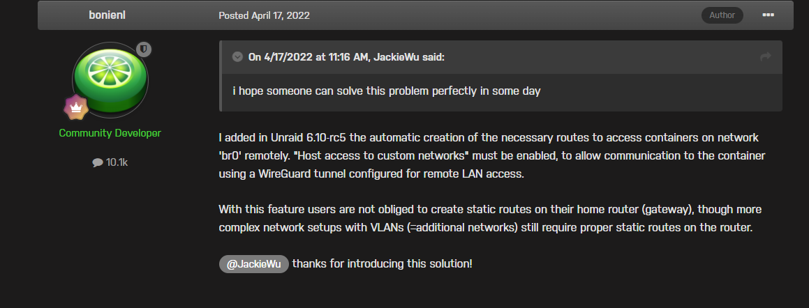

But my actual result with UnRaid 6.12.1 is:
With "Use NAT" = Yes and "Host access to custom networks" = enabled (static route optional) -> NO static rule was set
dockers with custom IP (on br0) - accessible!
(avoid this config)
Does anyone know why exactly that could be?
