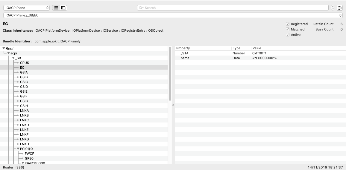

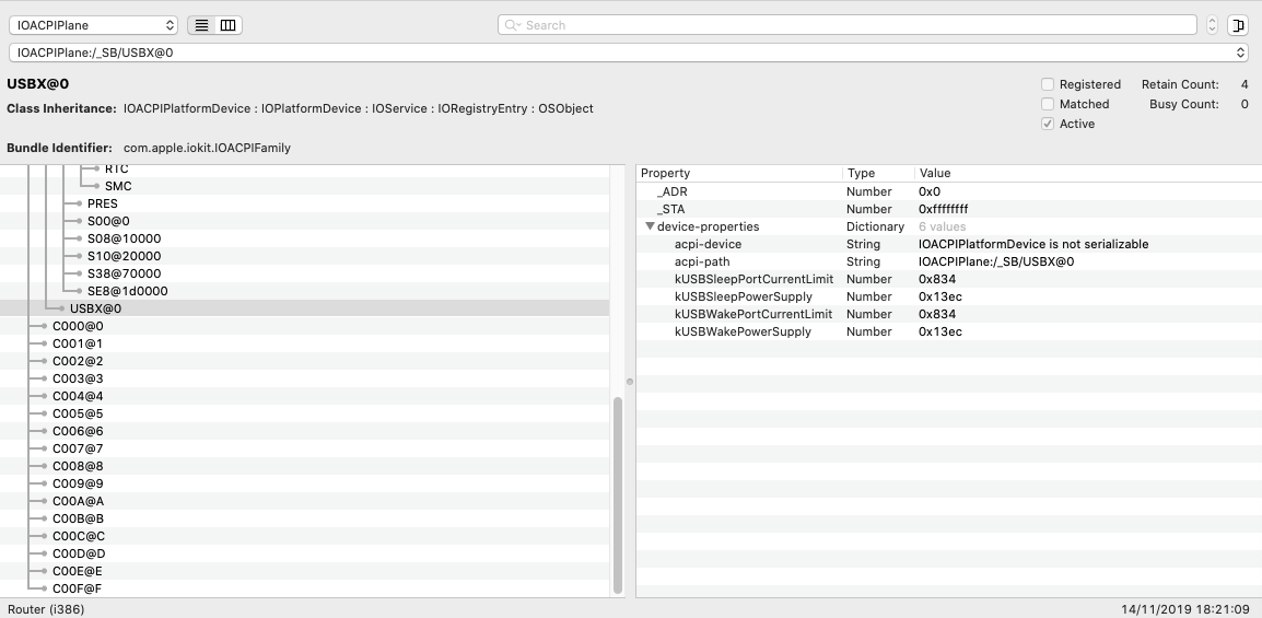

Reading some web pages around about AppleBusPowerController: it seems that from mac os Sierra some properties related to current and usb are injected in AppleBusPowerController.
From my ioreg I couldn't see AppleBusPowerController loaded so I created SSDT-EC-USBX.aml and put it in CLOVER/acpi/patched folder.
Source of SSDT-EC-USBX is:
DefinitionBlock("", "SSDT", 2, "hack", "EC-USBX", 0)
    Device(_SB.EC)
        Name(_HID, "EC000000")
    Device(_SB.USBX)
        Name(_ADR, 0)
        Method (_DSM, 4)
            If (!Arg2) { Return (Buffer() { 0x03 } ) }
            Return (Package()
                // these values from iMac17,1
                "kUSBSleepPortCurrentLimit", 2100,
                "kUSBSleepPowerSupply", 5100,
                "kUSBWakePortCurrentLimit", 2100,
                "kUSBWakePowerSupply", 5100,
This code is from RehabMan who says that EC and USBX must be injected in ioreg.
However, here:
https://olarila.com/forum/viewtopic.php?t=11144
Ewerd is saying that:
"AppleBusPowerController.kext has changed in Catalina, it no longer matches to EC.
The upshot of this has been that I don't need EC or USBX to get USB power. I've added a section for AppleBusPowerController to the top of my SSDT-UIAC:"
DefinitionBlock ("", "SSDT", 2, "hack", "_UIAC", 0)
    Device(UIAC)
        Name(_HID, "UIA00000")
        Name(RMCF, Package()
            "AppleBusPowerController", Package()
                0x0834,
                0x125C,
                0x0834,
                0x125C

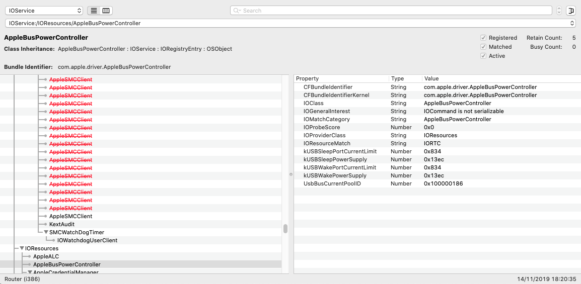

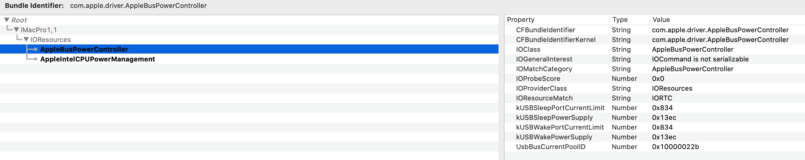

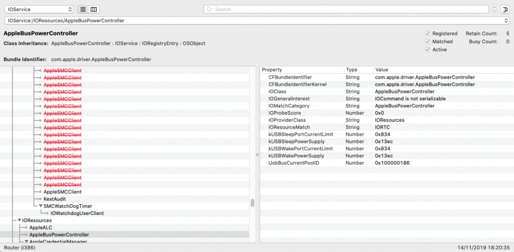

But from ioreg it seems that EC and USBX are loaded and AppleBusPowerController is loaded too, so I should be ok..Am I right?
EC:
USBX:
SSDT-EC-USBX.aml SSDT-EC-USBX.dsl

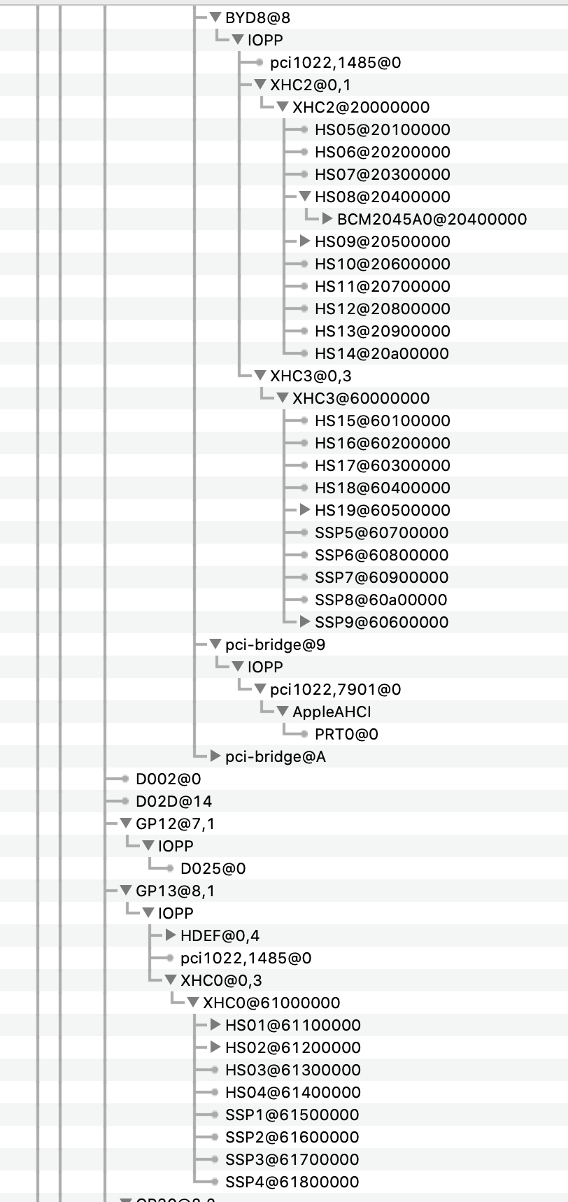

2 hours ago, ghost82 said:
so to create an SSDT patch to limit to the ports you are using
I don't like SSDT as in a vm the device path may change somehow.
It is safe to use USB Port Mapping kext like I post.
Yeah, if it loaded with some kUSBPower attributes then you don't need the kext.
The USBPower.kext only works in catalina for those have problem with usb power such as phone/iphone charging(you can find some usb power errors in your log), you don't need UIAC SSDT or USBX.kext(but it seems that your controller works OOB) .
And the USBPorts.kext is the mapping for my X570 onboard USB, you have to make it for your own.May be cosmic maybe not, I'm not quite sure now.

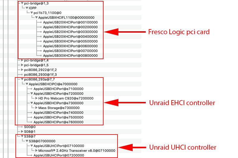

Hi all,
I'm trying to understand more about usb in mac os/unraid.
I know that in mac os (starting from 10.11?) there is a 15 ports limit: however, I cannot find anywhere if this 15-ports-limit refers to the total number of usb ports or to the total number of ports for each controller?
This is my setup:
1- EHCI controller in Unraid, used to passthrough single USB devices (USB 2.0) --> HD pro webcam c920 always attached, in the attached picture there's also a mass storage device attached
2- UHCI controller in Unraid, used to passthrough the usb dongle of my microsoft desktop wireless 800 for keyboard/mouse (USB 1.1): always attached (P.S.: I was thinking it was usb 2.0, apparently not...)
3- Fresco logic FL1100 controller (USB 3.0 and USB 2.0): in this case the whole controller is passed through
Total number of ports is 16, so if the 15-ports-limit is referred to total I'm not ok, if it's referred to total for each controller I'm ok..I think (and I hope) that the port limit is referred to each controller..
From all the videos I saw the problem was that not all the ports were listed under the XHC tree (on real hackintosh, not emulated), because of this limit, but since we have different bridges for different controllers it should not be a problem for us (qemu ehci controller has 6 ports, qemu uhci controller has 2 ports, so each controller is always below the limit).
By the way, in unraid the code:

On 10/25/2019 at 3:05 PM, Leoyzen said:
I'm on 19A602 with clover and the patch works for me.
Is the disable x86 cpu topology patch specific to AMD/Ryzen?

16 minutes ago, phyzical said:
i understand i need to rename EHC1->EH01 and EHC2->EH02
Hi, I don't think so, vm is different from a real hackintosh, and most probably if you look at your ioreg you will not see any EHC1 nor EHC2.
You should see usb ports into a bridge (for example, look at my image in my previous post for the Fresco logic controller, which is passed through).

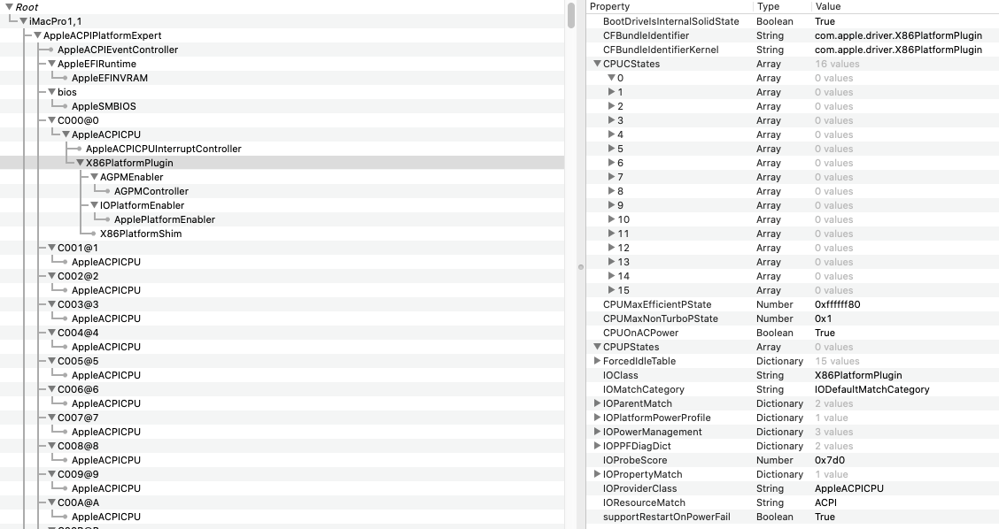

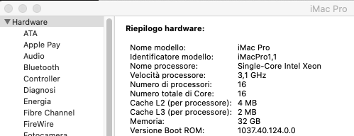

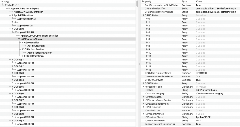

Finally, I switched from clover to opencore 0.5.2, as it seems it will be the bootloader of the future with more development.
I started from the qcow2 posted by @Leoyzen
I noticed faster boot and all is working quite good, and finally I'm able to load x86platformplugin (however, I have problems with loading p and c states, has anybody been able to properly inject c and p-states?) instead of acpi_smc_platformplugin.
Moreover I have also AGPM and AppleLPC, so for me it's better than clover.

Finally, by applying the patch in opencore mac os boots successfully and I can apply topology in the xml of the vm.
However, mac os system profiler shows 16 cores/16 processors..
Without the patch there's a kernel panic related to x86_validate_topology, so the patch works, but for some reasons this does not make any difference in mac os.
PS: shouldn't be not needed this patch in opencore after @Leoyzen commit to github? Latest compiled developer opencore is not able to boot without this kernel patch for me.
Edited by ghost82
The kernel patch is still needed in hackintosh VM.
The wrong process number is about the thing I mentioned before, we should use some other patches to make it work by digging the xnu source code but I don't have much time recently.

What about c and p-states?
I'm not sure it is working properly, rather I think there's something broken (actually I'm not sure if states can be controlled in the guest)..
In ioreg I don't have any value for c and p-states:
Also, from mac os terminal, command: sudo powermetrics
returns:
Core 0 C-state residency: 0.00% (C3: 0.00% C6: 0.00% C7: 0.00% )
Core 1 C-state residency: 0.00% (C3: 0.00% C6: 0.00% C7: 0.00% )
for all the cores.

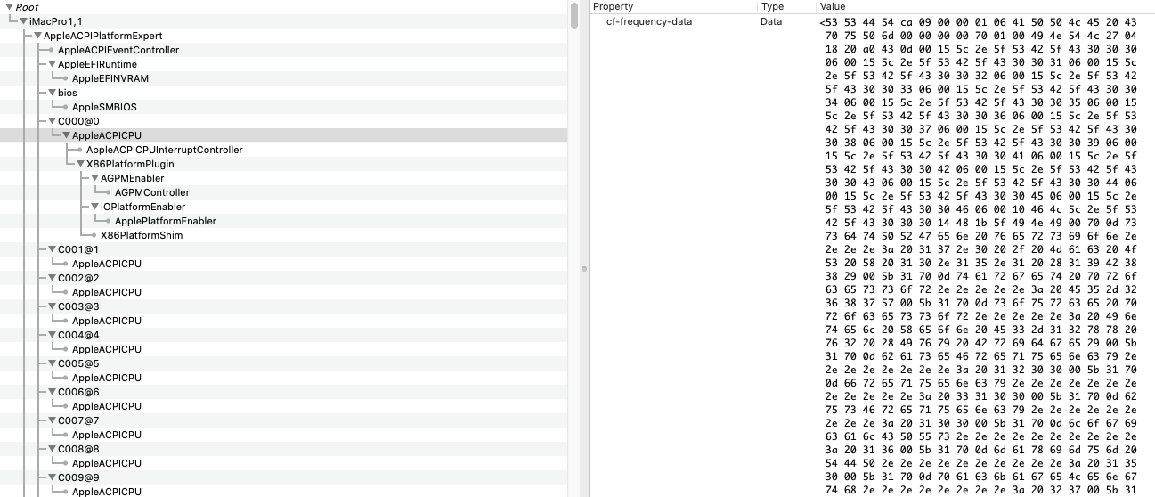

I'm using cpufriend kext + cpufrienddataprovider kext: cpufrienddataprovider kext was generated with ResourceConverter by feeding to it the ssdt generated with Pike's script (for cpu E5-2687W).
Emulated cpu is Ivy Bridge.
Data seem to be correctly injected:
What about your values?
